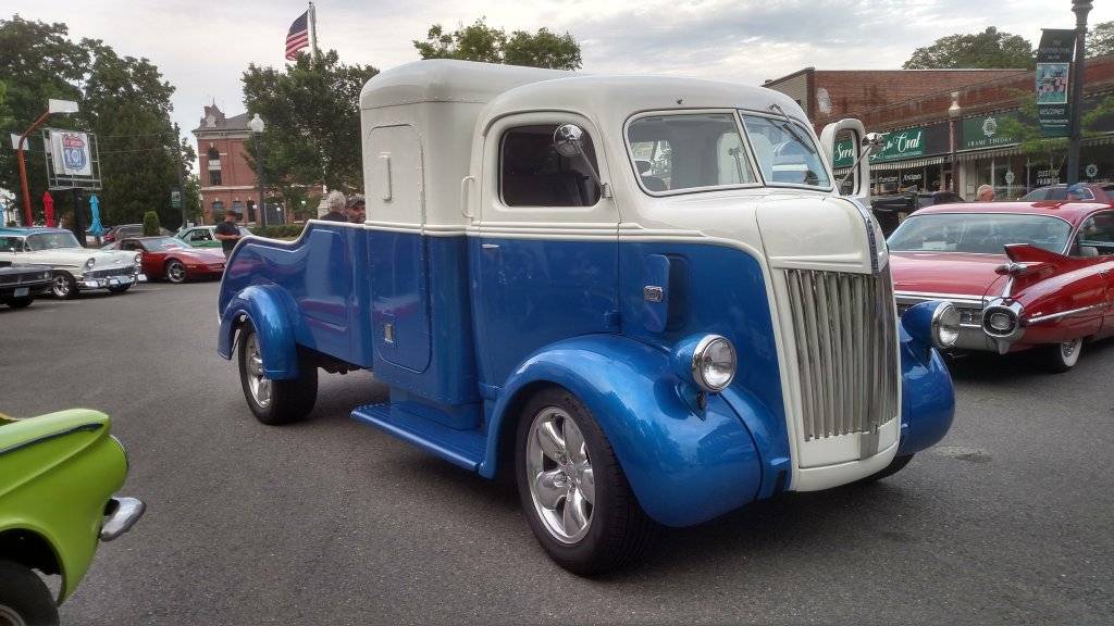

How about a picture of your 11 year build? I take it that's the blue/white truck?

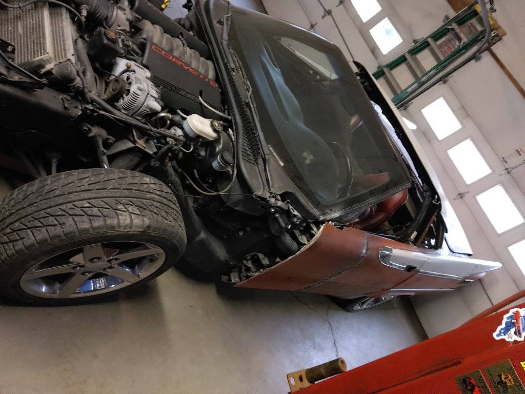

My plan is to disguise the Corvette interior. It's still a work in progress in my warped brain. I'm thinking chop the highback seats to mid height. reupholster seats, door panels, etc all in 50s-ish style. Try to integrate the Coronet dash somehow... Early stages of thought.... I REALLY like the dual antennas but I'm not completely convinced they'll look as nice on mine as they do on that "full bodied" car.
Under the hood, I'm planning a fake firewall to hide some of the modern. Battery already moved to the rear (you know, where I really need more weight :-) ). ECM and TAC moved from under hood to passenger's footwell.
Yup 11 year build is the blue/white truck, It's a 1941 Ford COE with a 1999 Corvette LS1 on a 2002 Dodge Ram 1500 chassis. see a trend here? :)
Under the hood, I'm planning a fake firewall to hide some of the modern. Battery already moved to the rear (you know, where I really need more weight :) ). ECM and TAC moved from under hood to passenger's footwell.
That's a badass truck, nice work.

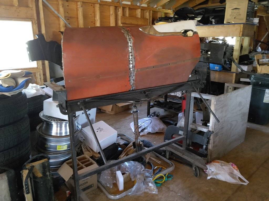

some driver's door progress. Marked for Corvette door structure, bent in brake then cut. Tacked together and by some miracle still fits the car.
slow progress... More welding on left door, little by little, trying for minimal warpage (and my welding skills suck). Right door mocked up for the first time.
It was a day of measuring... The dimensions for the Coronet skin, combined front/rear doors seem to be exactly the same side-to-side, but the fit onto the Corvette door structure doesn't match. I guess I'll measure the door structure next to see if Bowling Green built one door longer than the other... I'm off by about 1/4"
Mystery solved... The leading edge contours of the Coronet's front doors are different from one side of the car to the other. While the top and bottom width measurements are the same, laying the welded skin on top of the mocked up one shows the slightly different contours. Not a huge problem for me although one has to wonder how donor fender pieces will fit. Are the trailing edge contours of the fenders different from right to left also?
It's the other way around... The Coronet sheet metal isn't the same contour on the leading edge from Driver's side to Passenger's. Who knows, maybe a door was swapped on from some other car/model/year? Although under the door panels, all of them were black.
Oh ok, it may have been the builder too... I played with the right door skin some more and got it a little closer to the left door's dimensions. still not exact but close enough to feel good about putting the welder to it.
