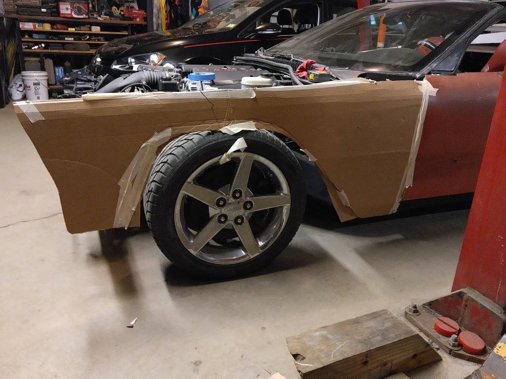

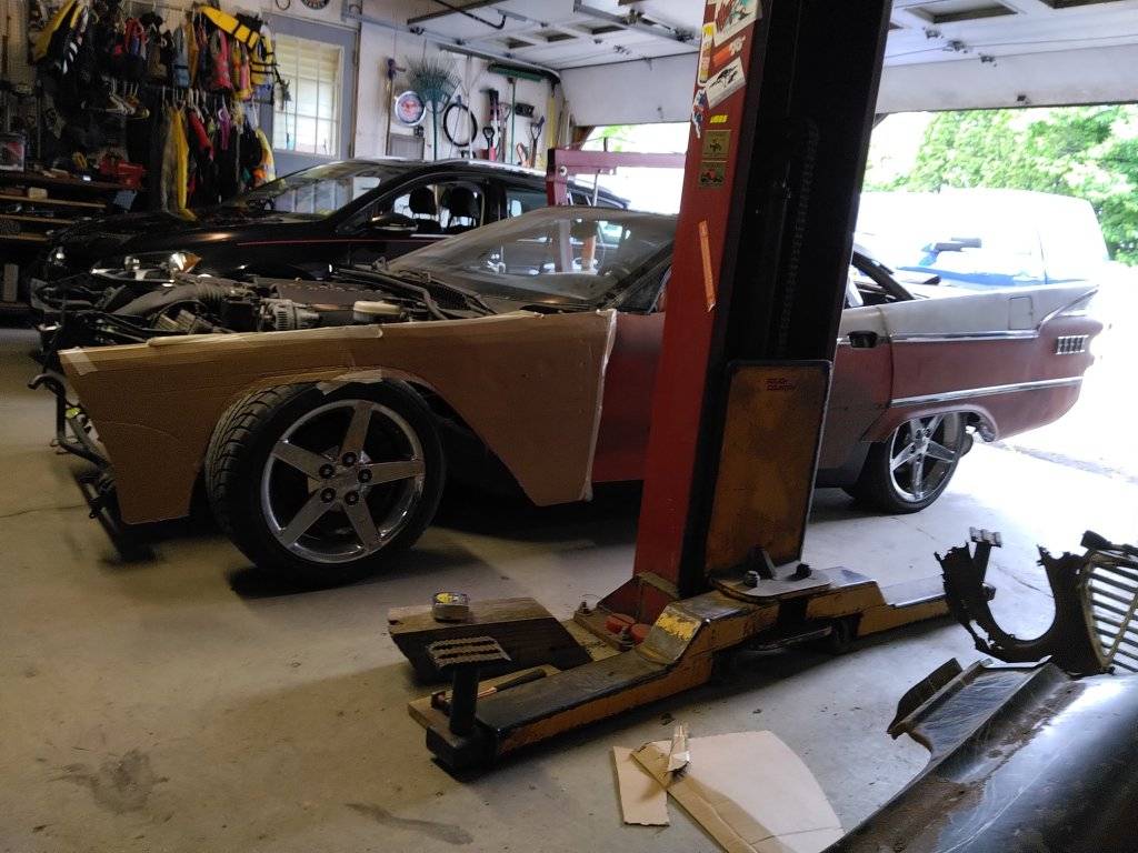

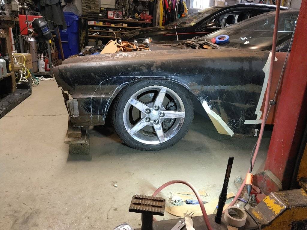

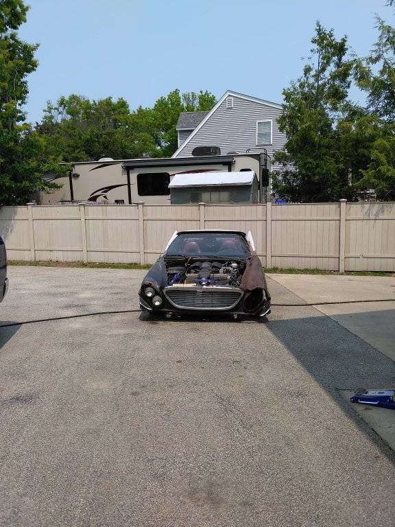

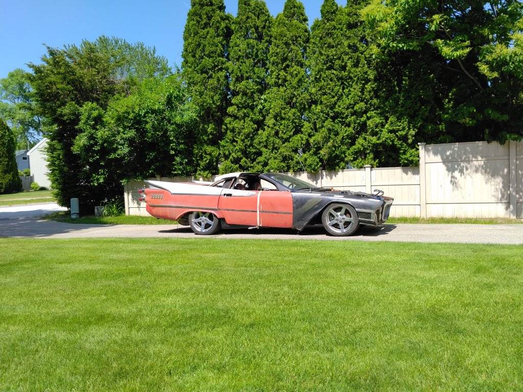

That is quite a bit. Looks like your going to need to cut out a four inch section. Easier said than done, particularly with the way the wheel arch flare flows into the front details.Looks like I need to raise the wheelwell opening about 4 inches. Not really any clue of the best way to do this....
Do you still have the Dodge fenders around? Might be able to figure something out using their arches with the Chrysler fenders.
