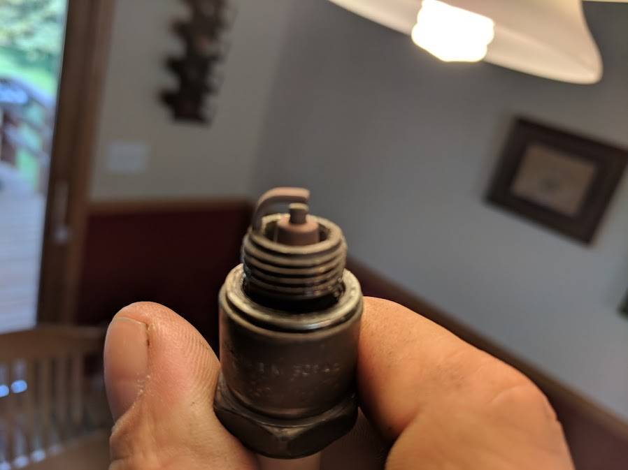

Here is my plugs running at 18 degrees.
ASC8lKK0TsVZ13SKcBcbQgdwbYN8IV0NAuXocazAenLq6Xu85-s0Mo4csCia_RZ1TN1otf9LwfvlFuFbCQe=w898-h673-no.jpg
well i run 14 degs in this hp 383 , 4 degs advance in the cam 470/270 comp . but went from hp manifolds to headers , it was way too lean . but yours is still choked off . like i was in the dart .
choked off? Stock exhaust maniforlds?
The stock log manifolds are not noted for their high flow characteristics. The HP manifolds were a lot better. Headers are better still when the flange gaskets don't blow out.
Dave
For what I have I like my stock manifolds, ceramic coated. Plenty of get up and go, just nervous about dentionation, not looking for a drag car, just something fun to surprise the hondas!!!!
Timing is one of those things that may have several solid approaches. You have a low compression engine with big chambers. So more ignition lead will always help. But - you need to limit the total amount of advance. You can't just run 50* total. So if you're going to run 21+. you will need to limit the centrifugal so that your total is maintained around 38* without the vacuum advance hooked up. And I'd then hook up the vacuum to ported source.
