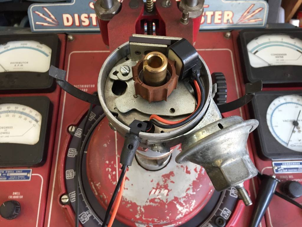

Could you not move the number one cylinder (and then others of course) plug wire to left or right? This should change the clocking of the distributor without needing to change the rad hose.
I really think you need to set it with more initial advance. You my end up with 16 deg initial and 18 inch vacuum. Then if you can get to a distributor machine you can do a recurve.
You don't even need a machine, you can get the recurve plates from How to limit mechanical advance in a mopar distributor, tuning for street, strip or all out racing, cure that rich stinky idle, win races
I use the plates when setting up distributors. Gotta order some more.
With todays gas a recurve is a must to make the engine more effecient
Find the initial that the engine likes, then send it off to @halifaxhops for a curve. Watch Tall Johnsfun shop for plenty of info on the whys and hows of timing setup.

Vacuum can is leaking a little I tried to order a new one but was sent one for a Chevy. Rock auto is the only one who lists one for the 383 they list 2 but one is not in stock and the other one is the one NAPA ordered which does not mount to my distributor and standard lists it as for a Chevy 350 . Will the can off of a 440 work? The only cans I can find for the 383 are for the Electronic distributors and the arms are wrong.
Moving my initial to 12 degrees boosted the vacuum to 15 . I am about to take the tach off of my Ranchero ( temporarily) so I can set total centrifugal timing to 36 degrees and total with vacuum to 40 to 45 degrees.

Thanks I appreciate it. I called Mancini racing and that one won't work on a single point distributer. it is for electronic ignition. Which is what I am finding every where. I may go with the Cardone distributer or a Summit racing distributor. Proform Parts 66993 Proform Electronic Distributors | Summit Racing , Summit Racing SUM-851014 Summit Racing™ Electronic Mopar Distributors | Summit Racing/ The cardone I can fit my Pertronix into it and use my flamethrower coil with the other two I can't use my flamethrower coil because its resistance is to low.
Thanks to the link for the FBO plate. I have been looking for it since hearing about it several places on you tube.
I wish I had a distributer machine. When i lived in CA. I used a friends machine.
