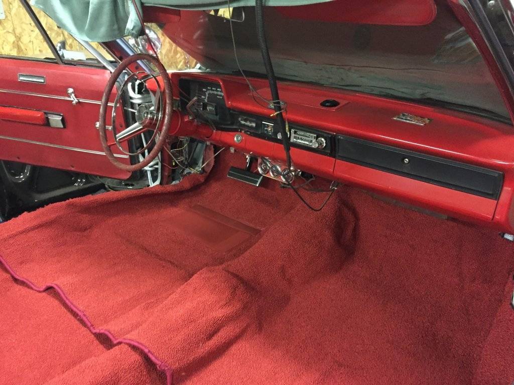

Been laying down the foil...
I'll be installing the carpet tonight.
Can't wait to get this car done and on the road again, it's been almost 2 years now
Got the foil taping done and now laid the carpet in for the time being and going to allow it to settle in a bit before doing any cutting.
I think i picked the right shape of red for this.
the previous carpet was a burgundy colour
View attachment 78126 Got the foil taping done and now laid the carpet in for the time being and going to allow it to settle in a bit before doing any cutting.
yes you did. looks great. where did you get the carpet? I will be looking real soon for carpet for my wagon.
I bought it from Legendary interiors but it is a Trim Parts product.
How much product did it take to do the floor and parts of the wheel well? I looked at the raamaudio site and they have a couple of packages. I my want to do my wife's vue
I bought 75 sq ft. at 80 mil thickness it was $145 if I recall correctly.
I have about 8 sq ft left over
great choice on the carpet. looks sweet!
