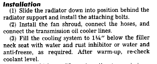

    That overflow bottle should be FINE! I use a 1 liter plastic bottle w a 1" lid, which I bored two holes in. One takes the 3/8" poly tube from the radiator overflow, with the other venting to the ground if its needed. Yours should work VERY well. One thing: Don't rely on your overflow bottle to fill the radiator with coolant. Fill the radiator directly, then allow it to "puke" into the overflow if it must. The FSM clearly instructs us to keep the coolant level WELL below the top of the tank anyhow. Look:
    So, do as they instruct and make sure you keep the coolant level at 1.25" below the bottom side of the filler neck. That gives your coolant room to breath in the upper tank, and COOL more efficiently. THIS is WHY you shouldn't rely on an overflow bottle to maintain the correct level in your radiator as a filling port. It WILL do its job once you have it properly filled though. Vaccum will draw the coolant back from the overflow bottle once the engine cools down to ambient temperature. Ethylene glycol is FAR more ELASTIC that pure water. That's to your benefit in several ways, except for mixing high-balls. Note how the FSM instructions I pasted in above tell you to check the coolant level again once the engine is up to temperature. THIS is when you want to set the coolant level: when the stuff is at ~190 F. Be SURE your cap is good for 16 PSI also. This prevents boiling.

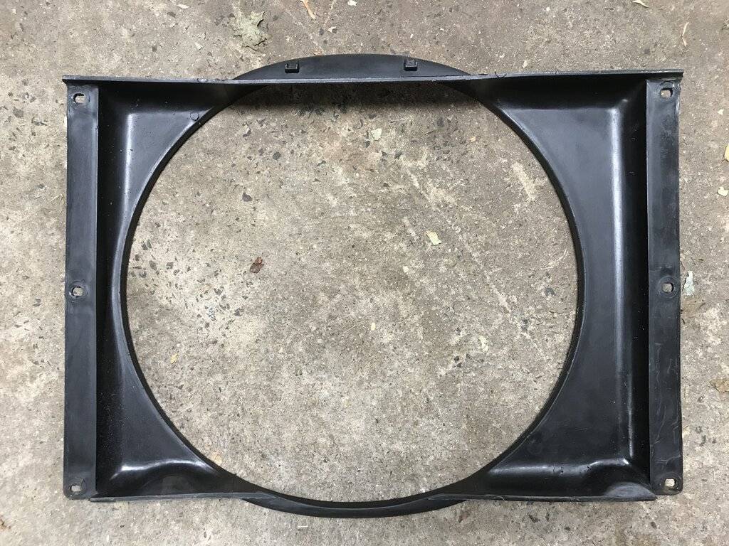

    that's why i suggested re-coring yours. 22" radiators are tough to find. the setup you have will work fine. just make sure your fan is centered in the shroud and you'll be good.

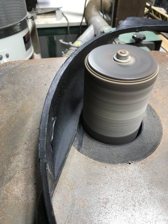

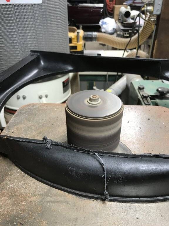

    The fan was a bit towards the bottom of the shroud so I remove the radiator (for the 43rd time) and put the shroud on my spindle sander to remove some of the bottom part of the plastic to prevent the fan blades from making contact with it. Now, it’s “perfect”!
