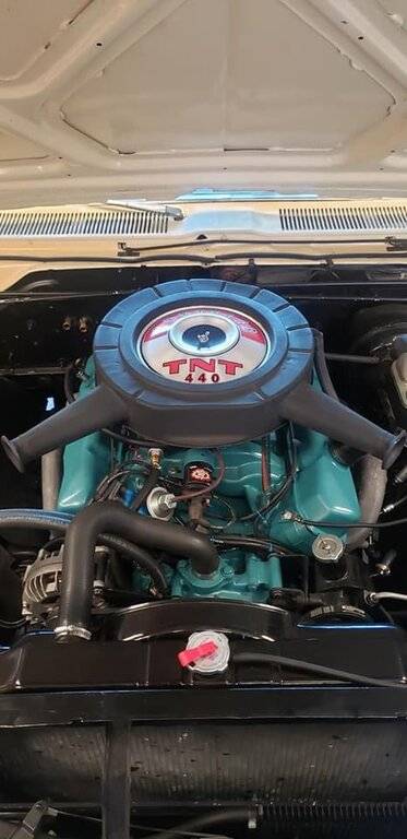

    I've been very pleased with my Cold Case MOP 753A as a replacement for the old 18x22" Mopar 2524984 Hi-ALT/AC rated radiator. There was NO shroud for the 2 barrel 383 equipped with a 6 blade rigid 18" fan in combination with that excellent radiator. I replaced it because it leaked in several places and the 110F ambient temperatures here require RELIABLE cooling! The original setup WAS good too! The first year I drove Mathilda through the summer with the original setup, using Bar-S Stop leak to good effect. THEN:
    I upgraded from the rigid fan to a DeRale 18" clutch fan after running a 7 blade 20 inch Mopar clutch fan with that old radiator. Both did well. using the Hayden 2747 thermal clutch, but the old radiator would SLOWLY leak. So, by the start of my THIRD summer, 2018, I bought the Cold Case MOP 753A. Despite being 2 inches SHORTER in height, it holds about half a gallon MORE coolant, due to the big 1 1/4" aluminum tubes. It bolted in to the radiator holder just fine, sans drilling, though I had to take a little care with the transmission cooling lines not being clipped by the 18" DeRale fan. I've corresponded with Cold Case about them making an 18"x22" radiator with the 1.5" inlet on the top right with the 1.75" outlet on the bottom left, as they've done for the 16x22" MOP 753A but thus far naught has availed, despite the fact that they make an 18"x22" core, but with the tanks set for 1.5" in/out, in the dead center top and bottom. That won't do for my '66 Newport, except in an emergency.
    I also put a 16" electric pusher fan in front of the radiator controlled by a toggle switch. This arrangement has assured Mathilda of running temperatures never exceeding 210 F on even the hottest summer days in Tucson (~115 F ambient, city rush hour traffic) I run a mixture of 3:1 water to ethylene glycol during the summer to prevent rust and raise the boiling point, though the 16 psi radiator cap is my FIRST line in boil prevention.
    ONLY this past Saturday, have I put a custom aluminum shroud on this radiator, to reduce reliance on the pusher fan a bit. The shroud incontrovertibly directs more air through the radiator when the engine is turning and the car is moving. I've seen now that engine temperature drops more quickly to the 190 F norm the 180 F thermostat imposes as soon as Mathilda is moving over 20 mph. What a shroud DOESN'T do is improve the cooling when idling in stalled mid-day traffic. THIS is what the PUSHER still has to deal with, and the A-1 fan I bought 3 summers ago still very efficiently cools the engine in those circumstances. HERE is where I'm a bit irate with Cold Case, for their refusal to make an 18x22" radiator for 66 C bodies. I HAVE a Mopar shroud MEANT for that size radiator which would bolt right on the 2524984, but is USELESS for the shorter radiator. This shroud was from a 1965 Imperial.
    Get the Cold Case replacement. They make a good drop-in replacement for your car, and even with my small issues, Cold Case has cooled Mathilda over THREE TORRID DESERT SUMMERS, with DAILY URBAN RUSH HOUR DRIVING, for about HALF the current cost of a re-core. The only thing that might serve you better would be an NOS radiator meant for heavy use, but I suspect such now is unobtainium. Be WARY also of other aluminum radiators, which are made of unreliable chineseum. Some of the "OEM" replacements from shopping mall auto suppliers also consist of this evil, treacherous substance.

    Very nice!!! What kind of prep and paint did you go with for the radiator?

    Super valuable post... TY for the in depth account!
