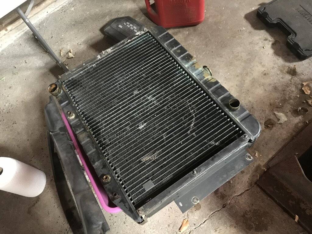

    Radiator is out. Love doing stuff myself and learning. Ccas seems to make legit points. Quite frankly I’d like to have the better performing radiator. Not sure why the Cold Case radiators wouldn’t be the smarter choice for performance? E62851B6-2B5C-4F62-A0D8-AD62774EA67D.jpeg
