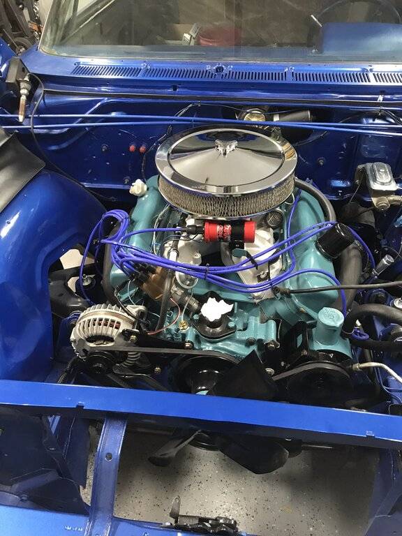

Could someone tell me why my engine dies when I put it in gear? I have a 65 Plymouth fury lll with a torque flight 727 the motor and trans. Are a 68 383 4 bl. Both are rebuilt and work fine the problem is even with the idle set up on it when I go from park to reverse it’s like letting the clutch out with the brake on ? If I keep it revved up enough and put it in gear I can go ok. Any advice is appreciated.

Speaking of vacuum leaks, I don't see a pcv hose if it's a new edelbrock, is the pcv port in the back of the carb plugged?
Obviously, the picture is just after installation in the vehicle. I see the breather/oil cap on the driver's side, but some sort of cover for the pass side pcv location. An updated "as installed and running" picture might be helpful?
Looks like a nice installation, from the picture.
