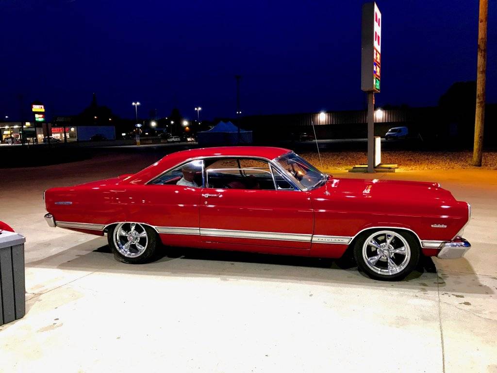

@herbdog, beautiful car, nice work! Did you use any type of glazing putty on top of the mud? Back in the day we used to use
something called Nitrostan to fill in deep scratches in the bondo, then prime and block. I think it was taken off the market, the fumes were very unhealthy.
Thanks for all the replies, I’ll be looking into Evercoat.
@live4theking, I actually use All Metal to work into the welds after my patch work. Does a good job of sealing any remaining pin holes.
No glaze putty. Used a high build primer. Fills in most hair line scratches and gives a little build for final blocking. The whole car was done in Omni brand from Arnold's. Little less expensive but lays nice and you can't tell quality difference from the more expensive brands and prep work makes the paint . Another brand I've used is Nason. I've had good luck with it too.
