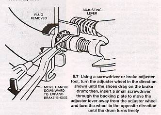

Hey, I looked through 6 pages of info in this section and I didn't find a question regarding this problem, so . . . I was trying to get my first drum off of my car a few days ago and I tried using a hammer and PB Blaster and I couldn't get them to move. I did notice that the drum didn't turn very freely. It would turn a little easy and then would be a little tight to turn around. I think I need to adjust the drums looser. Maybe the shoes are not letting the drum off? I found the slot where you make the adjustment. What tool do you all use and which direction do you turn it to loosen the shoes? Thanks.
It can be done with a standard screwdriver but I use a small flat bar that works best for me. I don't recall off the top of my head which way you turn it but if you have the factory service manual it will tell you what you need to know. You may find that you need to push the self adjusting lever out of the way in order to loosen the adjuster.
Reaching in from the top of the adjuster you want to pry downwards once you push the self adjuster away with a small screw driver or rod of some type..
Make sure you go the opposite direction of what the picture shows here :)
If the star wheel won't turn one way, then try the opposite. A good dose of PB blaster will help.
You may need to back the adjustment all the way off. If the shoes and drums are worn to a point where the mating surfaces have grooves and/or ridges it will be difficult to remove the drum otherwise. With the adjustment backed all the way off you can dislodge the star wheel from the shoes.

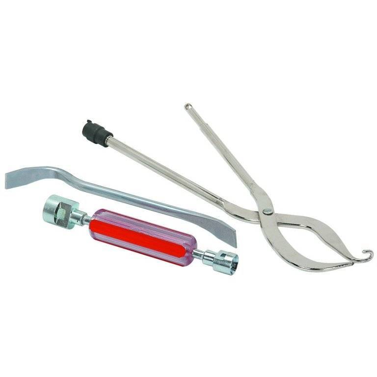

And clean and repack those bearings before you reassemble. Don't let this job intimidate you, it's really quite easy but does require some specialized drum brake tools that would be worth buying.
