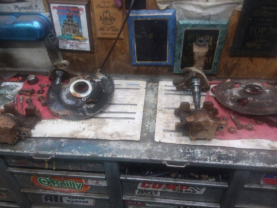

Ive just now checked Rock Auto and they only have the single-diaphragm booster which doesn’t fit for the early conversion. I’ve ordered a set of the rotors and we’ll soon see if they are correct. Also, just one source or so is not considered “commonly available” in my book. And it’s not even true for the tandem booster needed. I still find no source whatsoever. Please prove me wrong, as I need one for a customer!

I got the Rock rotors and they will fit ‘72. The hub OD is the same size as a ‘73 and up rotor.
