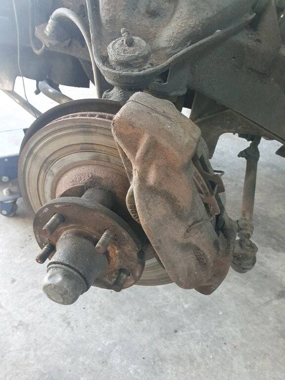

Hi guys,
I am chasing front rotors for my Budd disc brakes on my 68 New Yorker, i know they are hard to find.
I found them in an old search and that Summit Racing had them listed, it was mentioned on this forum some time ago.
This is there part #
TSB-23077AA1A
Are the ones listed at Summit correct, will they fit and work ??????
Any information appreciated.

Those are B-body.
$200 a pop.
1966-1969 Chrysler Imperial (C-body) Brake Rotor New for Budd 4 Piston Calipers | eBay
Keep in mind that Imperials that used Budd Discs used a different sized bolt pattern than C bodies with Budd Discs.
The eBay listing above is not clear on that, and you could make a very expensive mistake.
Craig (@mobileparts above) will know the difference and have the CORRECT parts.
Shouldn't, the rotor to Hub should all be 5x4.5. The hub itself should be 5x5 on the imperial.
The Imperial Club had one of the manufacturers do a run of these. Don't know if any are left.
EDIT DuraBrake is the company .
The rotor will fit either hub if you find one
One of their members came up with a way to use Toyota Supra rotors on the factory hubs after some machine work to compensate for the different hat heights.
He blathers a bit but all the pertinent info is there.
Mike Pittinaro's Supra Rotor Conversion for (Chrysler) Imperial Budd Brakes
Kevin
I tried to find the rotors recently as well with little luck.
Twostick is correct, DuraBrake does have the rotor available but you have to re-use your hub.
You can find nos rotors but you better be ready to lighten your wallet a bunch. My experience for a new nos budd rotor ranged from $300-$450 a piece range.
I called Raybestos and Wagner and a couple of other smaller companies and everyone I contacted the part number for the rotors was a discontinued part.
I believe AMS Obsolete Mopar parts have some and Mopar Mall. I included the link for Mopar mall. Link:NOS and reproduction parts for 1933-1976 Plymouth, Dodge, DeSoto, Chrysler, Dodge Truck s
Just be sure you are sitting down!
How much is the DuraBrake hat? That's the EZ Button solution.
The Supra rotor option is the cheapest going forward depending on whether you are or have access to a competent machinist.
Kevin
Kevin
I believe they are between $175-$200 for the disc only, I did not check the bolt pattern though.

Hi,
what are your used ones like, are they ok or need machining, will they take a machining and be in spec.
how much are you asking, i only need one really.
Any help greatly appreciated
Gavin
