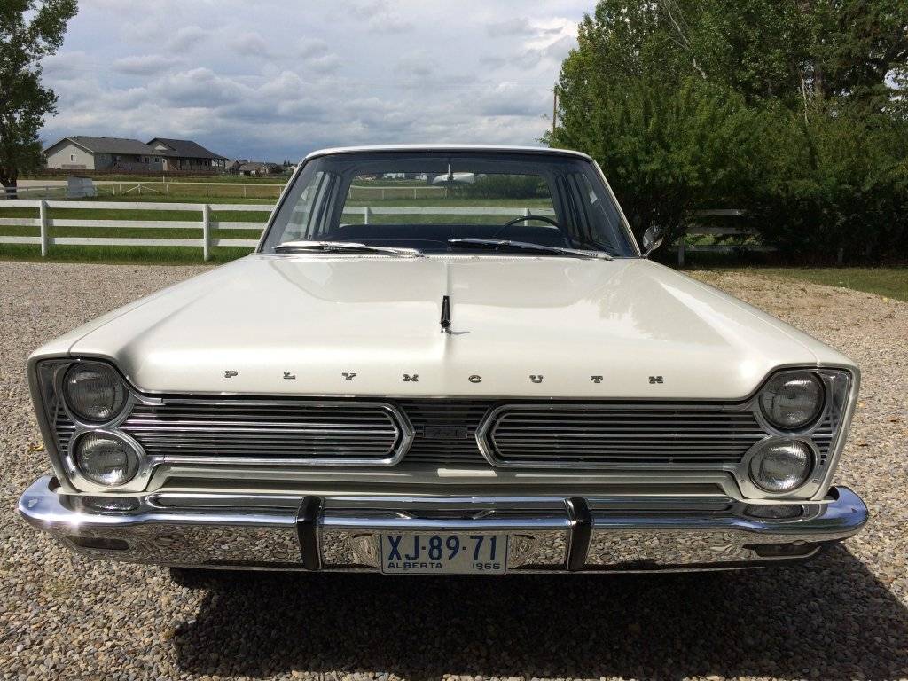

Hello. I may be buying a mid-'60's A or C body in the near future. One of the cars I have my eye on is a '66 Fury I. The problem with possibly buying it, is the right half of the grill has some slats that are damaged and one or two of them look like they were cut/torn in half. These grills are made out of tin? I know they are thin and lightweight. Who would you all recommend repairing/restoring it and bright-dipping it again? Who's the best in the industry? Are they reproduced? Thanks.
Those grills are made of Anodized aluminum and are hardened too. It can't really be welded unless you have the thing dipped to remove the anodizing then have it put in an oven to soften the metal again to weld it. Then it would have to go through the process of heating and anodizing to bring it back to originality. Better bet is to simply pick up another grille, The 66 grilles are not hard to find and are far less expensive than repairing the one in the car.

The '66 grill is very easy to find. Don't bother repairing it. There were two NOS on eBay a while ago.
