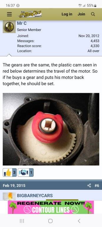

Good day all and greetings from Sweden. My headlightmotor chewed up all the plastic gears in the motor. Flipped it around and was almost across the finishline when the little plastic cam that rotates between the open and closed switches snapped. I've spent a good four days on the web hunting for a reproduction part. This forum had links and links but all are dead today. Could I ask you guys for guidance in finding this little bastard of a part. Summer is here and the car is stuck in a shed because of a plastic piece the size of a dime. Soon frustrating. Here is a picture of the part.
This is a screenshot of how it looks in the engine, and this was found here on the forum but the link dead.

this piece would be a prime candidate for 3-D printing. You’re lucky enough to have a good original to copy from .

All that part really does is trip the switches. Not a highly stressed item.
I'd superglue it back together using a good superglue and see what happens. Emphasis on good superglue.
I saw an interesting YouTube video on Loctite 4070 the other day. Bonds pretty much anything, basically, sandable, paintable, etc. Just needs the applicator to push the two tubes.
As to "superglue", seek out the gel version rather than the non-gel version. Might work better. Might wear gloves, too. There are some plastics which superglue will not adhere to, unfortunately. Hope this is not one of them!
