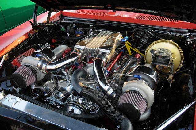

7377462644_d97bf827e2_z.jpg No intercooler on this Gale Banks SBC running 12psi boost and known good for 611bhp. Pretty hard to argue with a tried-and-true combo like this. My build will have a similar cam, higher compression, less boost, and water injection.
Heat builds with long pulls under boost. Good news is you can add one later if you need it without opening anything up just plumbing reroute. If you have the pistons use them.
