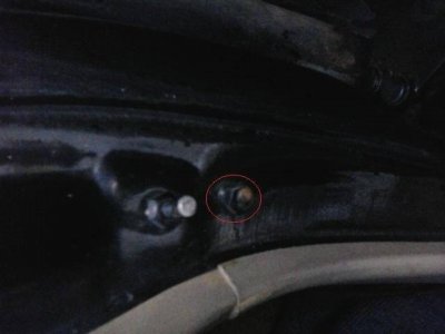

Sorry for revive this thread but I've a doubt about the holes that must be done to the body to install the power windows. I was cleaning the car and I notice that the car has holes in the center pillar and in the fron doors this nut appear to be hiding other hole.
Maybe the last owner tried to install the power windows?
