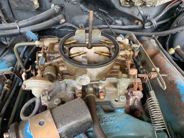

    Trying to ID this carburetor on my 400.
    Thanks,

    1965 thru 1967 factory Chrysler Carter AFB
    Intake manifold is a 1968-69 383
    Turn the screws in for lean, it will start to stumble, going further should make it quit running.

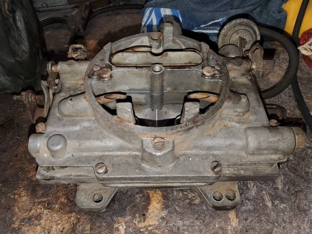

    1964 A little different a 3636s i believe

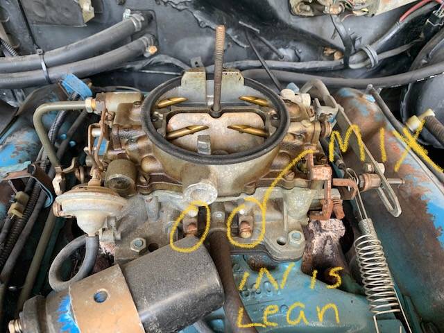

    Sucker is running WAY too rich and I am not familiar with this model. I think the mixture screws are down on each side of the front hose. Can someone verify my guess? Turn them in to lean out?
    OR can someone recommend a good solid reliable and cheap replacement? Don't need big power just good smooth-running motor.

    I just rebuilt mine using parts from Mike's Carburetor. Usually you turn the mixture screws all the way in (don't overtighten), and then back out 1 1/2 turn as a basis to begin adjustment. My motor hadn't run in 30 years, and it started right up without adjustment.

    Look at, and post the numbers stamped in the front base of the carburetor.
    That will tell you.
    Remove the coil if you have to read the numbers.

    In the carb base are:
    41306
    06

    4130 is a 66’ 383/426 M/T

    Thanks for the identification! So, based on that- I'll try and adjust the two mixture screws to lean it out a bit. Are these good/reliable carbs? Never had one before.
