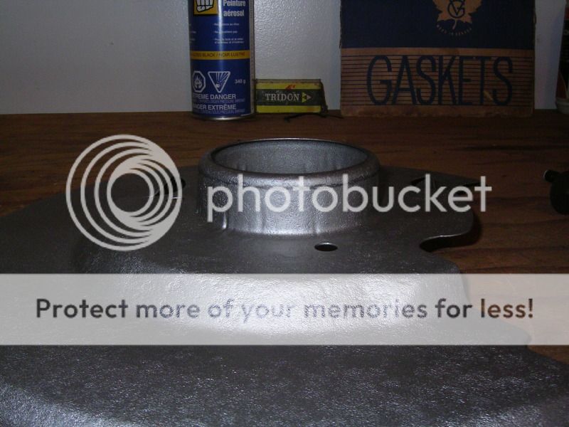

Yes they are. But you can easily make a set from a 69-72 disc brake C-body work. I did this on my 73 swap. I had a 71 300 I parted out and used the dust shields from it. The dust shields themsleves are identical, it the opening for the casting around the inner bearing that is different. The 69-72 disc brakes use a smaller inner bearing, and therefore the actual casting on the inside of the rotor is smaller. SO the 73 disc brake inner casting will not slip down all the way. So you just need to remove a little bit of the material from the "hat"? and you good to go.
Measure down about 1/4 inch I think...maybe a bit more. Can't remember now.
Then cut it off and your done. Think I had to just tweak them a little more once I installed the new rotors...but just a quick zip with a grinder to clear the inner par tof the rotor.
