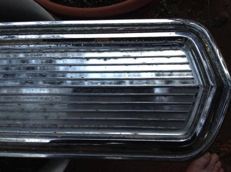

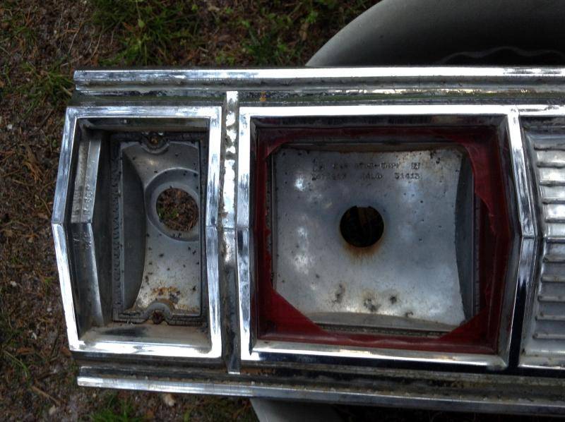

Can these be fixed by having them powdered coated? I don't think they can be restored by having them chrome plated. There are a ton of pits. What do you guys think?
You can have the chrome stripped off of them and work them back to smooth and rechrome.
I'm sure it would cost a ton of cash to have them restored.

I would imagine having the stripped would be 30 - 50 then your time in working them smooth and clean. Probably somewhere between $100-$150 to have them chromed I would imagine.
They can be restored ....... cost, likely around $700.00 each at a pro chrome shop. Nice used or NOS would be the best choice. Powder coat will not fill pits in chrome.

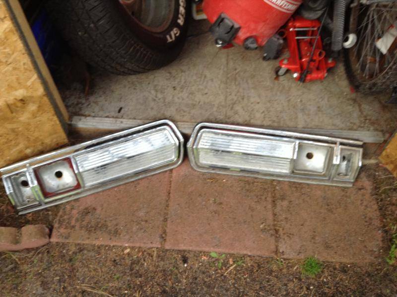

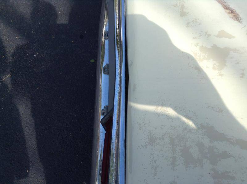

I'm sorry, no my car was hit a few days ago in the passengers side rear. Not bad, but bad enough to where I need new housings now. The housing seen above are extra that I had laying around.

the housings you pictured could probably be cleaned up well enough to use as is until you find better. But to restore and rechrome would be ....... a lot....!

Thanks, I'm going to try to straighten the one out that took the hit. It's not dented, but pushed in about 1" toward the center.
I hear ya! These are another set I had. They are the originals. I went with the smooth ones, but the passengers side housing took the hit...so I back to square one now.
