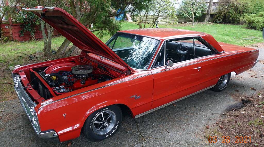

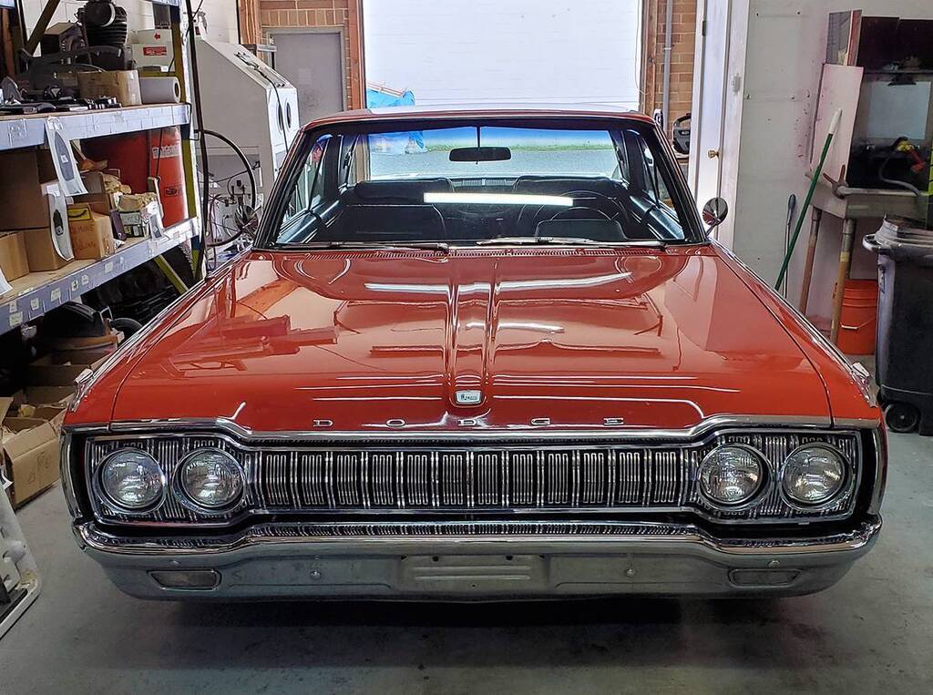

This car is well loved
I have replaced all brake shoes brake cylinders turned drums.
Replaced all lug studs and lug nuts (never take your car to someone that does know the difference from 65 lbs to 110 lbs)
Six lug studs snapped off.
New shocks all around.

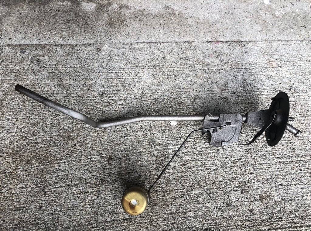

Welcome! I have used the Spectra tank on two fusies but don't know if they work on slabs. @LocuMob and other owners might be able to answer the question.
Hmm someone is missing a sock and float has a liquid in it don’t think that’s good.

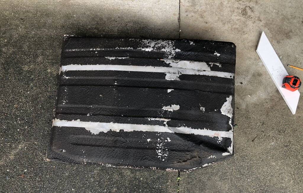

This is the tank measurements
Local dealer has the Specra CR20B in stock said I could return if doesn’t fit for full refund.
Getting it tomorrow
Update
Doesn’t fit right returning getting one from Vans
Little Pete is correct spectra Cr20b
DOESN'T FIT PROPERLY 1/2” from shocks
Like a size 10 foot in a size 9 1/2 shoe

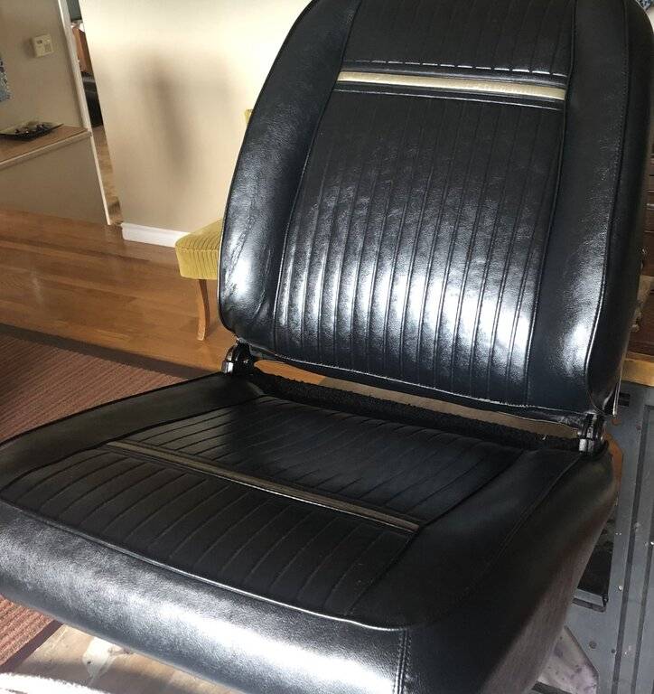

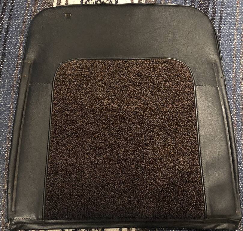

When I took my seat apart I was able to see that the original colour is black. I want to keep as much of the car original so didn’t want to replace carpet just because it’s faded so…. painted with Dupli-Color vinyl and fabric paint.
Next is to bring the old vinyl back to life…..baby oil??
Applied baby oil and wrapped in plastic over night.
To cold to do in garage, wife was out so… into the livingroom.
She was not impressed.
Wiped down, not greasy but a decent shine and ( this may not have made it softer but in my mind ) it’s softer and darker
