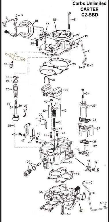

    Carter BBD pictured, not Edelbrock.

    Carb in the photo is a Carter BBD, as noted, also for a '74 and later vehicle.

    It should still work, might be set leaner due to more modern emission standards. Exploded view for your reference is attached.
