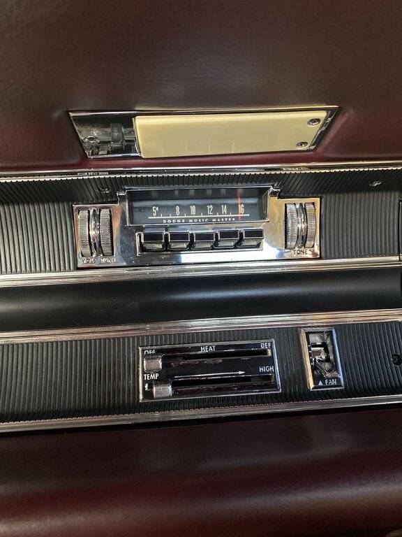

Has anyone did any kind of upgrades! I want to leave the stock one in place but hook up a a new one with speaker and amps. Maybe put the new head unit in glove box or in my console so I don’t touch the stock dash!
Am/FM. Bluetooth, USB, hands free calling.
Can also get pre-amp outputs. No need for another head unit.
Aurora Radio Conversions. I had mine done by Gary Tayman (Florida).
I would believe he would also make it work with the 8 track. An option.
Yeah for the work it’s like 400$ just for the radio! That’s crazy

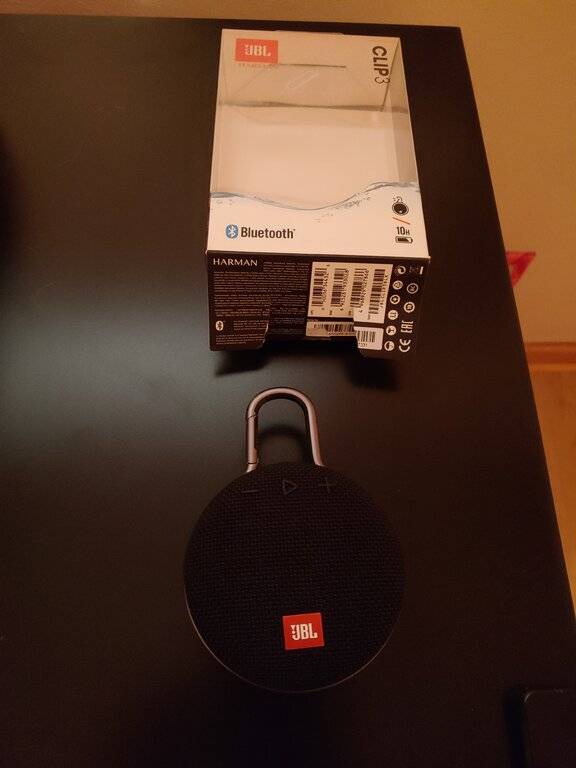

I went the cheapest and easiest route for my wagon.I bought a JBL Bluetooth speaker that hangs from the rearview mirror that connects to my phone that I connect to my SirrusXm app on my phone and listen to that.The cost was $50.00.Here are pictures of it and the packaging. The sound is perfect as it's at ear level and can be adjusted either on the speaker itself or by adjusting the media volume on my phone.

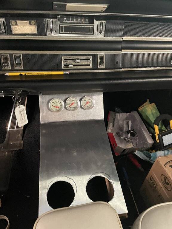

And related pretty sure I/we (69 fury) can fit these Infinity Kappa 4x6 plates in the 4X10 dash slot. Face the tweets at each other using a custom adapter. I have a parts 69 dash and the opening is bigger than 4x10 and a custom adapter would allow most of the woofers to show. Then in the corners a set of shallow wide range tweets like these. These tweets go down to 400 hz so you get highs and midrange. Hoping to get some stereo effect back. All 4 powered by a similar amp to what I suggested earlier. Then another, maybe same amp, to power shallow midrange in the kicks (I already have holes - I did not do it!) and 6x9 in the rear armrest. Again the PO put holes in those valuable things. And then sub. Maybe 2 10s behind seat, or shallow under seat. Not sure if its shallow enough. As soon as I figure it out I find a new brand or idea. But its all fun. I figure since I look at this stuff I might as well pass it on.
