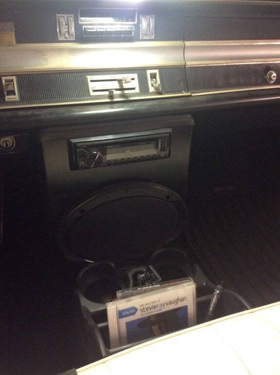

I built a center console similar to your first picture. Put a cheap *** "Best Buy" stereo head in it, put medium cheap *** 6x9 speaker with the second one mounted in the rear seat ( mines a convert) and then my buddys 18 year old son took over and put a big *** woofer speaker and and amplifier in the trunk- now I can hear Waylon and Willie with the top down on the road to the beer store. Thats my story and stickin with it- RJ
I built a center console similar to your first picture. Put a cheap *** "Best Buy" stereo head in it, put medium cheap *** 6x9 speaker with the second one mounted in the rear seat ( mines a convert) and then my buddys 18 year old son took over and put a big *** woofer speaker and and amplifier in the trunk- now I can hear Waylon and Willie with the top down on the road to the beer store. Thats my story and stickin with it- RJView attachment 462062
In the vert where did you put the speakers in the back?

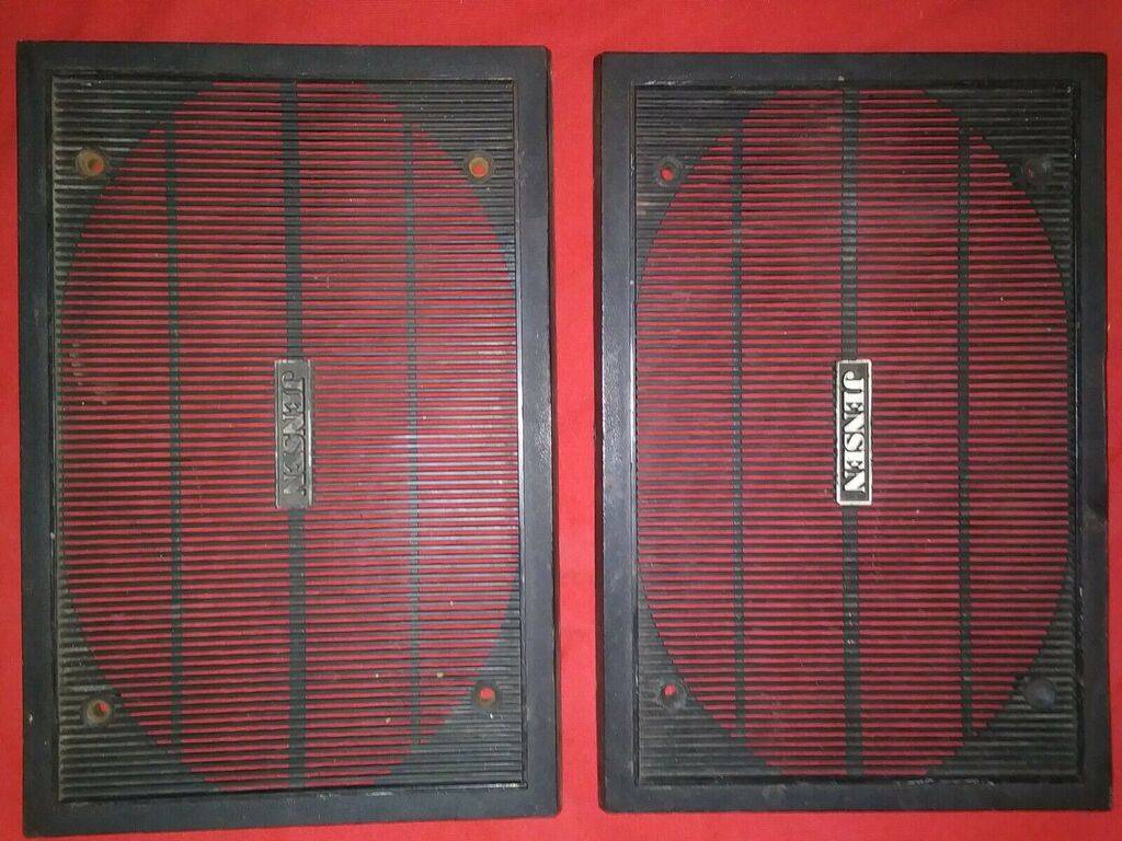

When I put in my 6/9's I would love to find two vintage Jensen speaker grills. Back in the day Jensen 6/9 coaxials were the ones I ran.

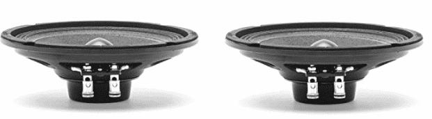

For the kick panels I was really hoping one of these neodymium magnet midranges would fit. There are multiple clones of these. The small magnets might just fit into the holes depending on model. Of course there is very little bass so subs required. Also I could just cut the pedal pad off and relocate it offset. Some people cut off the entire ebrake pedal and reweld offset maybe 1-2".
