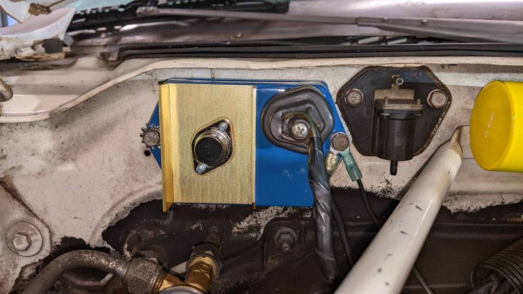

Parked it and it wouldn’t start after that, checked the wiring with test lights everything seems good. Porcelain parts are working and not cracked. New starter solenoid, new ignition box, fixed the distributor, new starter coil, new battery, more grounds. Now the negative terminal isn’t grounded, the ignition box doesn’t seem grounded for some reason, and the positive terminal is grounded? I’m so lost somehow fixing this car only seemed to make it worse? Any ideas
Also somehow it wanted to start when tapping the ignition box with the end of a screwdriver to help ground it out

Yes I was told it’s an ignition box it’s mounted to the firewall grounded to the firewall and the battery
It is points and we are gonna convert it to electronic but why on earth would parts that should be grounded out not grounding even when we grounded them out manually
This is a starter relay. Does the "ignition box" look the same?
It is common for the Neutral safety switch wire to have a defect that causes the relay to lose ground.
So what I’m referring to is the box on the fender wall usually that has either a 4 or 5 pronged cable going to it
That sounds like electronic ignition, which would be useless if the car still has point ignition. Point ignition does not send a signal to an ECU.
This is an Electronic Control Unit for electronic ignition. Does the ignition box look like this?
Yes, so unless car was redone as electronic, or has magical powers, I have no clue how it drove home

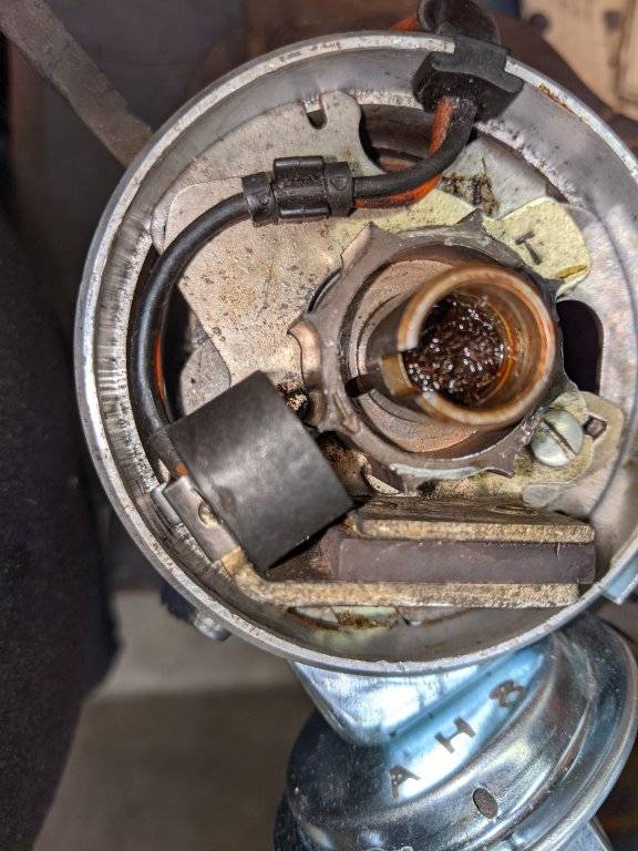

Questions. Which is under your distributor cap?
If the distributor has points like the ones below under the distributor cap, the ECU or "ignition box" is worthless
Point ignition picture
Or if it has magnetic pickup (black cylinder) and reluctor (metal gear with arrow) under distributor cap, you have electronic ignition
I suspect you have electronic ignition and you are not getting spark.

If it was points and condensers how would it have driven home from the mechanics shop? Like wouldn’t have it just not started at all? If I’m wrong do tell because I’ll look the second I’m home
You said you fixed the distributor. What did you do to it? The positive terminal is grounded? I would look at a schematic for electronic ignition and make sure everything is hooked up properly.

So inside of the distributor was held down with one screw causing it to rattle around, we got 2 more screws to hold it down in place, because we thought that was why it wasn’t drivinf
