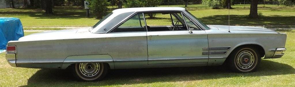

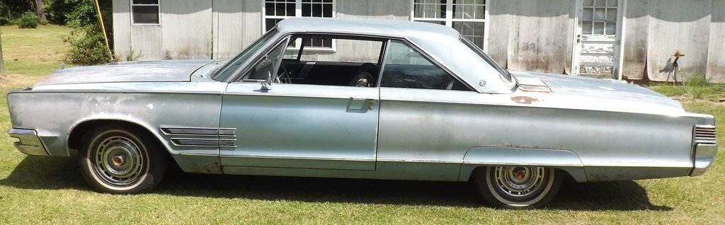

It's alive! And the gas gauge works! Man that's dirty, where's my garden hose?
I'm not going to be able to sleep tonite nowIt's alive! And the gas gauge works! Man that's dirty, where's my garden hose?

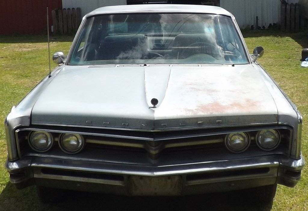

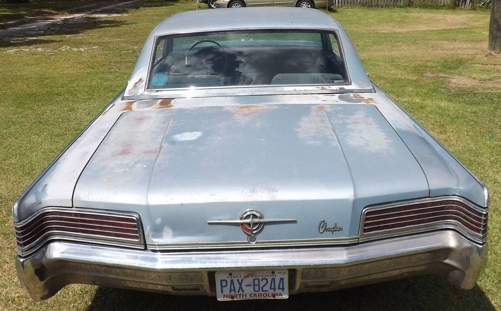

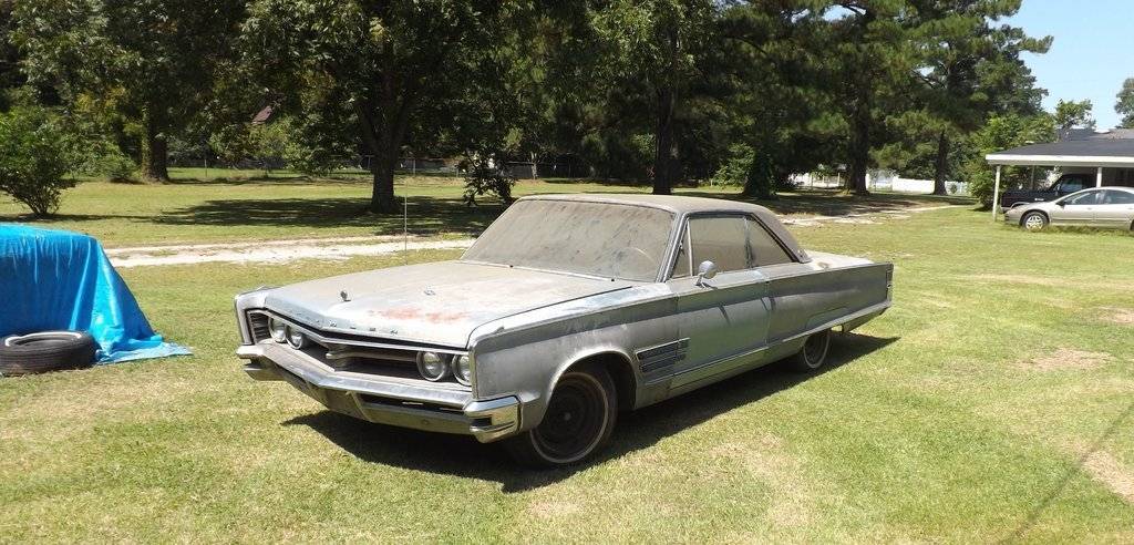

Nah, check these pics out, ;) Yes I washed it too!I'm not going to be able to sleep tonite now
It was touch and go as to whether I would put the hose in or not.Very nice even threw the optional wheel covers on too. What a professional shoot not a hose to be found.![]()
Yeah!?! Where the hell is the hose?
It's not for sale on Craig's list, why should there be a hose???Yeah!?! Where the hell is the hose?
Yes it has a new sender unit in it and I bent the arm a bit to get it to start reading with three gallons in the car, then we put another gallon in it and it read just above empty. I think that's pretty close to where you want it. So yes, bending the float arm to get the gauge to read right is necessary.What did you do to the gas gauge? Replace the sender? Did you have to tweak the float arm to get to read correct? I put one in a customers GTX and it doesn't read like it should, the gauge sweeps with ground and sweeps when connected to the sender and I move the arm but when installed and he filled it he says it doesn't read right. I wondered what you ran into on the 300.

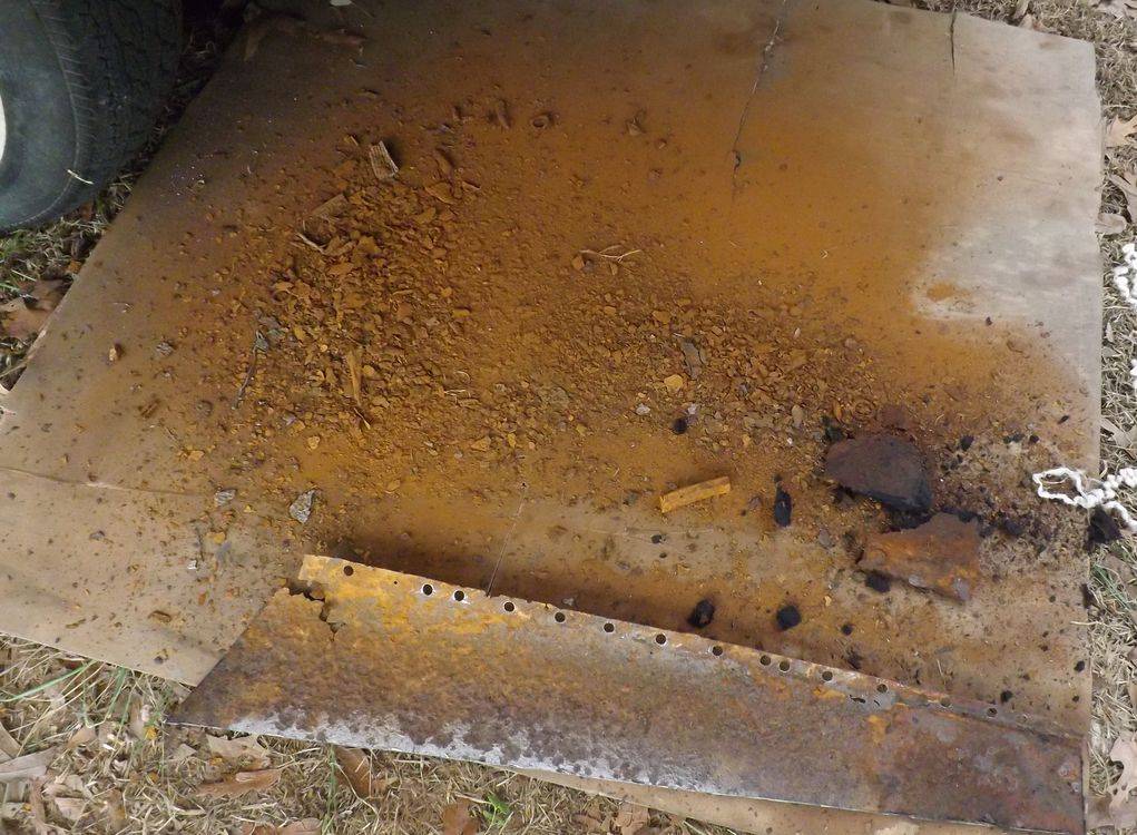

I don't think so. Gary should chime ingoin to town on this one , glad you guys faired well in the big weather there . hey have you guys used dr.x rust remover yet ? could save hours of grind n blasting .
Haven't heard of this stuff, I will check it out.goin to town on this one , glad you guys faired well in the big weather there . hey have you guys used dr.x rust remover yet ? could save hours of grind n blasting .
Is this the stuff your talking about?hey have you guys used dr.x rust remover yet ? could save hours of grind n blasting .
I just checked out the video, very interesting stuff!goin to town on this one , glad you guys faired well in the big weather there . hey have you guys used dr.x rust remover yet ? could save hours of grind n blasting .
