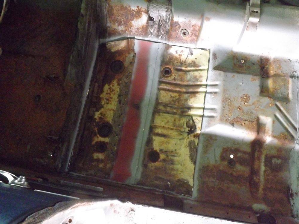

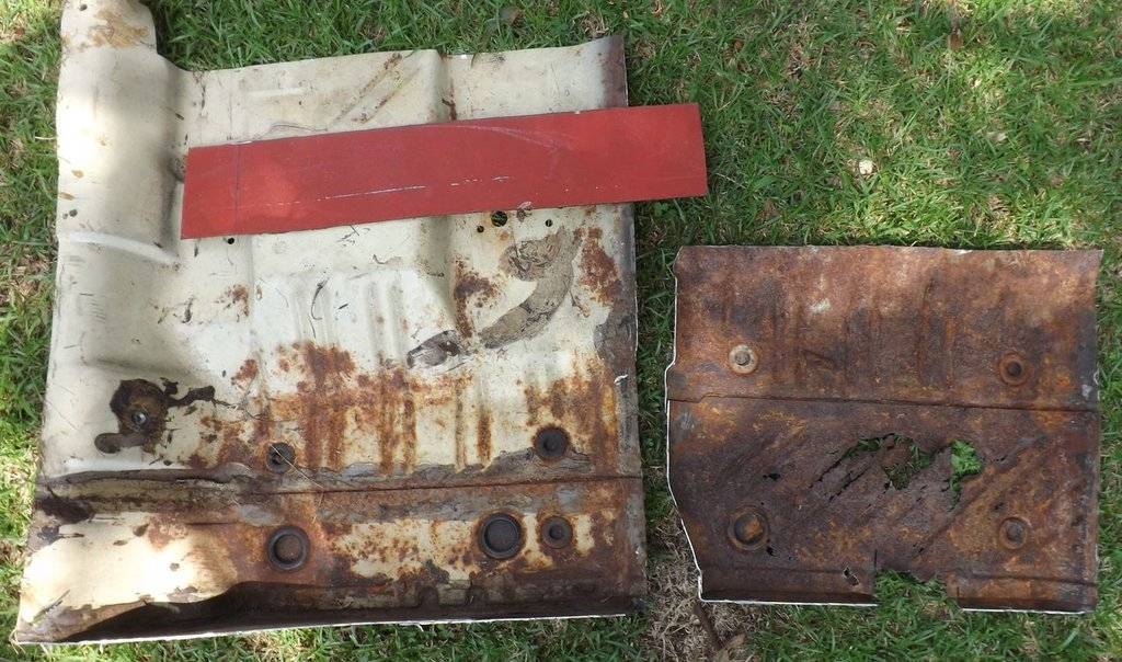

So after running around and picking up some supplies I got stuck into the floor of the car today, I cut the passenger rear footwell out and lay it beside the replacement unit, you will see that they are two different sizes going by the seam line. To make it all match up I cut a spacer, the red piece you see, which will be formed to fit the new floor pan once I trim it and drill out the spot welds on the seam. Stay tuned for more pics tomorrow.
I got lost.
The rusty pc is from the 66 Chrysler 2 dr.
And the white pc is from a...?

Since I had a parts with good floors we decided to use it instead. The C2C pan is not rolled correctly. I got a car comming up that it likely will be used on

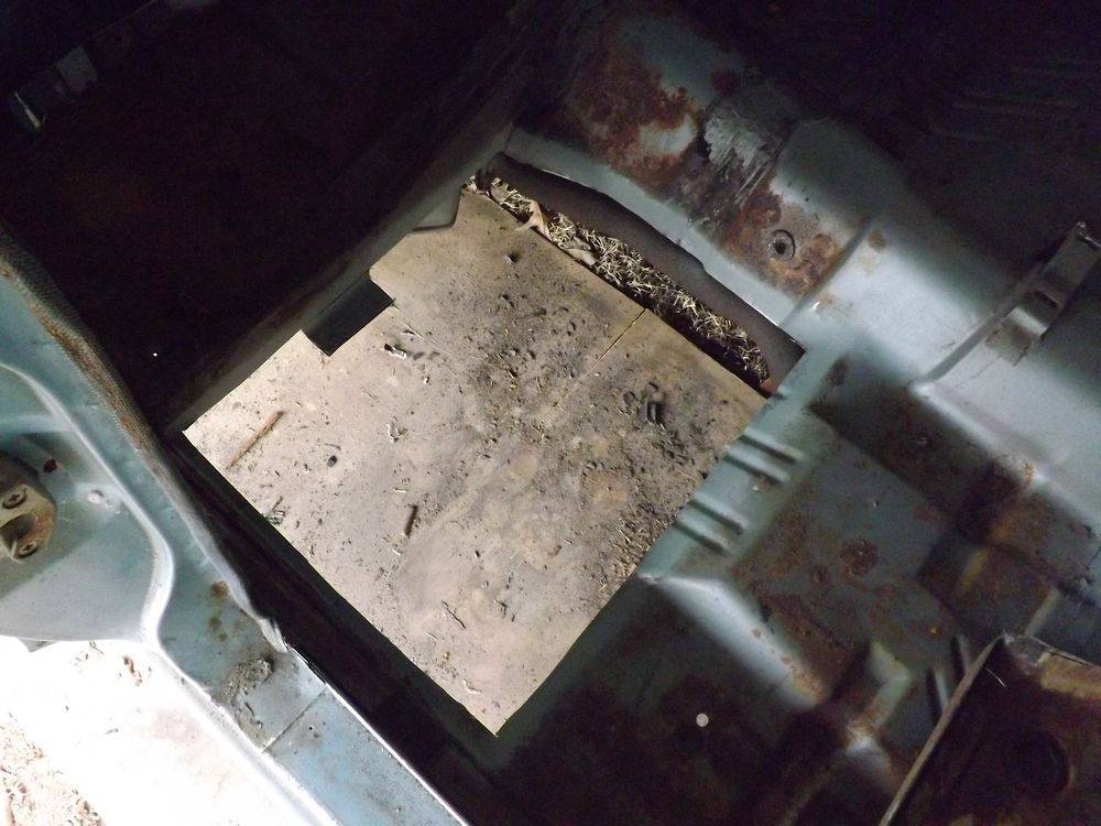

Latest pics of work done today, check the fit of that new custom modified floor pan, not bad even if i do say so myself. Tomorrow I will be welding it in.
