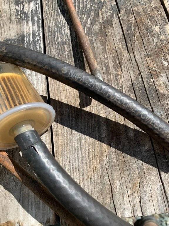

I added new rubber fuel lines when install a new Edelbrock about six months ago. I keep hose on hand, and had some NAPA fuel line from years back. So, used it. I just ordered a new adapter for the carb, so removed that fuel line. It had totally cracked around the flare on the plastic filter....was not leaking, but you can see cord or something in the severe cracks. Check your rubber lines on occasion. I cant believe this. I also removed very old fuel line on the metal line that exits the stub frame. Had to loosen the clamp and pull the line back to get at the clamps, but even this old stuff was intact.....more than i can say for my newer stuff. I had ordered some marine line that is larger and difficult to deal with.....but, used this today. I was trying to download a picture from the phone, but no go so far.

recently saw this on a chevy pickup that i tried to get running at a friends shop...pulled the hose off the carb, cranked it, saw we had fuel...cut the hose back to a fresh piece, reinstalled it...it leaked...repeat 2x, remove fitting, etc...turns out the inside of the hose was severely cracked longitudinally and once i cut it back it leaked down the cracks...the outside of the hose looked very new so i never suspected it would be bad internally...Gates makes a barricade fuel hose (greensheild?) in both carb and injection pressure ratings that withstands ethanol...both OReilly and NAPA have it...so glad i had this issue otherwise i would have replumbed my car with the roll of normal crap i had sitting around
I bought Gates fuel hose. 1 years later I was backing out of the garage and the wife said "Your car is leaking".
Leaking at the filter to carb union. All others were cracking. I too have switched to fuel injection hose.
Got my pic downloaded, and ordered some Gates barricade.....thanks

Maybe so....I normally tighten until I cannot turn the rubber. And, this line split over the tube flare section....which normally flexes.....this old stuff did not. Yes, old hose, but not happy....this is a first for me in about 60 years of work on the beasties. My first was pulling the engine on my first car at the age of 15.....and I have been after it ever since. Does not mean I do it right.....kinda like 60 years of trying to figure things out. Just wanted to raise awareness to check rubber along the way.....since, as we see, it ain't always as good as we think.

Agree. This failed section was from my carb down to the filter, about 8 inches. Edelbrock makes a steel line from the carb, but it runs too low on the manifold for me, and the carb fitting is a straight 5/8 thread....not easy to adapt. So, rubber from carb to filter, rubber from engine to new CuNi line thru the stub frame, a short section to the OEM steel line along the frame, and of course a small bit at the tank. I do plan to use a compression fitting from my new stub frame line to a new CuNi line along the frame to tank. But, I want to do this on a lift where I can wangle and wrestle the long line into place. Good thoughts, thanks.

I ordered a few feet of both 5/16 and 3/8 gates barricade and the smaller just arrived. I like the small size, not larger than std as is the marine hose I got before. Will now go to this gates hose in future.
