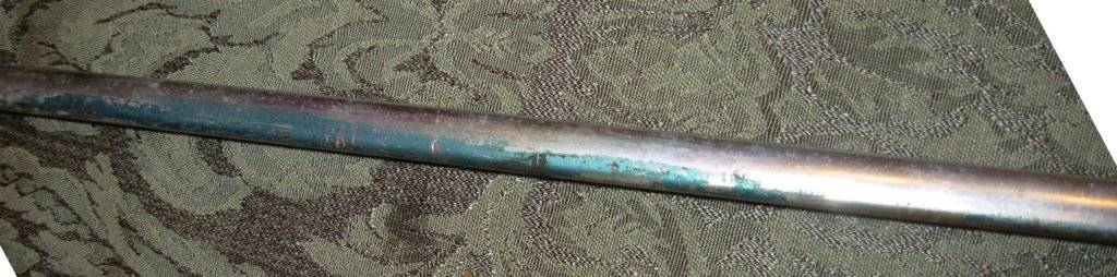

I've been sorting through the anodized aluminum trim I've collected and I have most of what I need for my car. A lot of pieces are straight and fairly free of dents and scratches, but are dull and some have paint overspray on them. Can I safely clean these up on my bench-buffer using extra fine red compound without cutting through the anodizing layer?
I tried on a scrap trim piece and it came out looking pretty nice. I don't believe it cut through the anodizing but I'm not sure how to tell. Here's a before and after comparison.

If I have polished through the anodized surface, would it be obvious from differences in coloration or lustre?
My present thoughts are to try the fine steel wool with solvent to remove any paint overspray and coarse grime from the trim, then light buffing with red compound on the polisher. I've picked up some "0000" steel wool and I'll try it on my scrap trim pieces first.

Anodizing can be cleaned but not polished. If discolored it is the metal beneath. To polish, the anodizing must be stripped. A great alternative to anodizing, once polished is a clear, glossy powder coat.

I am satisfied with the results I'm seeing on my trim using the red compound on my bench buffer. Call it cleaning, polishing or whatever makes you happy. I want to know if this is safe to do without cutting through the anodizing layer.
Your point about overheating the metal is well taken, and probably more pertinent to the aluminum trim than it was to the s/s trim I did previously. Stainless steel is not "porous" though, one of the reasons it makes excellent cookware. Cast aluminum can be porous, but the aluminum used in our trim, which is probably die-extruded, should not be porous. The anodized layer will be porous. Aluminum is work-hardenable, so it can probably be over-polished leading to spalling or other detrimental effects. However, I don't want to polish the aluminum itself, just the anodized surface layer.

So as stated there are professionals out there and they know the answer to your question. But until then I'll add that while I have cleaned and removed scratches from the anodizing I do NOT think you can polish it to that mirror look...without removing the anodizing. I have gone through the anodizing by accident and the raw metal area was initially dull and grey but on further work got brighter than the surrounding areas. This is what fueled me to go on. I tried cleaning and "polishing" my sills and couldn't get better until I hit it with oven cleaner and got out the 220 paper. I wish I had a wheel. I know it was just said they are not anodized but I certainly had to get through something before the shine would start. In the end I got something 10X better and shiny from a standing position. From pics up close they are not polished as a professional would do with a wheel.
