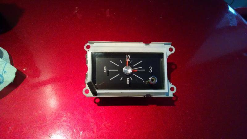

Clock clean and repair attempt

I got my clock back from clock works. Quick turn around. Hopefully I will have time to install it this weekend. :)

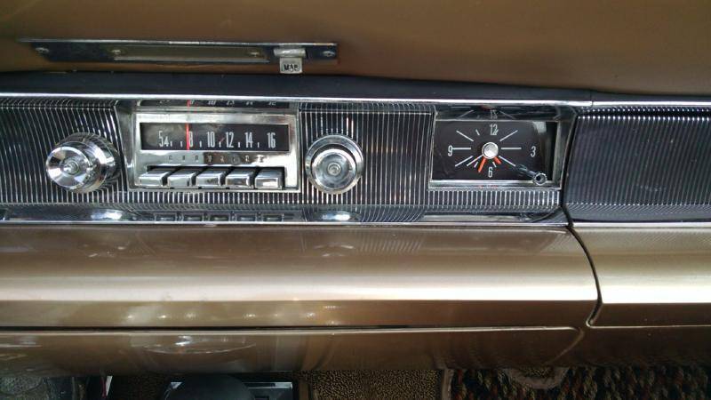

The clock is back in Goldie. 24 hours later she is keeping perfect time, which is always a good sign.

The guys at clock works must have set it or I am lucky. After 24 hours it is still right on the money, which is going to be good enough for me. I generally unhook the battery if I am not going to run it for a few days.
