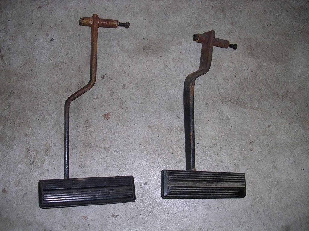

Brake Pedals: Power Pedal pivot/swivel is higher. Power brake pedal is taller vertically and uses upper bolt hole of firewall bracket. Manual brake pedal is shorter vertically and uses lower bolt hole of firewall bracket.
Power is on left
