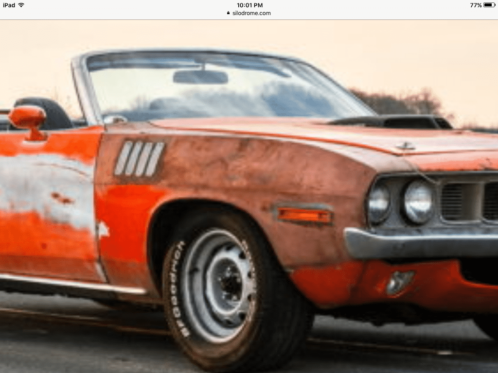

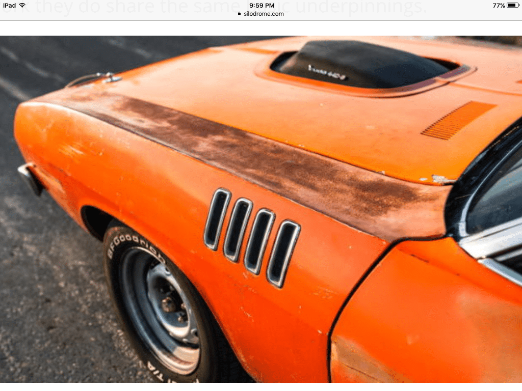

The damage to paint on the exterior isn't consistent all the way around. It looks systematically damaged. Top and inside of fenders are completely stripped of paint yet there is enough orange on the lower halves to give the appearance of original sheet metal. Both fenders are a mess but the grill is perfect. Primer under the decals can be seen through the 440 call outs?
The aluminum door sills are spot rotting but the carpet shows no real wear.
Patina looks created. Rusted bolts with no odd shapes edges. Looks like muratic acid rust. Just me.
