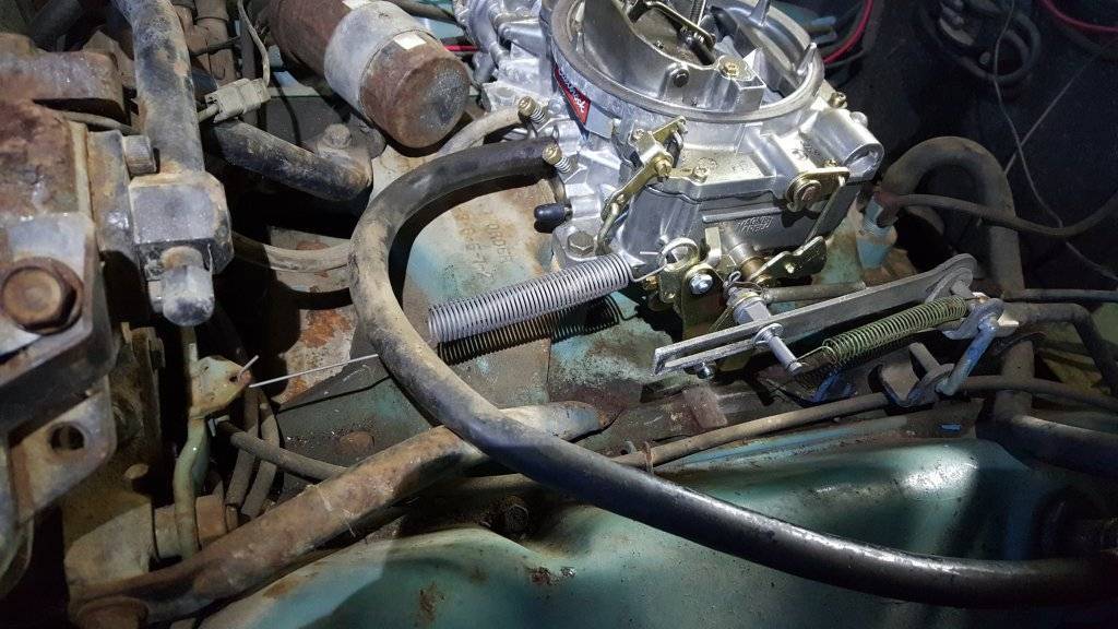

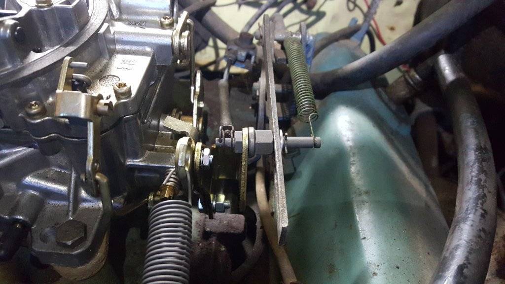

I finally got a throttle linkage pin. Does it look like I have it set up right? Also, should the nut on the pin be fastened tight or should I leave a little wiggle room so the pin can rotate where it attaches to the carb? Thx.

The nut needs to be tight.
Usually the return spring goes on the pin too. It rides in the "U" on the throttle cable end. That's not really necessary but it would give the spring a touch more tension and the spring would be a little more in line. Where you have it is OK, so that's your call. I would close the loops on the end of the return spring a bit so it's harder to slip off.
Oh... and turn the spring over so the open end faces down. Saves some scrapes on the hands.

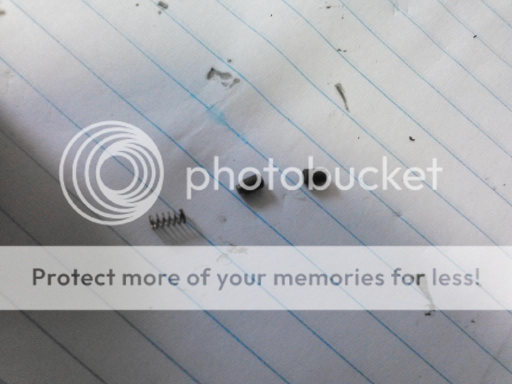

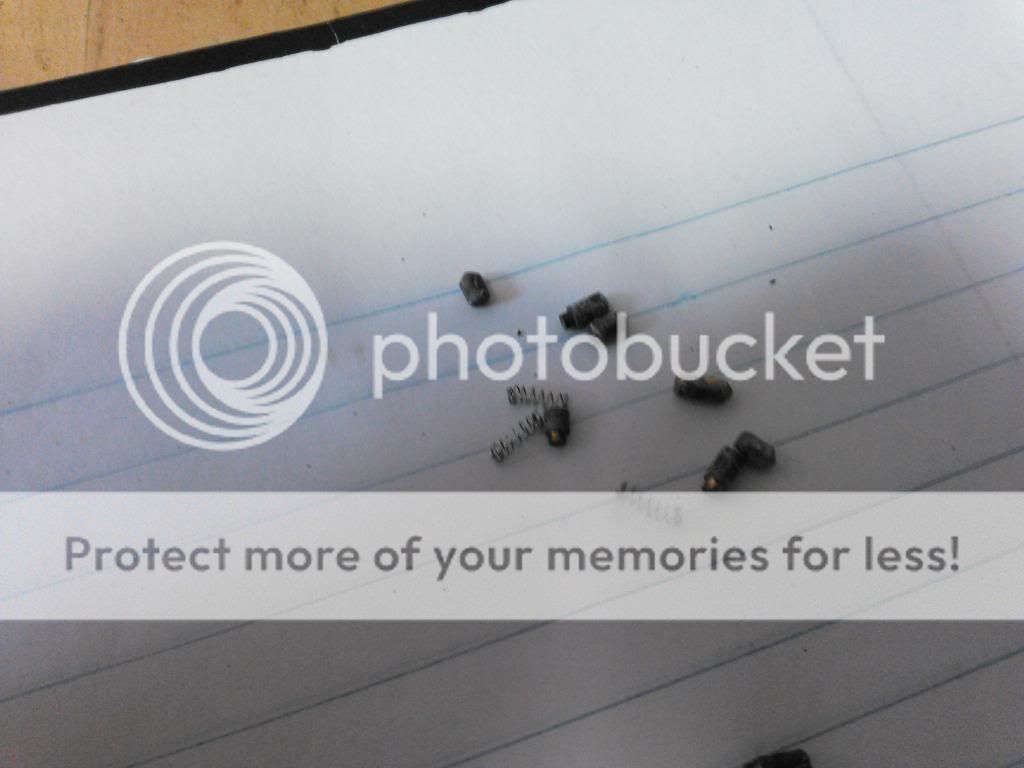

So I took my trunk lock apart because the key wouldn't go in. One of the "pins" was stuck in a pin cylinder. Each of the 5 pin mechanisms consist of two tiny pieces of brass and a spring. One of the pieces of brass is machined to fit into the spring. The other piece sits below that one and is the one that contacts the key. One of those is pictured. One end of each of these is beveled so it has a wedge shape. I don't know if that is visible here. So my questions are: 1. Is the wedge-shaped bevel part of the design or is it wear? 2. If designed that way, should the bevel end be the end that contacts the key and does the bevel have to be aligned with the movement of the key? I kind of hope it is just wear and that it doesn't really matter how it is aligned because it will be hard to get it back together correctly. I'm shocked that I haven't lost any pieces yet. Thx.

It really shouldn't be wedge shaped. It should be beveled on the end that hits the key.
That looks like the pins were stuck in one spot and not rotating. If it's just one, pitch it over your shoulder and put the other ones back in. It will work fine.
If it's all of them, you can take them all out and any key (or screwdriver) will work the lock, but it will appear correct. I'm not recommending that... but it will work. The correct way will be to buy another lock cylinder and key. Then you can have the glove box changed to fit the new key.
Thx john. If I leave out one or more pins, do I also leave out the corresponding spring and machined pin (s)?
