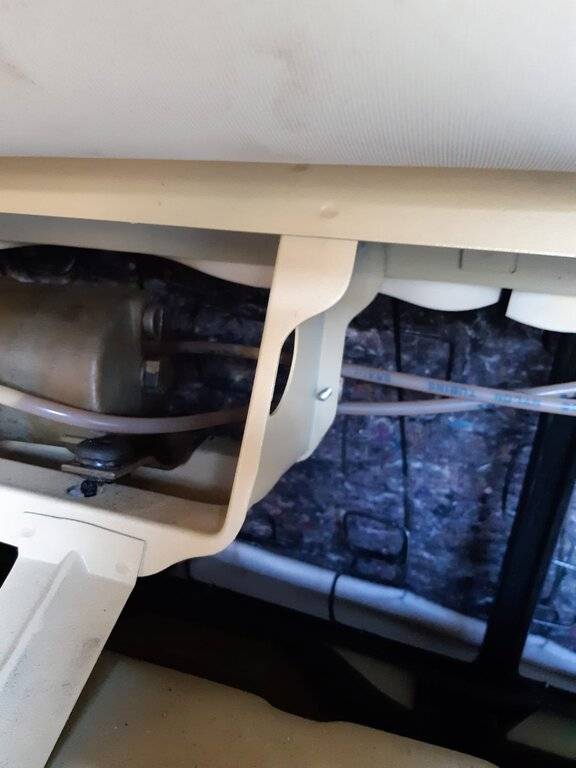

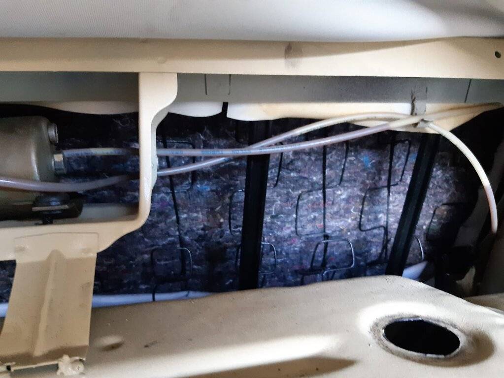

My convertible top on 69 Polara needs some attention, the first time in 10 years. I noticed the top becoming slower to close, while once I had to give it a push to move to circa 50 percent of its track to get the top closed. Quick inspection shows, there is no enough of the fluid in the tubes, giving the pump a hard time pushing the top-up.

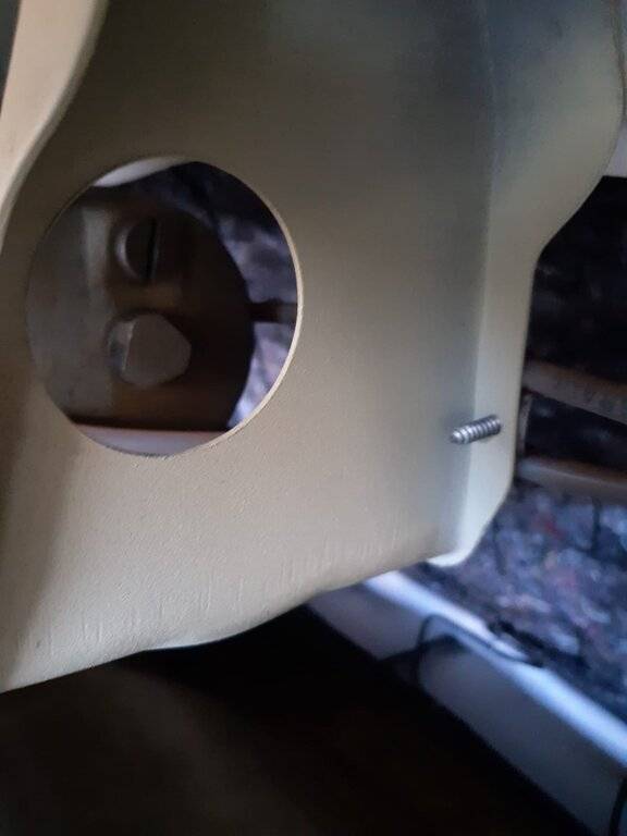

So far I found to add ATF fluid into the system but trying to do it first time correct, I would like to check where exactly do you add the fluid? Its the screw or the nut on the side, where I should add some oil? How much, like with differential until its leaking? Give some runs up and down to check if needs some more? Thank you for your clarification :thumbsup:

Put the top down then remove top motor from hold down, slowly remove screw allowing air to escape. Fill with ATF to about the point if can touch with your finger. Try going up and down with your top a few times, check for leaks and refill and bolt the top motor back into housing.
Being a closed or sealed system it shouldn't be low unless you have a leak.

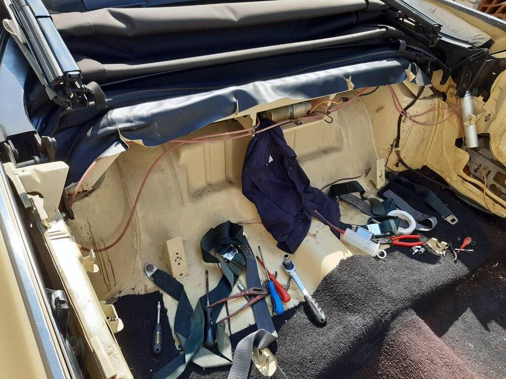

Thanks, Pete Kaczmarski for valuable info, but polara71 was spot on. I found a leaking cylinder on the driver side. I can still put top up if somebody helps to push it up, but evidently I have to fix the leak. I have two options, please correct me if I´m wrong.
1) try to buy a new cylinder and replace it - any idea where to buy?
2) try to get the old cylinder repaired locally, sounds like winter project
In any case, I would make both sides at the same time to fix it for good. Without a further detailed inspection, it looks like the cylinder holds in place at the construction just on the top from sides and movable arm is secured just at the top position. So once I remove the upholstery, I should be able to remove the cylinder quite easily. Any advice? Thank you for your inputs.

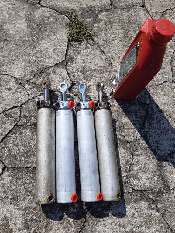

Getting around to posting some updates for the new cylinder replacement I did in the summer. The parts from www.hydroe.com were superb copies of the old cylinders, with no fitment issues. I took everything outside the car (pump, lines, cylinders) and did replace them on the ground to avoid messing with the AFT inside the car. Installation was straightforward, did a few cycles up and down to remove the extra air from the lines. But the performance was not that great, but suspect the battery was on its last leg. Which resulted in a battery jump-start later, but that's another story :) will see how it works with the new battery in the spring, otherwise I might have to look at the pump condition as well.
