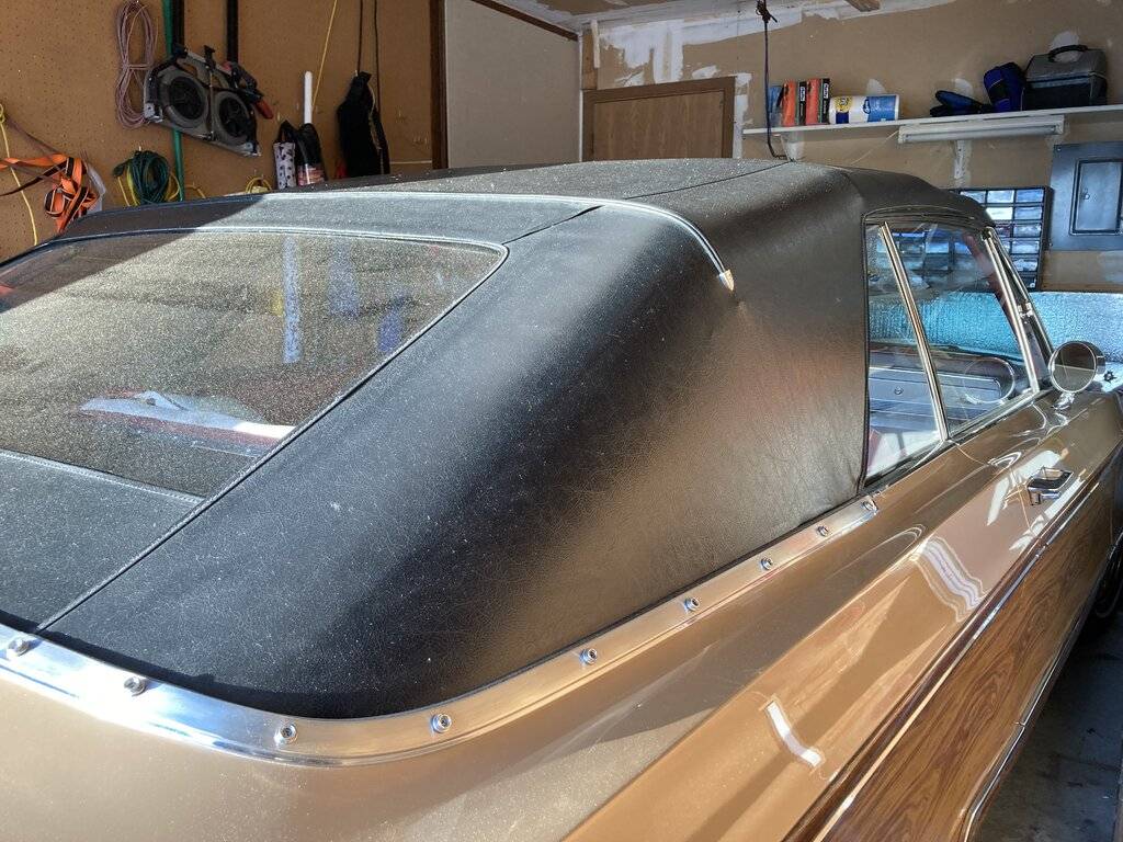

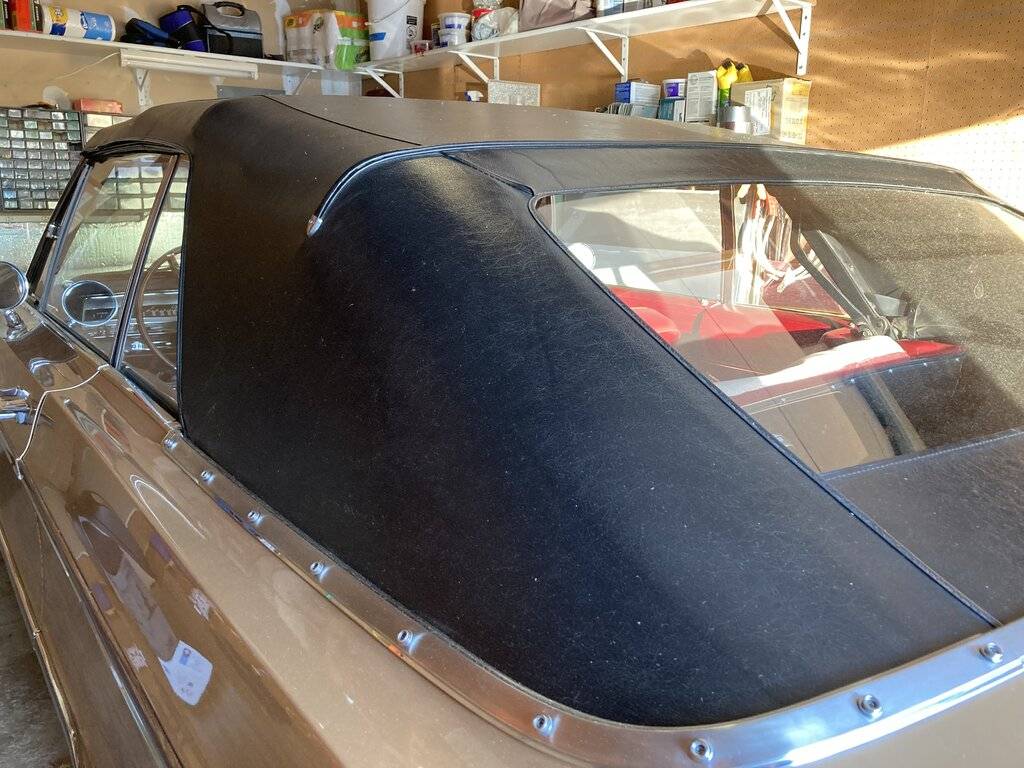

Here’s a couple pictures of each side of my 68 Newport Vert. This is the original top.
View attachment 461206View attachment 461207
When looking I certainly didn't put slabs in my scope. The trim is there I presume to hide the rear bow. If it stops too high you can see the bulging material over the bow under the top, it's ugly or can be.
Not a lot of original tops left.
seems like the trim may not go completely to the end of the bow. there must have been a little room left to compensate for not centering the trim strip on the assembly line . i guess the question would be if the trim strip was pre-cut or if it came on a roll. if cut during installation every car would be different.
It doesn't go all the way down, you are correct. Sure some margin for error I suppose but I don't know how it was installed.
The local replacement upholstery guy receives a roll from the supplier and installs it, he cuts to length.

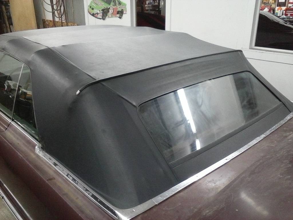

In the interest of showing original tops, here's my 68 Imperial. Original green, mostly shredded, top but you can still make out how it extends down the side on the bow.
I appreciate this detail as I'm new to convertibles and I'll make sure this is duplicated when I get a new top done.
