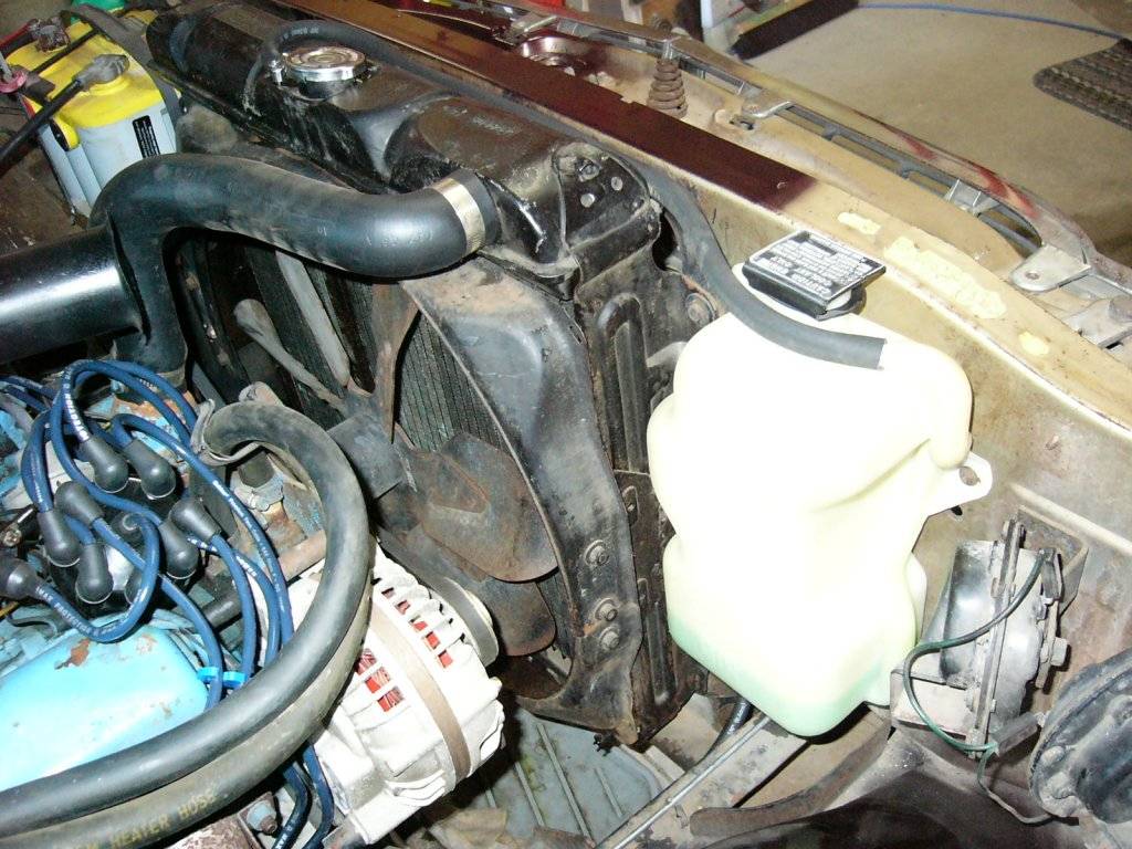

This is what i just did

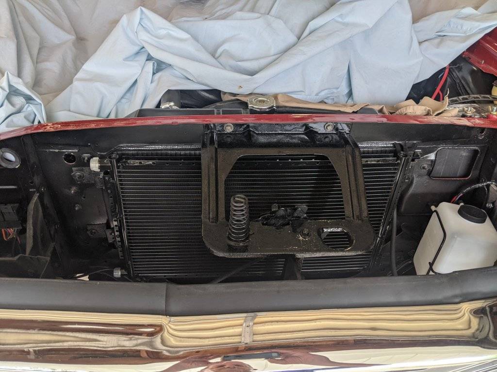

I just use an old quart of oil bottle wedged between the core support and battery. Comes out in seconds for when at the big Mopar shows and it was free.

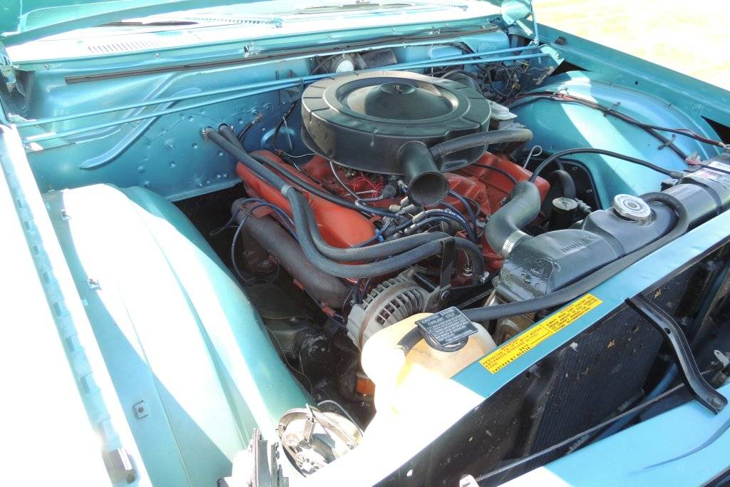

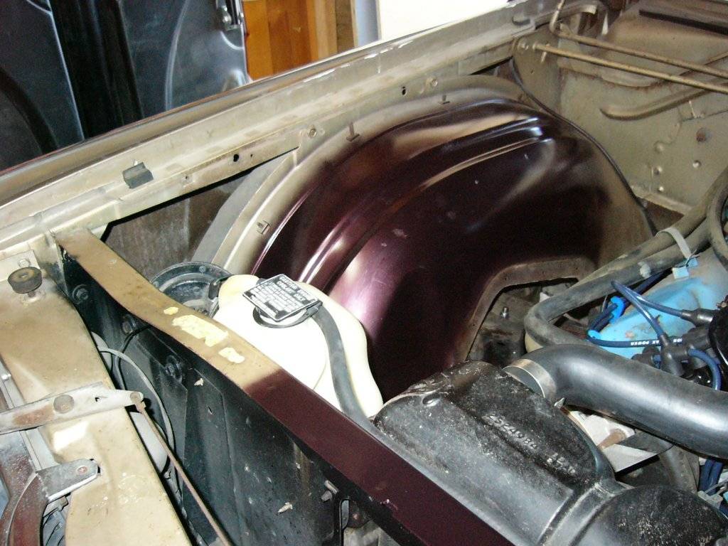

Thanks for the info. Most I knew but was most concerned with my 69 that did not and still has no overflow tank. I was concerned about the large airspace above the coolant in the radiator after it burped and how the air could cause corrosion.
You’re welcome.
When there isn’t an overflow tank and the engine cools off, you’re right about having concerns with that airspace, the air being pulled into the radiator is considered contamination. Granted, the air will cycle in and out of the overflow tank, it’s just best to keep the air out of the radiator.

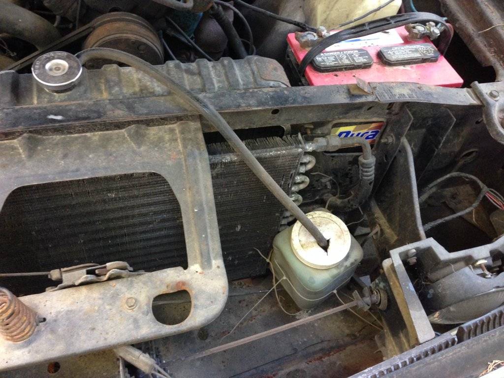

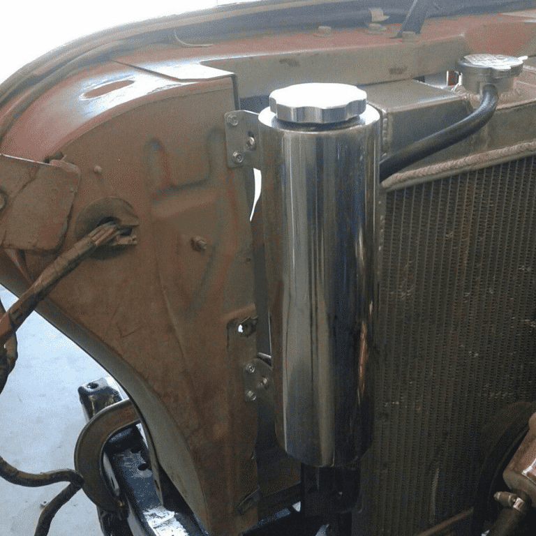

When I was building my hot rod Newport, I made my own with a NOS energy drink bottle (24 oz), a hose clamp and some leftover braided hose/fittings. This way when the hood is open, some kid who doesn't know any better can point to it and say, "Oh cool, look! He's got NOS!"
And yes, it works. The hole on the cap is big enough to allow air & vapor to flow, but the real trick to it's effectiveness is the hose MUST reach to the bottom. That way when the radiator cools off, the vacuum it creates internally will draw the spent coolant back in to keep the radiator full.
You can use ANY container as a puke bottle. Hell, my old dodge pickup uses a 1 quart oil bottle, no cap, sitting between the fender and the battery on the battery tray. So long as the top of the bottle doesn't sit higher than the radiator cap, the hose goes to the bottom and it's vented open, it'll capture any boilover and suck it back in when the system cools.

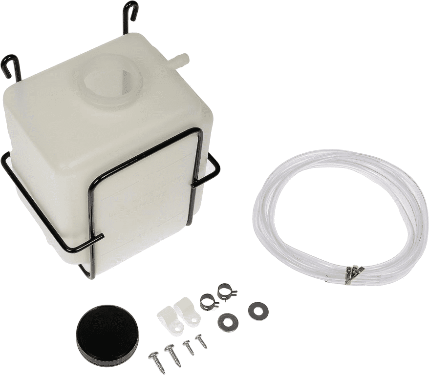

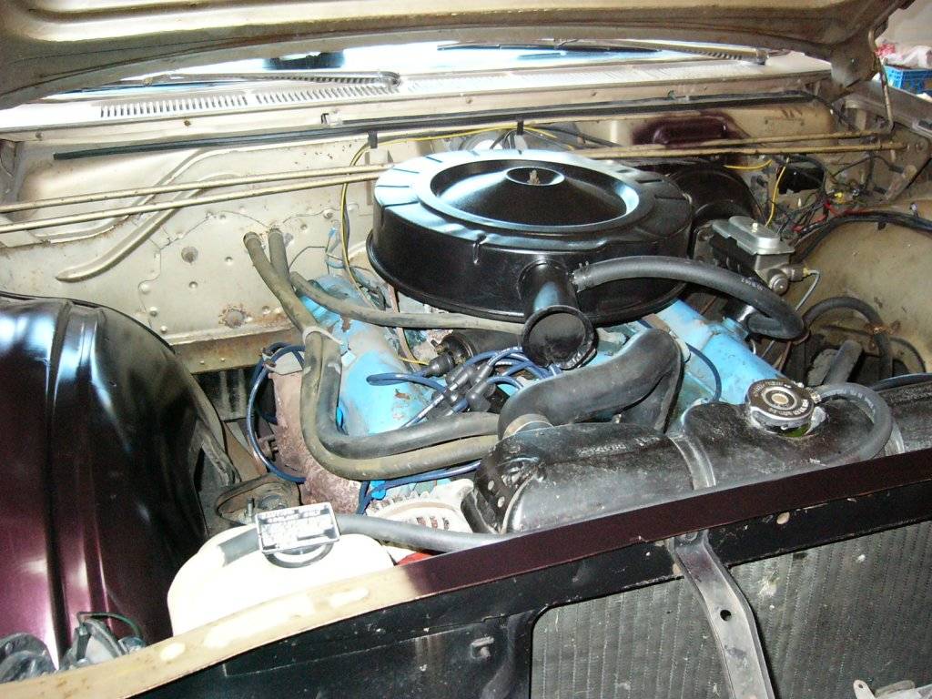

Please, could do you give me the dimensions of this reservoir? It could be usefull before ordering one and ship to Spain.
Regards.
Sorry, I no longer have the car to take dimensions. Maybe @pioneer would be able to do it. An online search shows a very similar (possibly a newer part number) with dimensions of 13.2 x 8.8 x 5.5 inches which, from memory, seems close to the one I had.
52027784 - Genuine Mopar Tank-COOLANT Reserve
Thank you 300rag and everybody, for your help.
Now I can check the fit perfectly.
