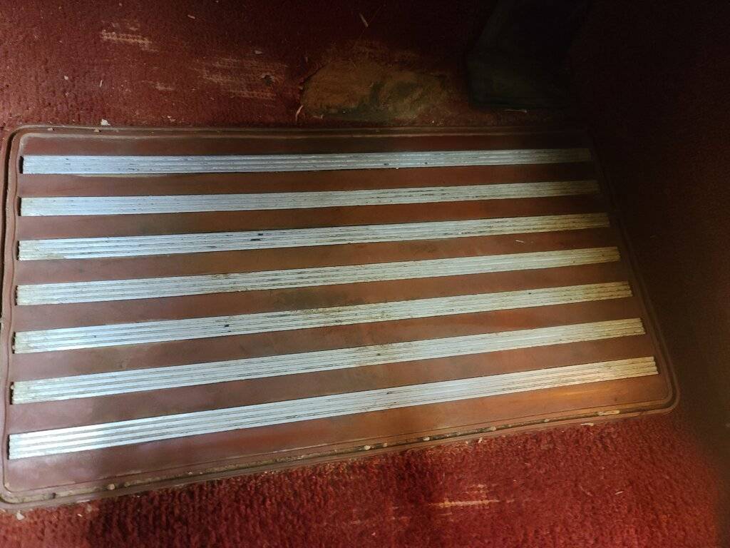

I never knew they [or any car for that matter] to have stainless trim on the floor mat. Gotta a pic for proof?

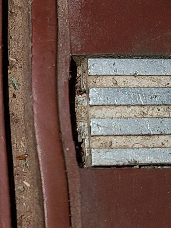

Might be aluminum. The inserts are pretty stout. They're on both driver and passenger sides.
Even represented in the sales brochure sketch.

Lame, that's what I was afraid of. The carpet itself isn't in horrible condition save for the wear right in front of the rubber pad.

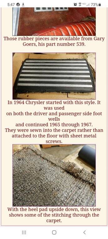

Boom! Good call on the 300 club. Screen shot from their website. Looks like I'll need to put my wife to work on her Pfaff industrial sewing machine!
I believe that the normal heel pads were heat-welded to the base carpet, not sewn, OEM? In the case of some aftermarket carpet vendors, they mold the basic carpet and then apply the correct/desired heel pad with heat and pressure, from what I saw years ago.
How are the strips attached to the heel pad itself?

Ok, did a little more research and found this article:
L Carpet
Looks like the old stitching can be cut and the pads glued to the new carpet, so long as you specify no factory heat applied pad.
