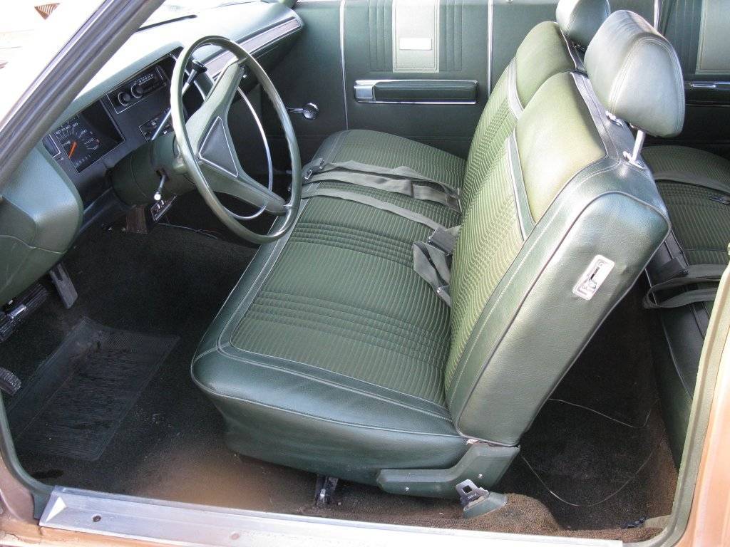

Anyway seller pulls tarp offa car and am thinkin uhm...ah...er this is not what l was excpecting....thought being a farmers car interiors gona be rough for shure so wandered over to open door and shure enough there was seat cover on front and rear seats...knew theyd be toasted underneath....
thinkin to myself door panels are looking like knew l wonder....
well off with the seatcovers l say..lets have a boo...to my shock l find this....

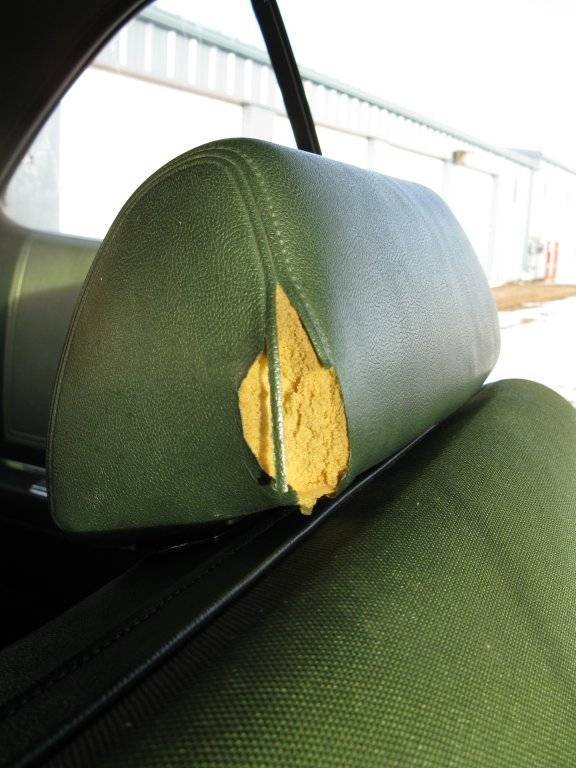

not a rip....not a tear....not a single crack in the dash...the interior was simply spectacular with the exception of one headrest...the only and single flaw in the whole interior!!!

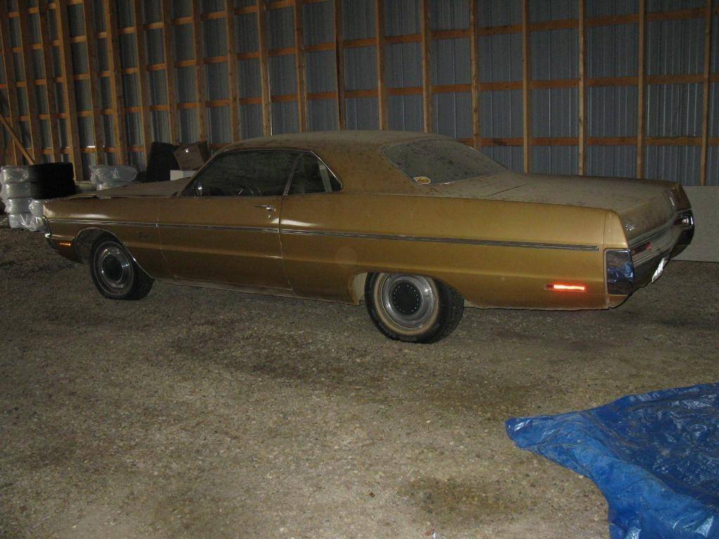

anyway interior was in great shape and exterior was just as good with one small dint and some typical rust on lower valances..was small touch of easly fixable rust on rear wheel wells...other than that car was mint...l was thrilled and my black Dan Brooks Build was down the drain.....
Dam car was to nice to touch...dam it...dam dam dam.....hada leave it alone...dam
anyway loaded the ole boy up and it was hesitant and would only start with help of starting fluid but got it loaded and off l went...

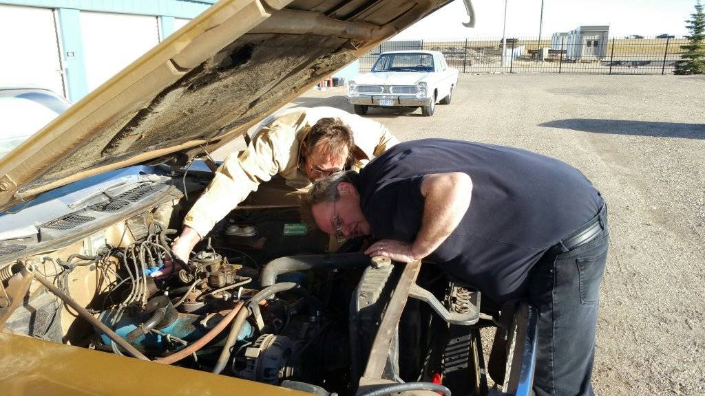

seems every time l turn my back theres someone honkin at the gate or l find someone under my dam hood...their like rats l tell ya....
thought they were helping till l realized they were just eyeing parts they needed...heck Fury 1 helped himself to my jack the other day....know Pete was eyeballying my lower rad hose pretty good at one point till he realized his lower rad hose was on right not left like mine...phew... am losein parts as fast as l can find them....
All kidding aside could only start car using starting fluid then was touchy to keep going all be it it ran...Graham put his timeing light to it and tried to sort stuff out...turns out distributor was set at ridiculous setting and carb needed slight adjustments but he got it running pretty dam good to point it would start and run by itself to the point that me..Pete, Terry and Graham all took a boot about the lot in it...was actually the first time l drove it since l bought it other than of and off trailer so am gratefull to have these stooges about...with me and Pete both having same 2 barrel carbs Graham has sourced out the carb kits for us and another sorted piece er two...with a little luck will actually learn what l need to know from these kind folks to keep both the 70 and 71 running in top notch form..thanx fellas

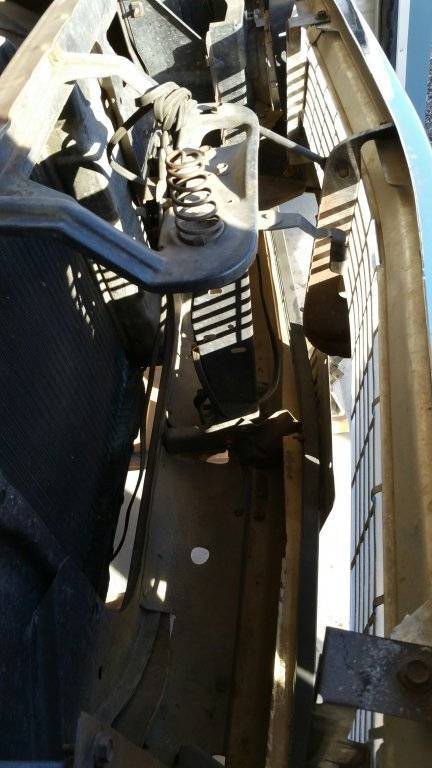

in swapping from the standard grill to the hidden headlight grill is there anything l need to do to the headlights or there mounts to make a hidden headlight setup work?
will get motor and bar ect and center support looks to have holes for motor bolts so short of wireing dosnt look to bad to switch over...from what l understand bumper has to come off which is okay as it gives me oppd to clean up front end

Critter, your in box is full. I have most of what you need I think, for the hidden headlights. less the torsion bar. send me a list and I will make sure I have them and get them to you.
