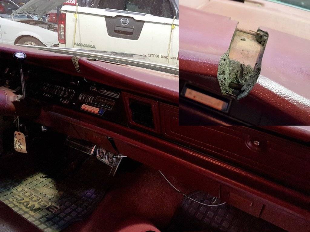

Any guidance available for removing the dash pad on a '69 300? I've pulled off about a half dozen nuts behind the dash and I can feel sections getting loose. Is it possible to detach without removing the dash altogether?

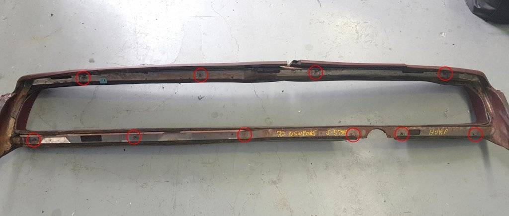

Got it! Didn't need to pull the whole dash out. The top bolts are accessible behind the instrument cluster and from within the glove box. The hardest to remove was the bottom one near the middle (3rd from the left in the pic). You can get to it by shifting the air vent and glove box facia. Luckily the nuts are easy to remove by hand once they're a little loose. Altogether 4 up top and 6 below then it comes free pretty easily. Thanks for all the advice!
