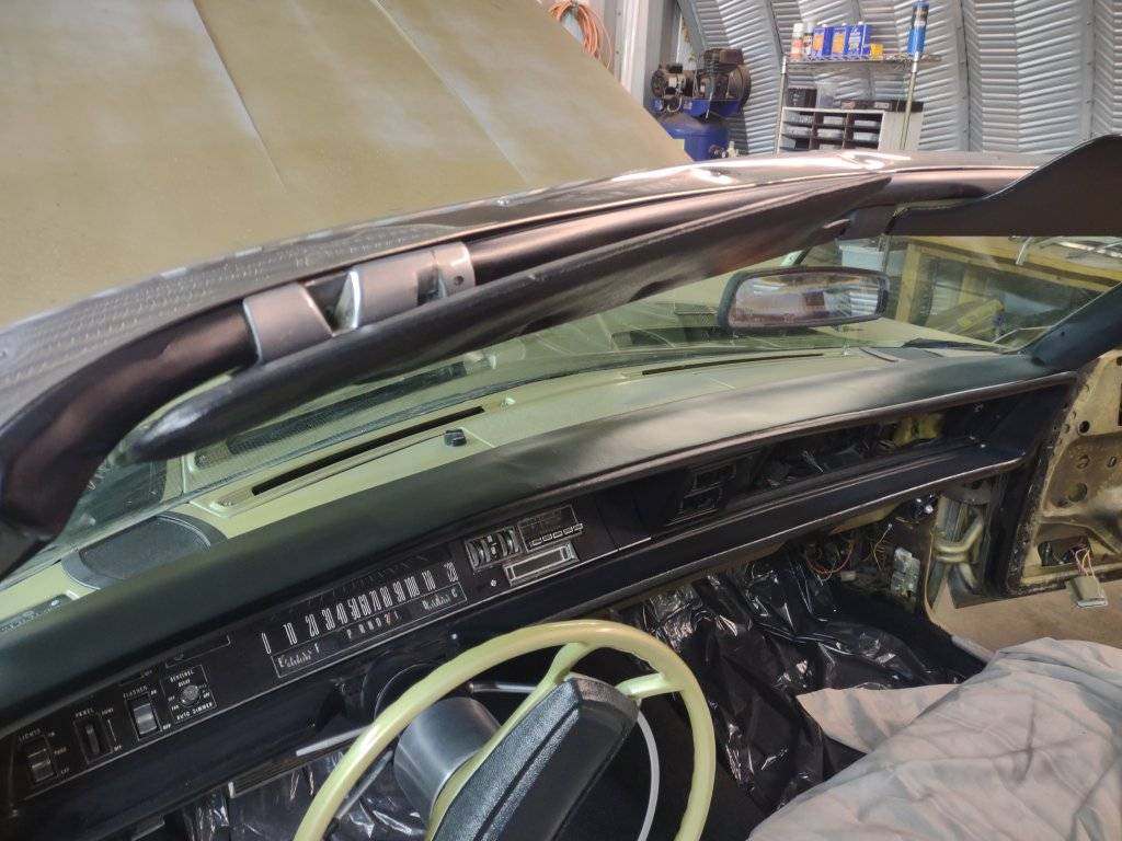

Well my dash turned out pretty good for a rookie.
Before and after.

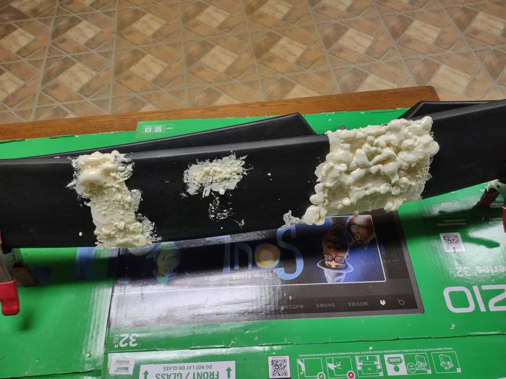

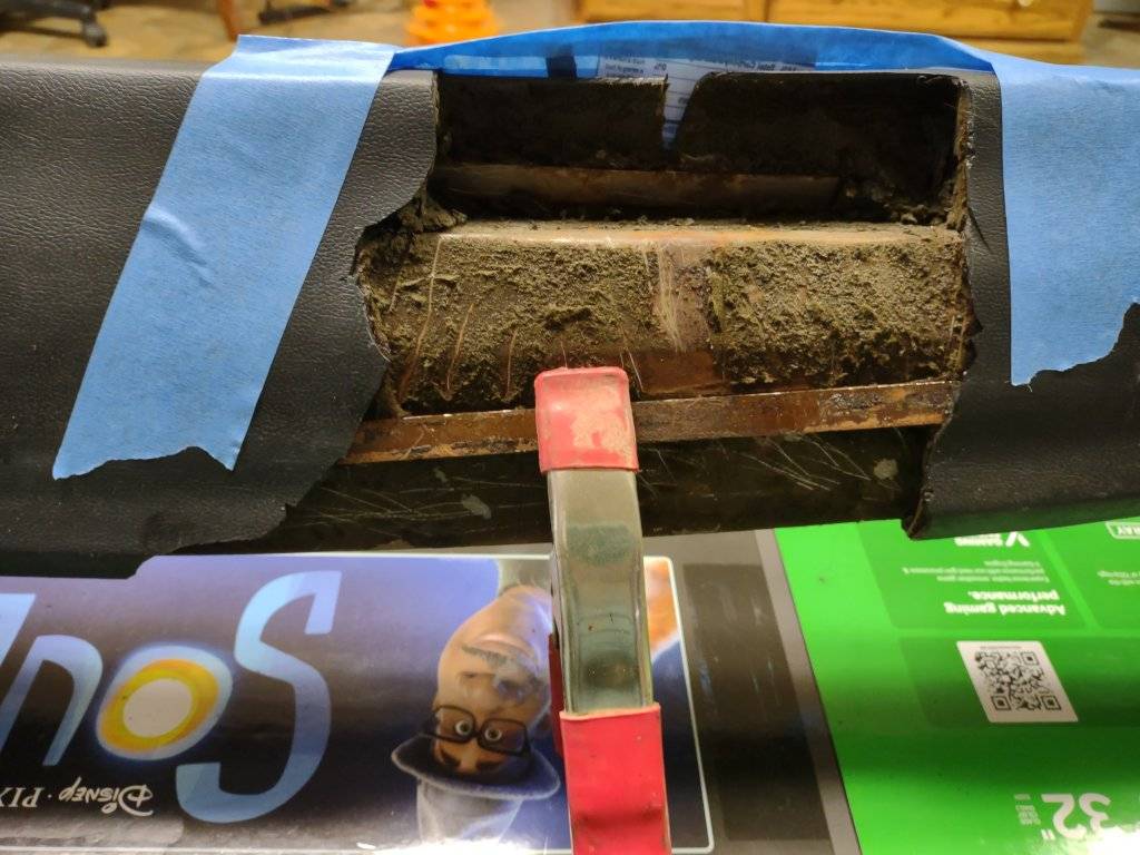

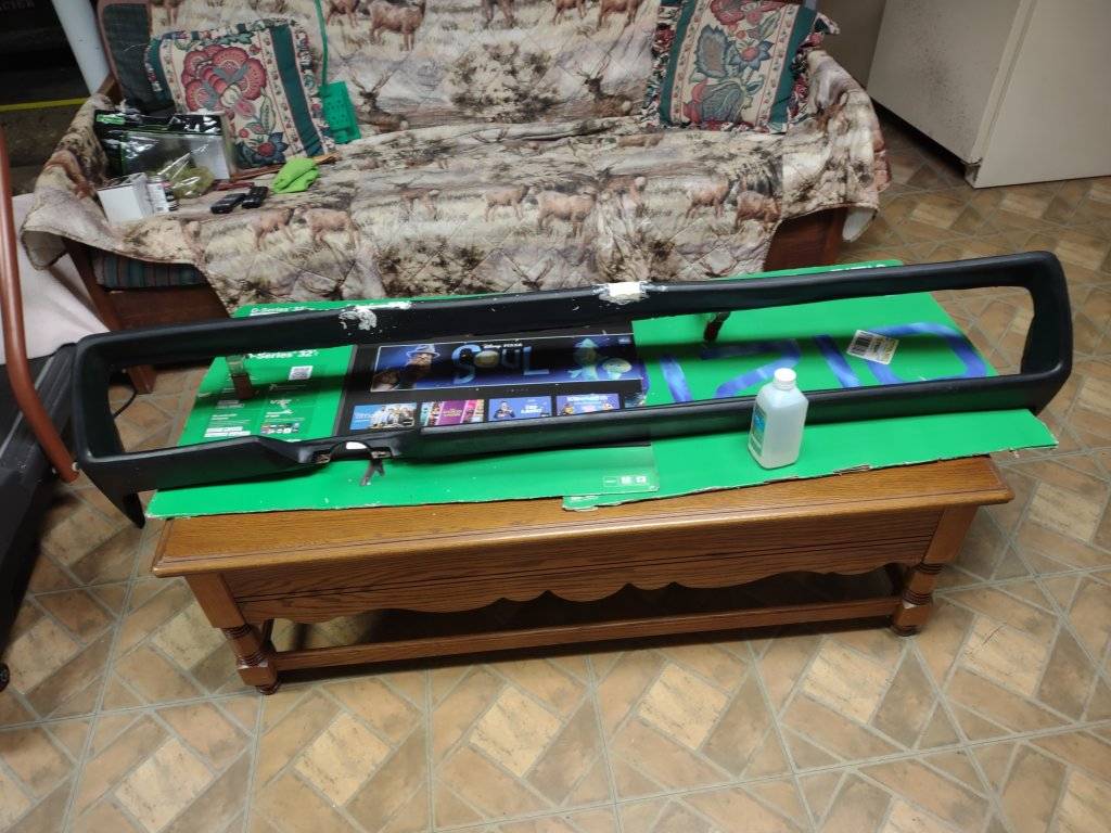

Haha. Took 6 months cause the dash foam was rotten and i had to dig out what was left.

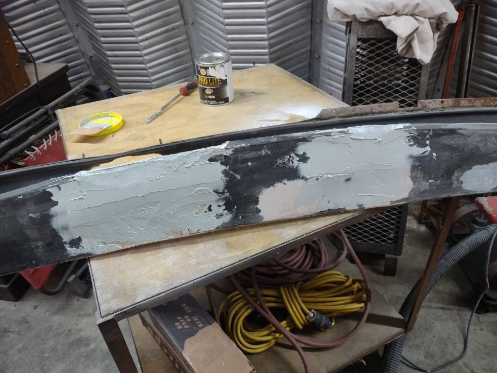

Used construction foam in spray cans then shaved it down with a fishing knife. Then started the bondo process. Layer upon layer till i liked it. Im lousy with bondo but i like the results.
Wow. What a process. Looks like you did a great job especially considering what you had to start with.
Thanks. I tried body wrap and carpet but didnt like any of it. My arm was really tired from sanding haha
