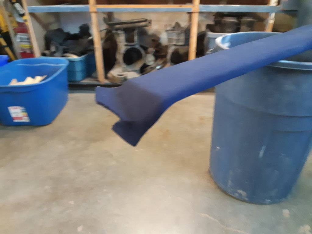

This is polyester cloth and it pulled around quite easily. This could possibly work under the vinyl
