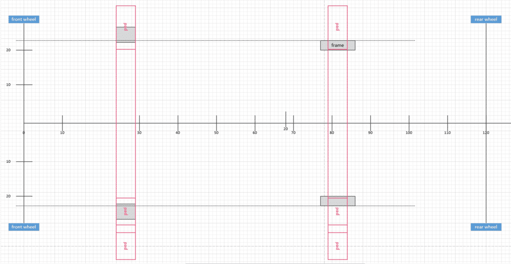

This is how the lift points map out on my 74 Fury
This is how the jack pad openings overlay on the lift points when running in parallel.

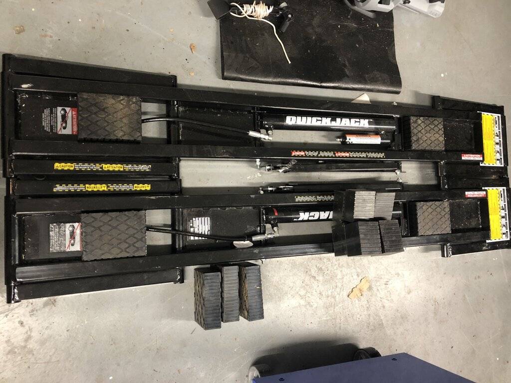

To go with my jack I picked up larger rubber lift blocks for the contact pad areas vs the small sets that came with.

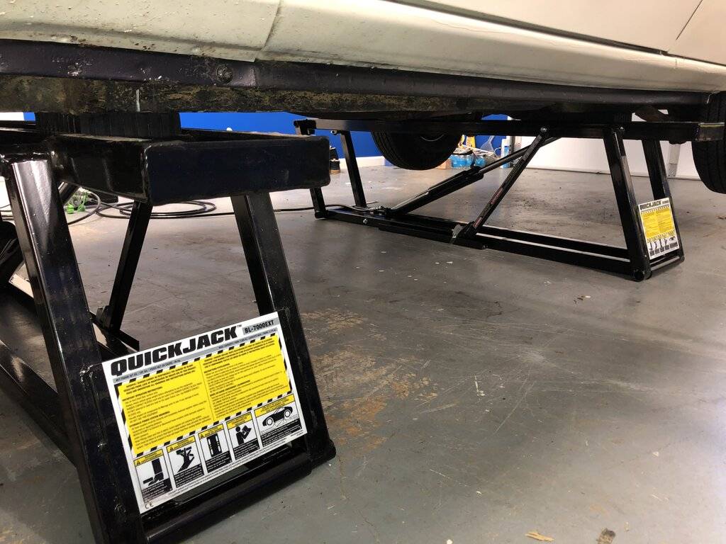

1 - On my low profile creeper I can get under the car fine and do anything that needs doing that I’m capable of. I couldn’t pull the transmission though. I’ve done shocks, oil pan, brake work, and dropped the exhaust. It gives me more height than jack stands as well.
2 - They don’t seem unsafe to me. They also feel safer than jack stands. Again though, to me.

I agree with @jason99 I don't feel unsafe under mine, if you're concerned, you can use jack stands but if used properly, I think they're safer then jack stands.
As I said in the video, I've only raised mine to the first lock position and I can slide under the car for normal maintenance such as oil changes and tire rotation but I've got height restrictions. That's why I don't have an inexpensive 4 post. If I don't open the hood, I wouldn't have any problem raising to the second position and I'm sure I could use my seated roller to do brakes, shocks, etc. and use my creeper for exhaust etc.
Thanks, I bought all the blocks available from QuickJack, where did you get the large blocks, they seem to fit perfectly in the pans?
I got a set of the 1.5 and 3in blocks from this site:
Rubber Pads Archives - Car Lift Parts
They smelled terrible when I first got them, but I scrubbed them down and left them outside to offgas/air out for a few months and now they are fine. Width wise they fit perfectly in the pans and give a much wider contact point with the frame, which is mandatory according to the FSM for my car.

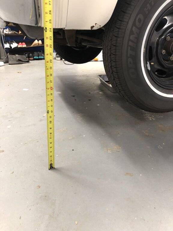

Do you know the ground clearance of the GTO? My wife's Scat Pack is 4.6" and I'm guessing I would have enough room for the cross member. I can't say for sure but based on the amount of room I have when I slide the quickjack under the car, that would be my guess.

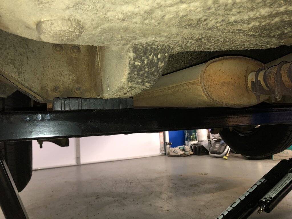

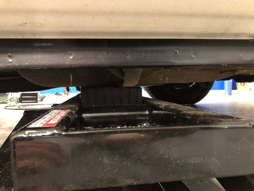

And some pictures of the contact points. I marked the front point and the rear area with a paint marker you can sort of see.
