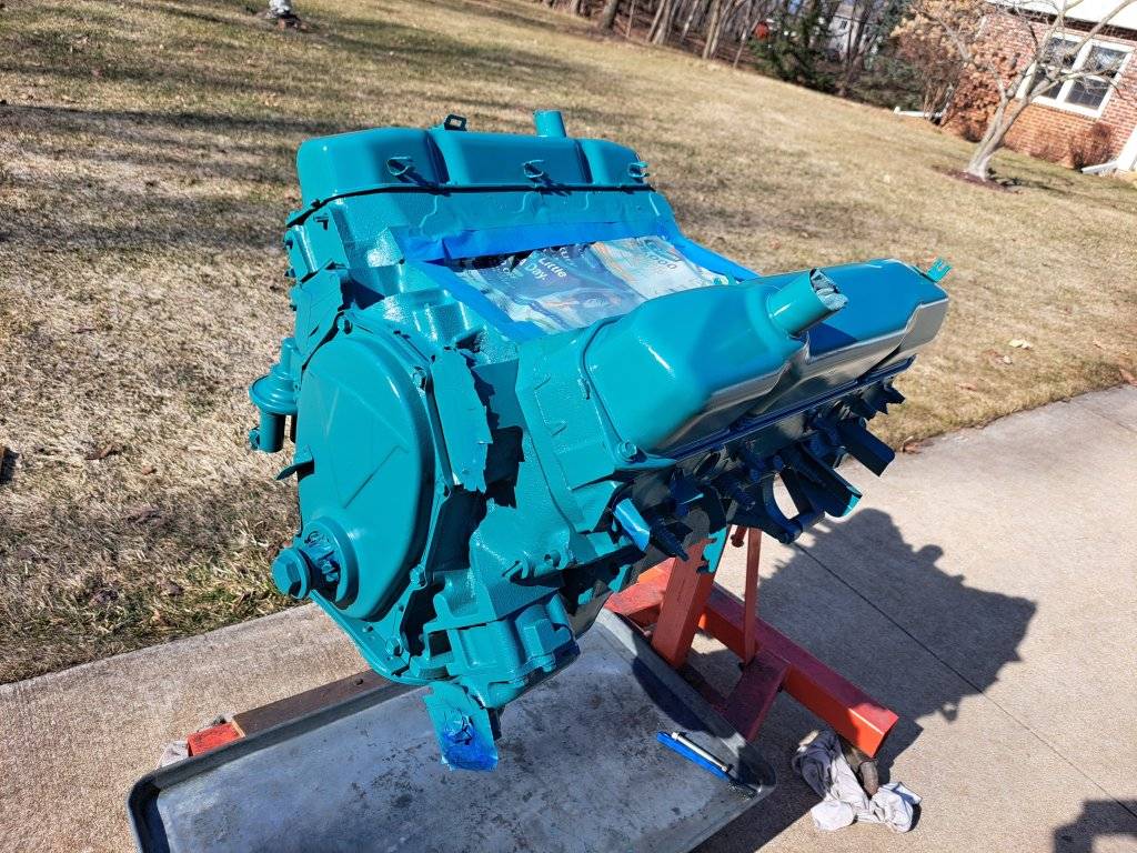

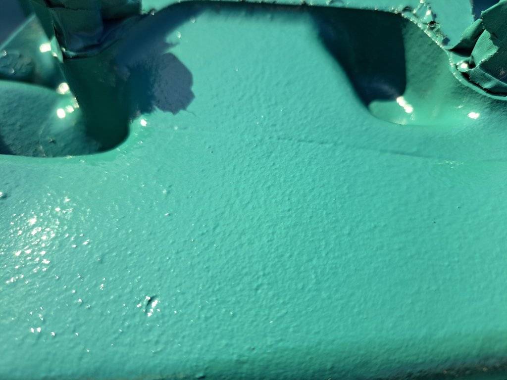

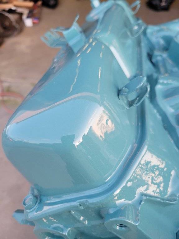

Here's a video I put together in which I compared most of the available brands on the market. For those that don't want to watch the whole video, I chose to use Bill Hirsch 1957-8 Pontiac Turquoise after seeing a sample they sent me. Also attached for your viewing pleasure are two photos showing the same paint to show the drastic difference in color from photo to photo, even on the same camera in the same light. The lighter "green" color is closer to how it actually looks, though not quite 100%. When I zoomed out to take a photo of the motor, it captured the color in a more "blue" manner. I hope my time and expense helps someone else.

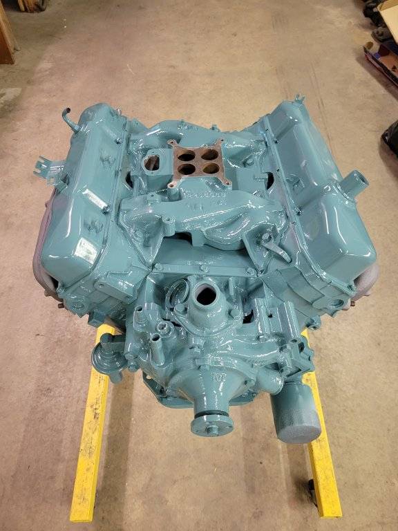

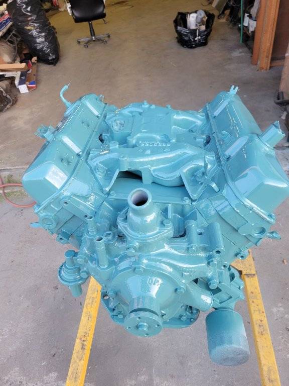

Here's a 66 look a like painted this summer with por15.
Outside/ inside
It's interesting how different photos can change the colors. The bottom looks turquoise where the ones above it look blue. .
Yes, the photos and video can DRASTICALLY change how it appears. Maybe I'll bring the pan and paints along to the c-body show in June and let everyone look at them in person.
How the colors "look" will be determined by the "heat"/color of the lights illuminating the photo venue.

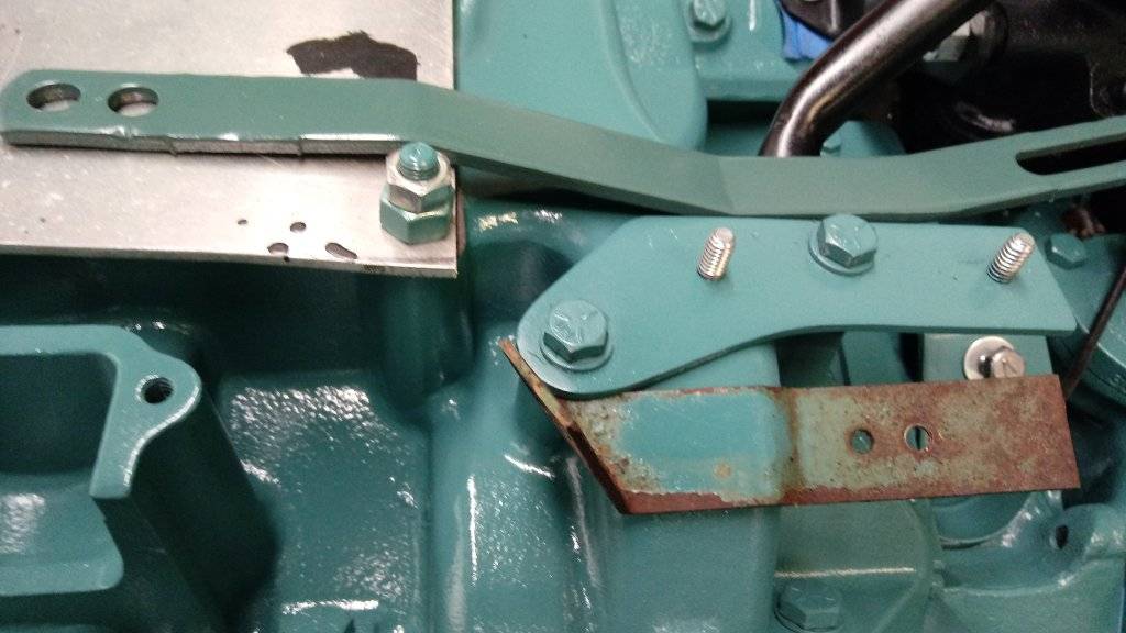

I used the Hirsch Chrysler turquoise last summer, my eyes aren't so good these days but it appears too green to me. Where as everything else on the market these days appear too blue. I bought a whole case of the old Mopar Performance turquoise in the late 90' s.....now I can't seem to locate it. I'm sure it's not going to be any good now anyway.
used the Hirsch turquoise 2 yrs ago...also thought it was too green...then when i ran out it was out of stock for a year...sent pics to Hirsch and they swore it was correct...they sent me a link to a video where some club said it was the closest match to some other paint that was discontinued...they said it was right for 62-65...SO...idk if earlier turquoise was darker green and later turquoise was more, well, turquoise, but original stuff on my 68 didn't match the Hirsch stuff at all...what it did match was a 20+ year old can of Mopar Performance turquoise...end result was the 877 4 paint 1 stuff( the link DaPoz just listed) and i'm happy with the color....now i've seen some recent posts about the Hirsch paint and it doesnt look as green as my batch so maybe they changed it once it was back in stock...YMMV

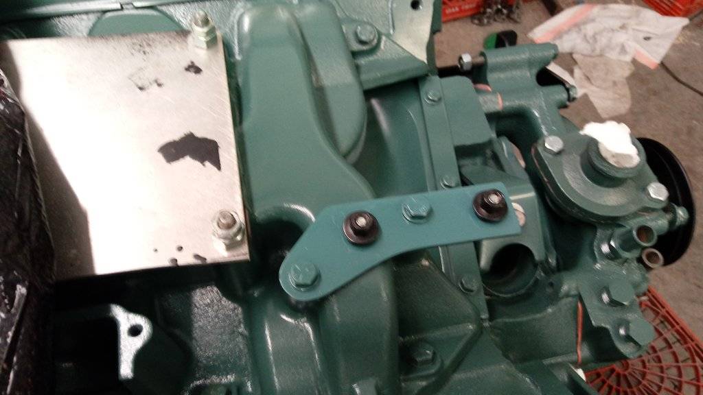

Engine painted with Hirsch...coil bracket 20 yr old Mopar performance
Engine repainted with 877 4 paint 1...coil bracket still old MP paint...small a/c line bracket original paint....alternator bracket laying up top still painted with Hirsch paint...all pics under shop flourescent with no phone flash...but the same results outdoors

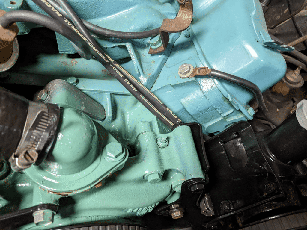

Water cover is Duplicolor Alpine Green, VC and cyl head is older Mopar Performance turquoise.
I included the Detroit Diesel Alpine Green in my video. It's the second-from-right on the oil pan.
