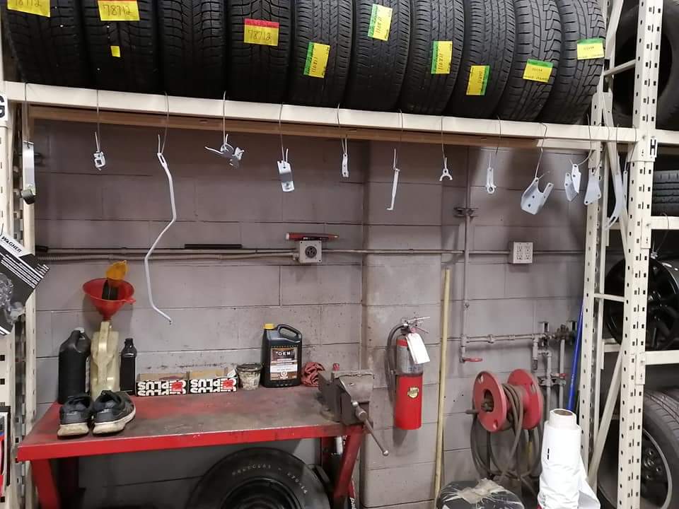

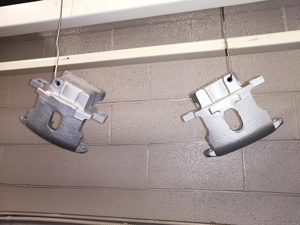

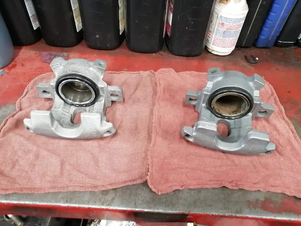

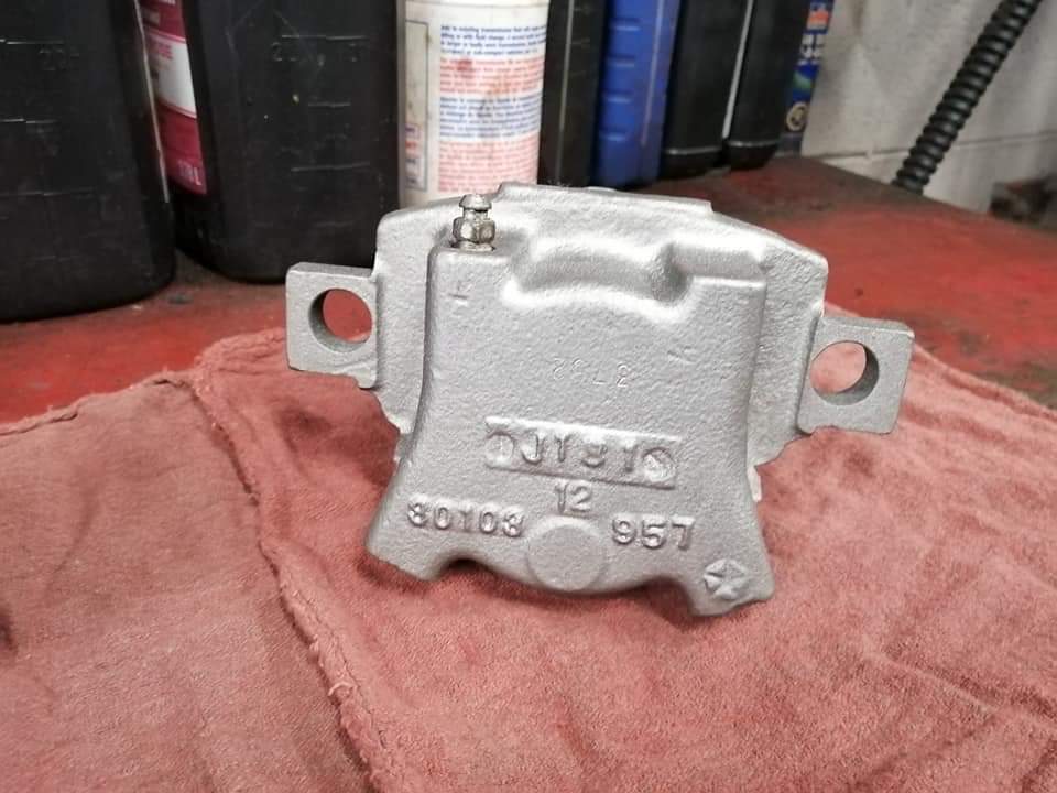

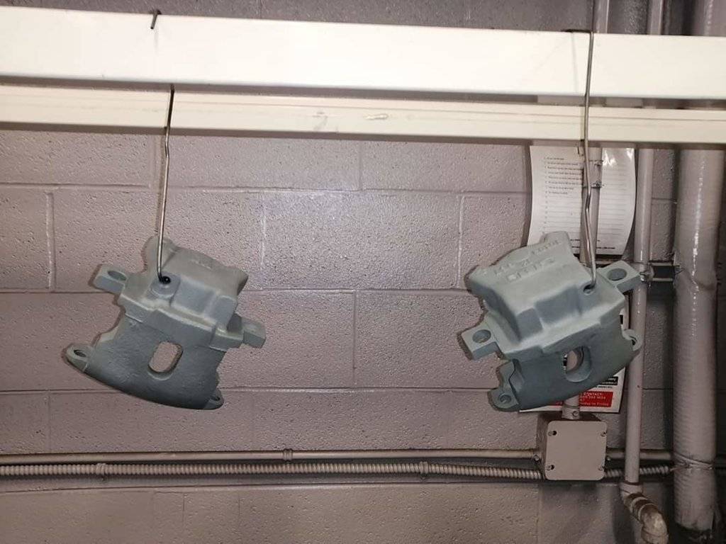

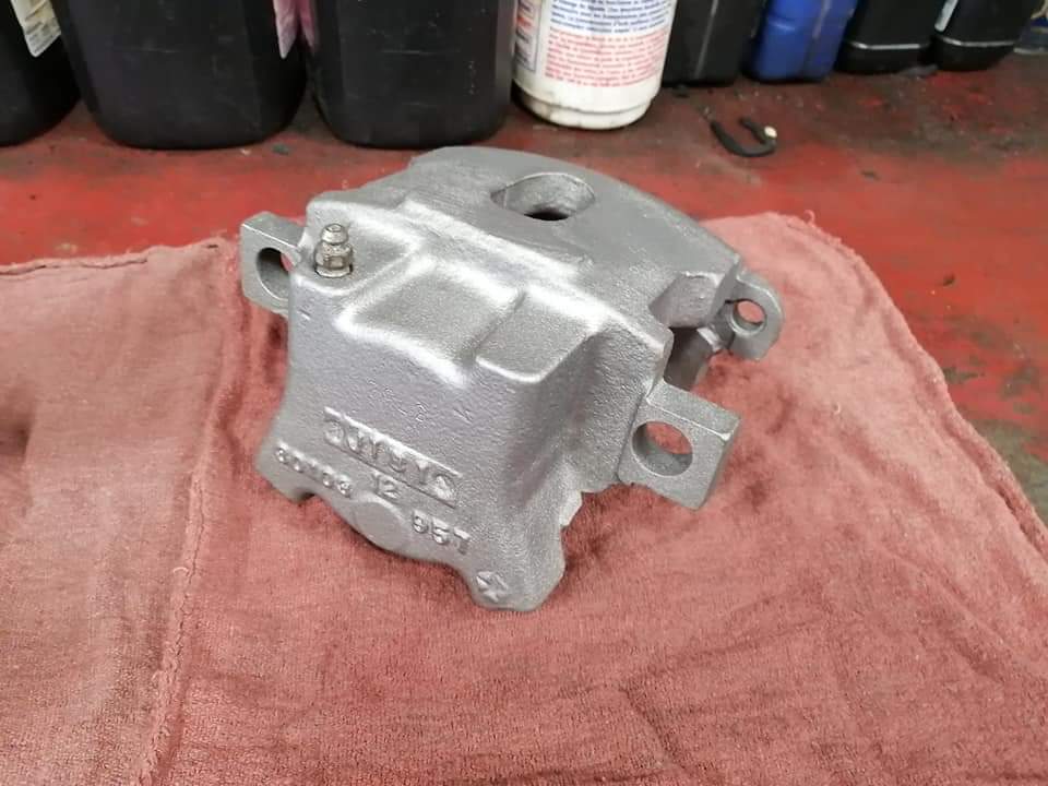

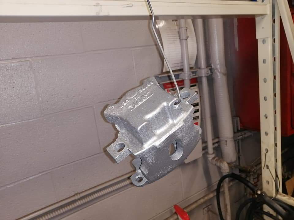

Busy day at work, before leaving I did get the calipers down to bare metal and primed though, as soon as I get in to work in the morning I will shoot them in a coat of paint.
That's what the car was meant to be, I'm trying to hold to that.... But I'm also a perfectionist by virtue...
I enjoy seeing the quality of work that you and other members here put into their projects, makes me push myself to do better with my car.
I painted the calipers first thing around 7 when I first got in. Probably good thing I did as I've been non stop all day. In fact I'm just stopping for lunch now (3:30 pm here)...

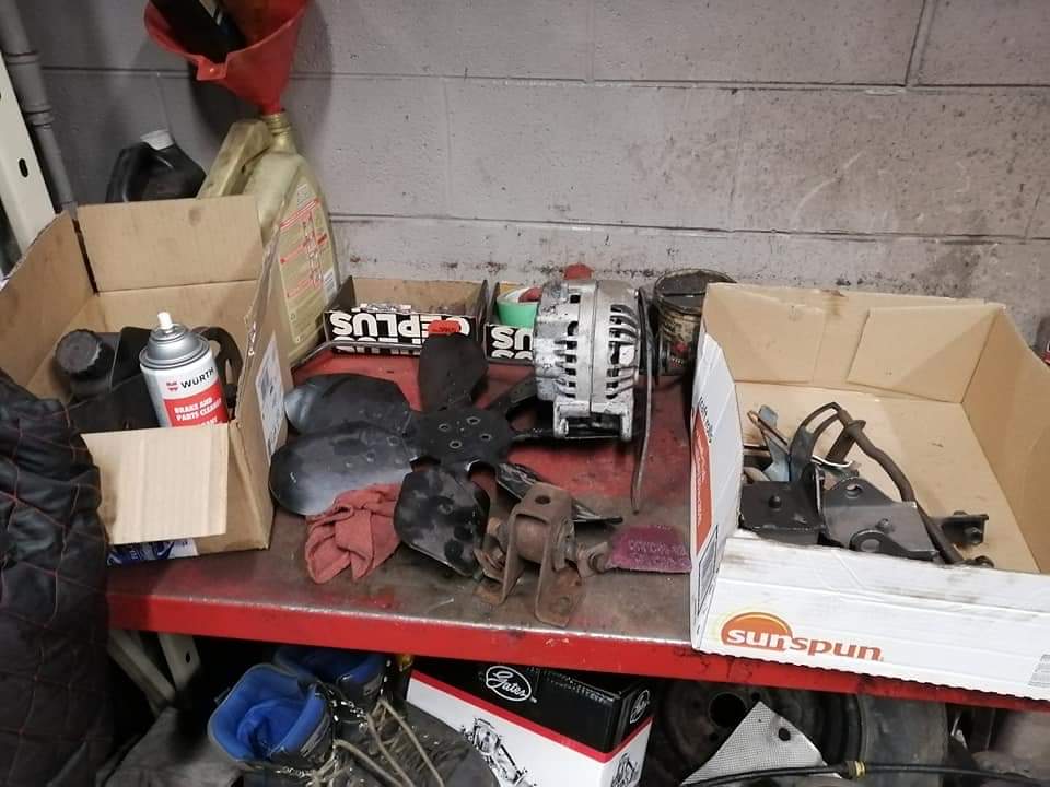

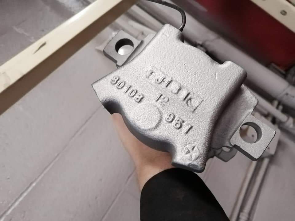

Cleaning up and painting parts, dragging stuff to work for when it slows down here soon...
Parts have been arriving too which is certainly not a bad thing...

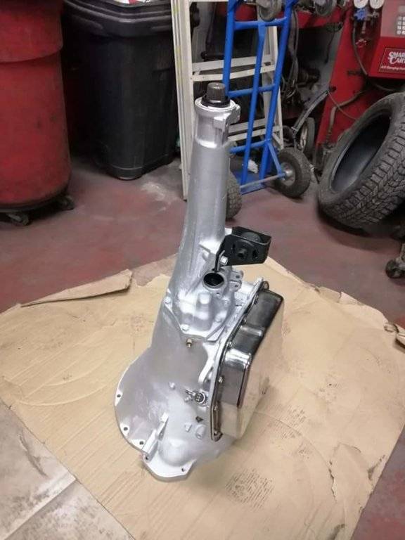

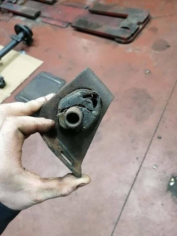

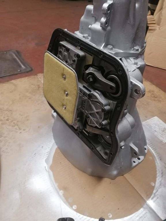

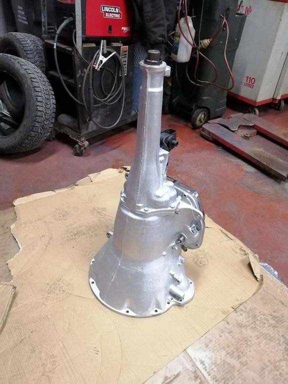

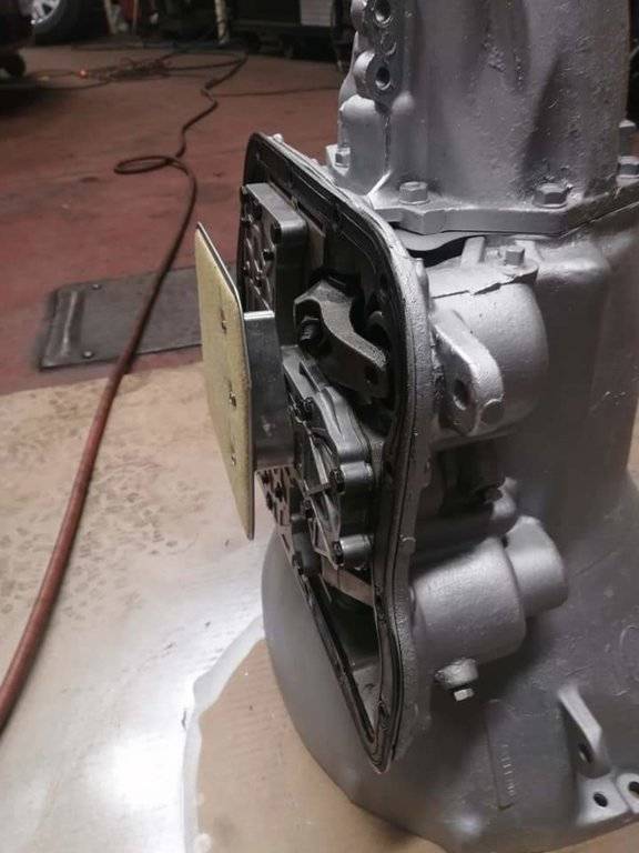

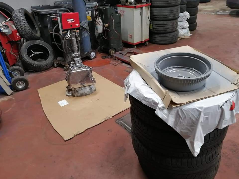

Picked away at the trans yesterday, new mount, coat of paint, new Reverse neutral switch, checked to make sure no crap got in it since it was rebuilt in 2017.
I got my parts guy to find me the switch, he worked for many Chrysler dealers from the time he came to Canada from South Africa in 1972, he was happy to find it for me as it brought back memories.

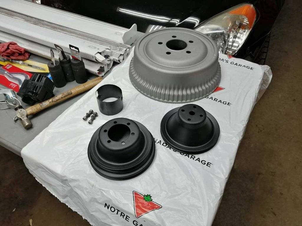

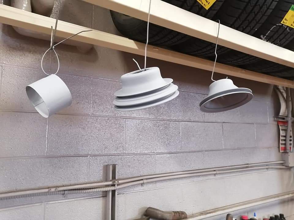

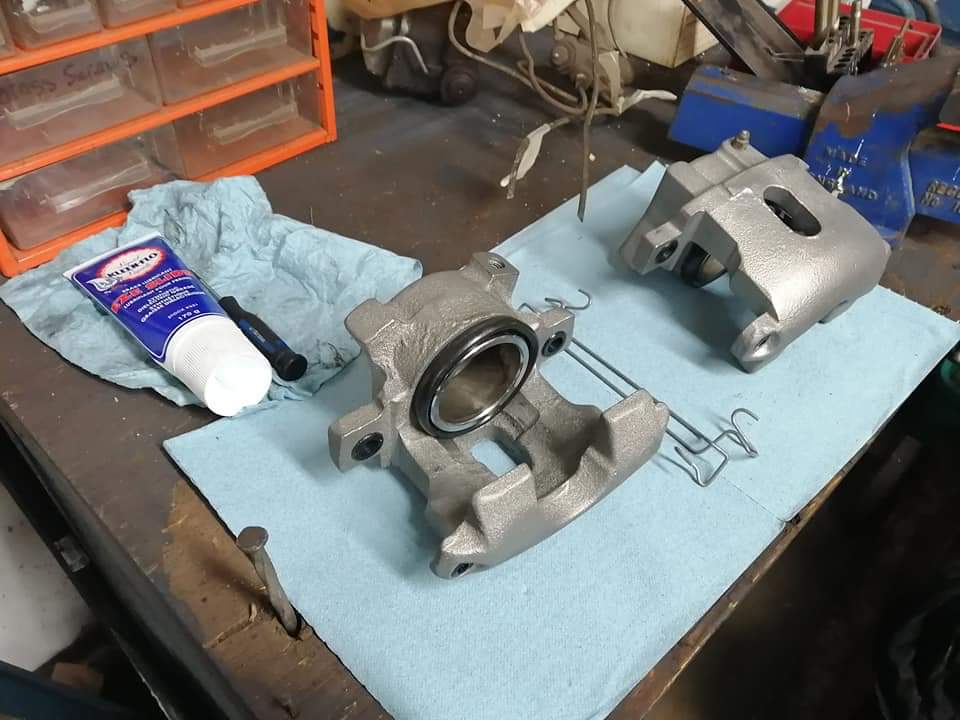

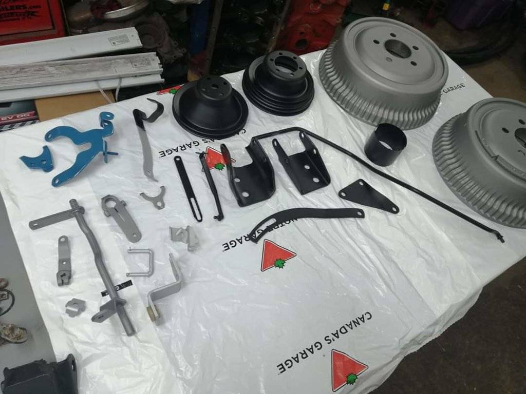

Today was a short day where my off time was scattered as I tried to put some stuff together for customers..... But I did strip and prime a ton of small parts so I can paint them this week...
It's the small stuff that's the killer..

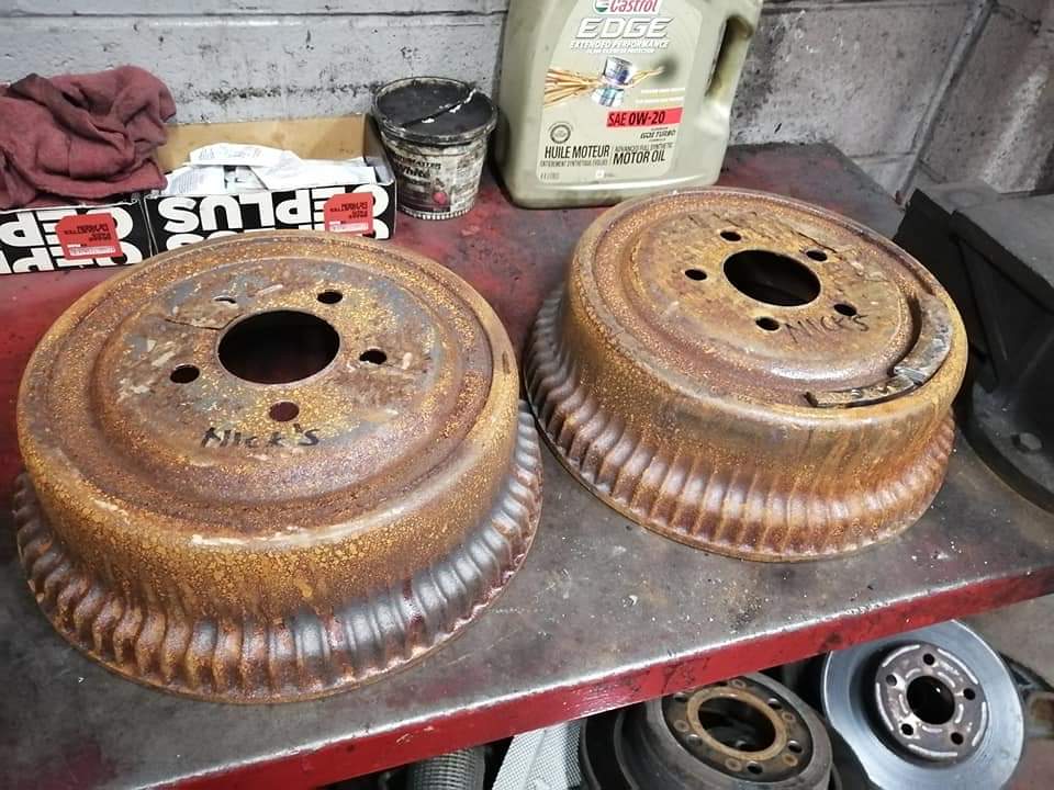

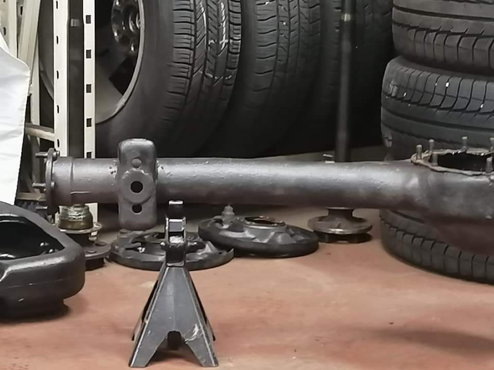

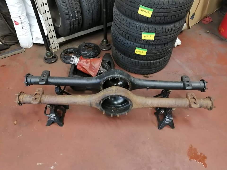

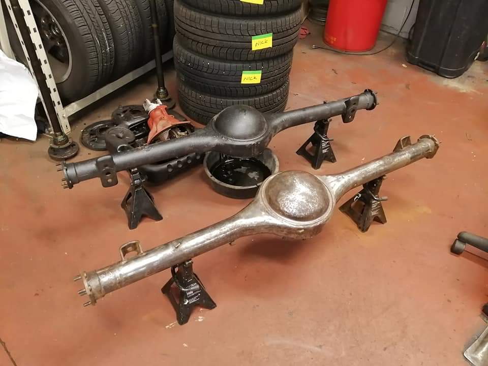

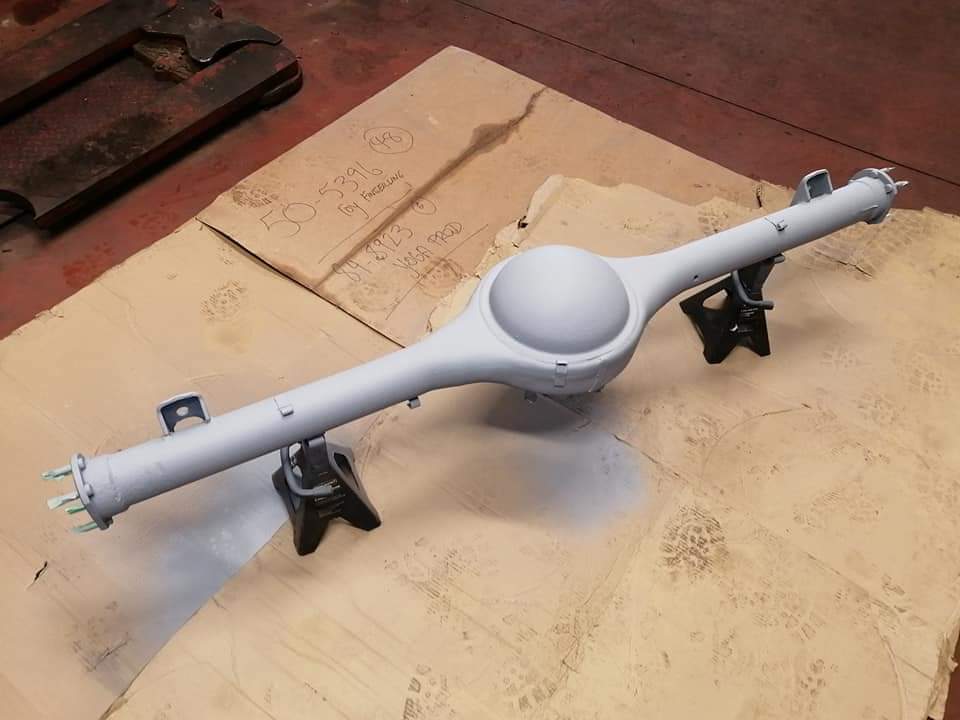

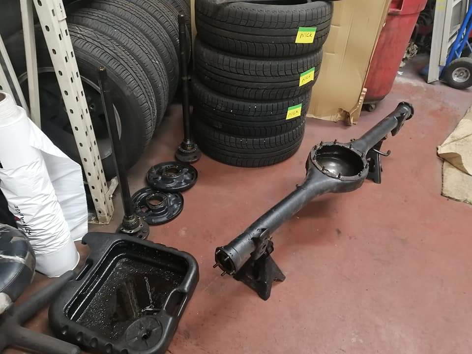

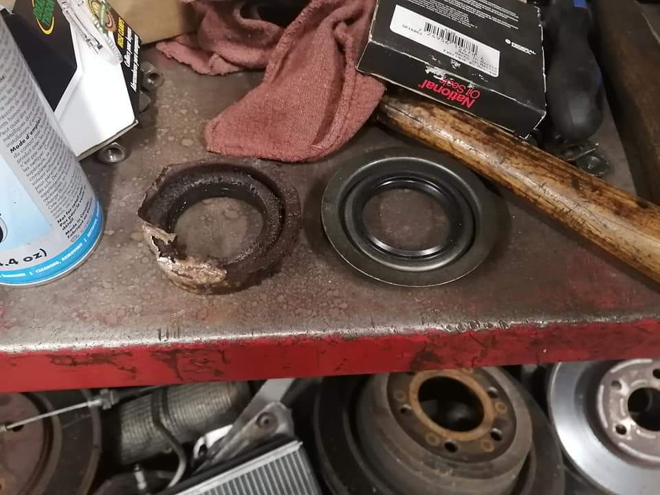

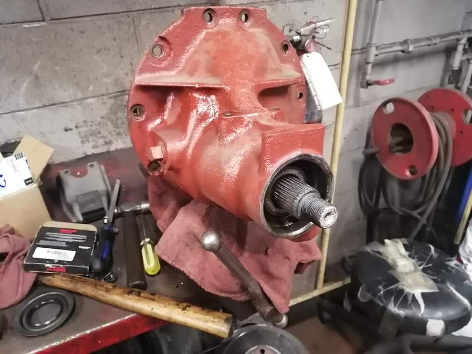

Started tearing down the 8.75 rear end. I started by replacing the pinion seal...

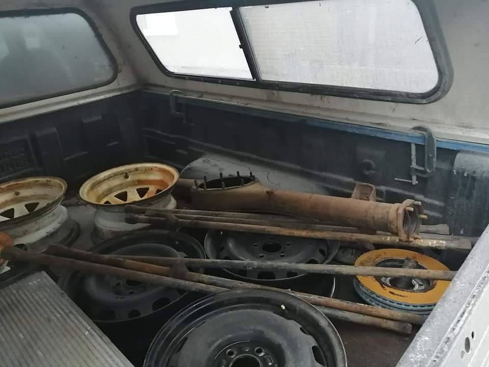

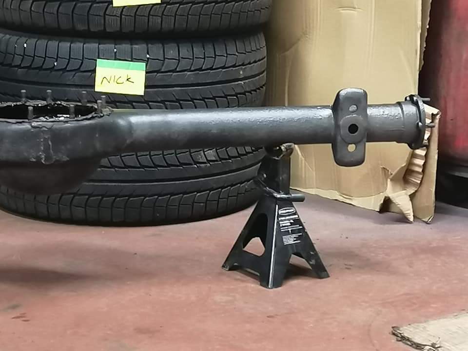

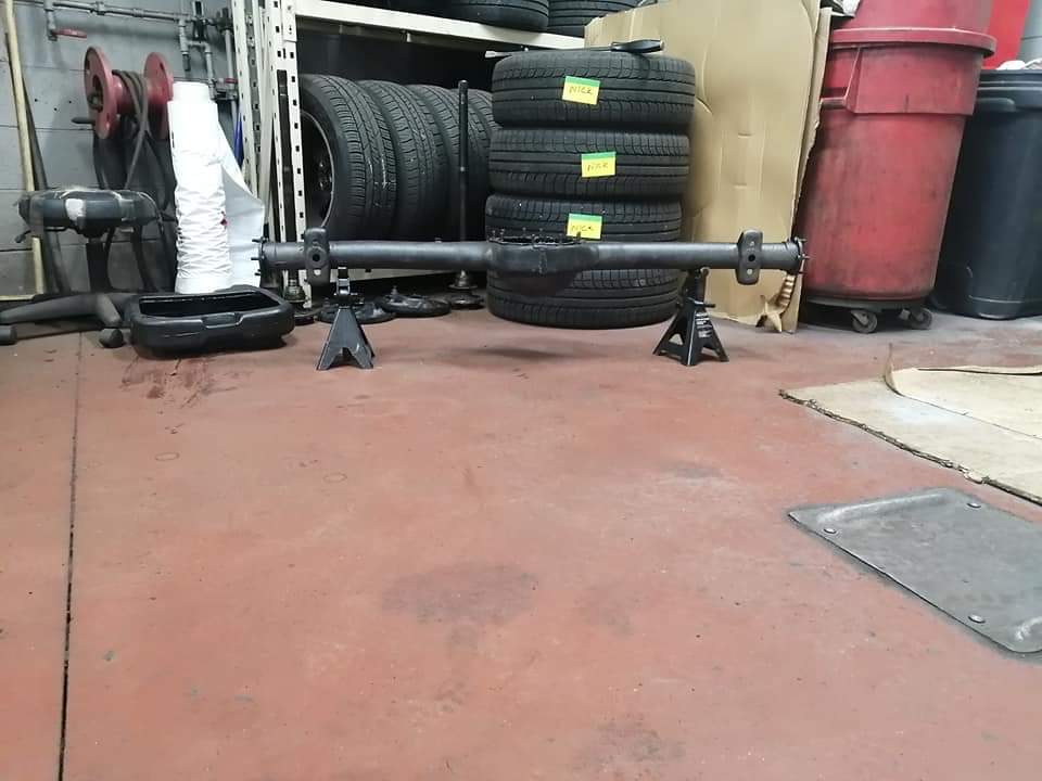

What I noticed while kneeling working on a heater core, was that the right axle tube was bent.... How I never noticed that....

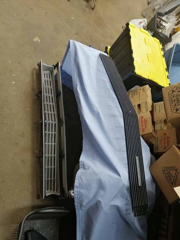

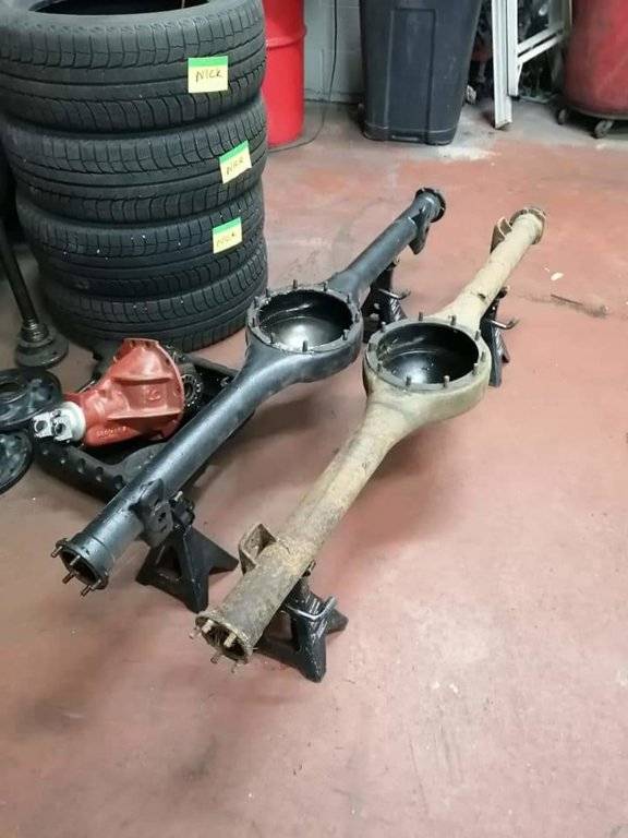

So...... I needed a replacement, today being my day off, I took a ride up to National Moparts to see Nigel. After some digging around the back of the yard I found a 73 Imperial carrier, I measured it and the over all width from flange to flange was correct. I think I may need to move the perches a 1/4" or so, but no biggie. Found a mint 73 grille also..
Nick

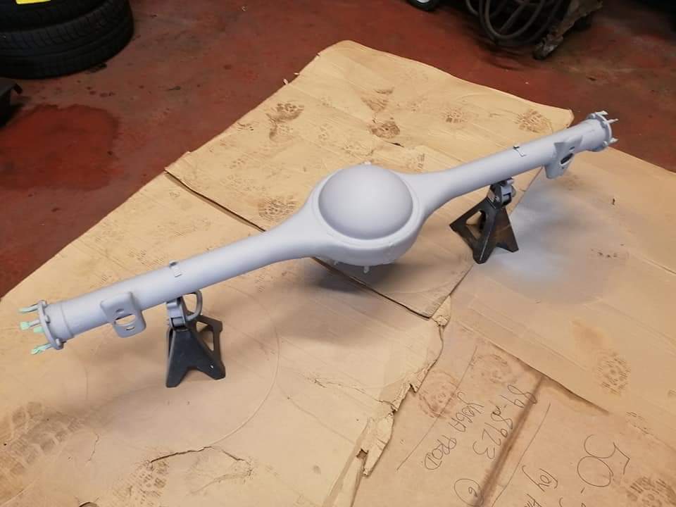

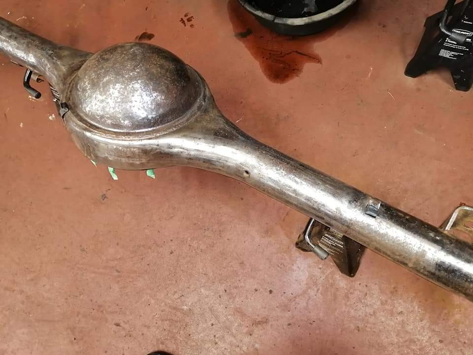

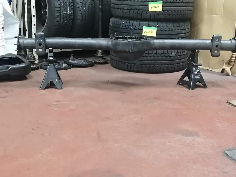

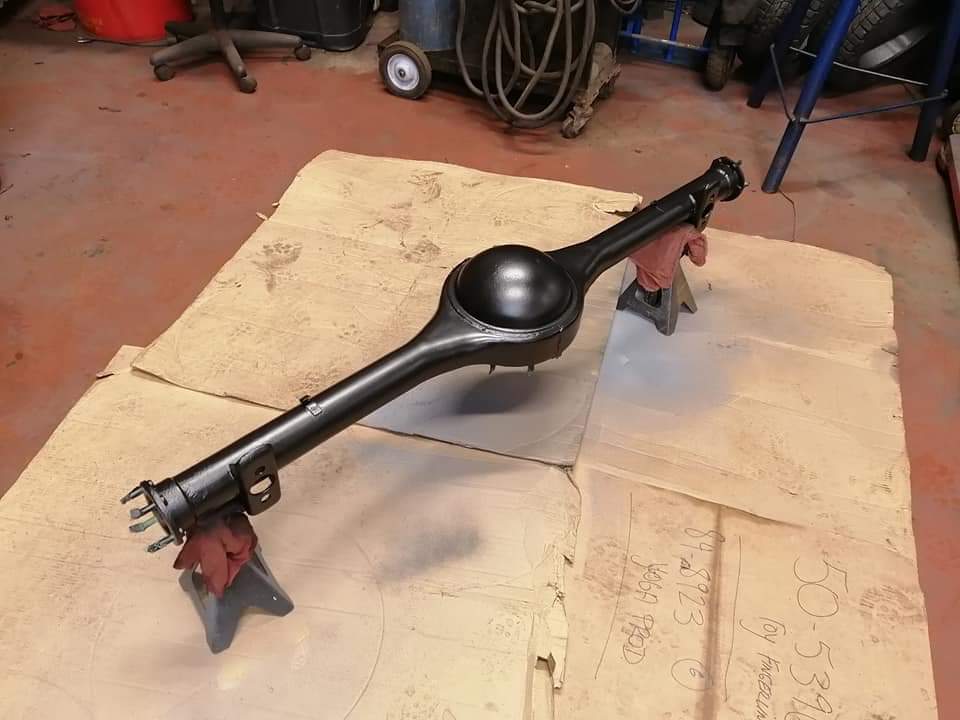

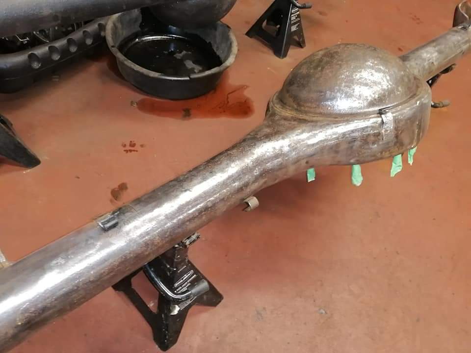

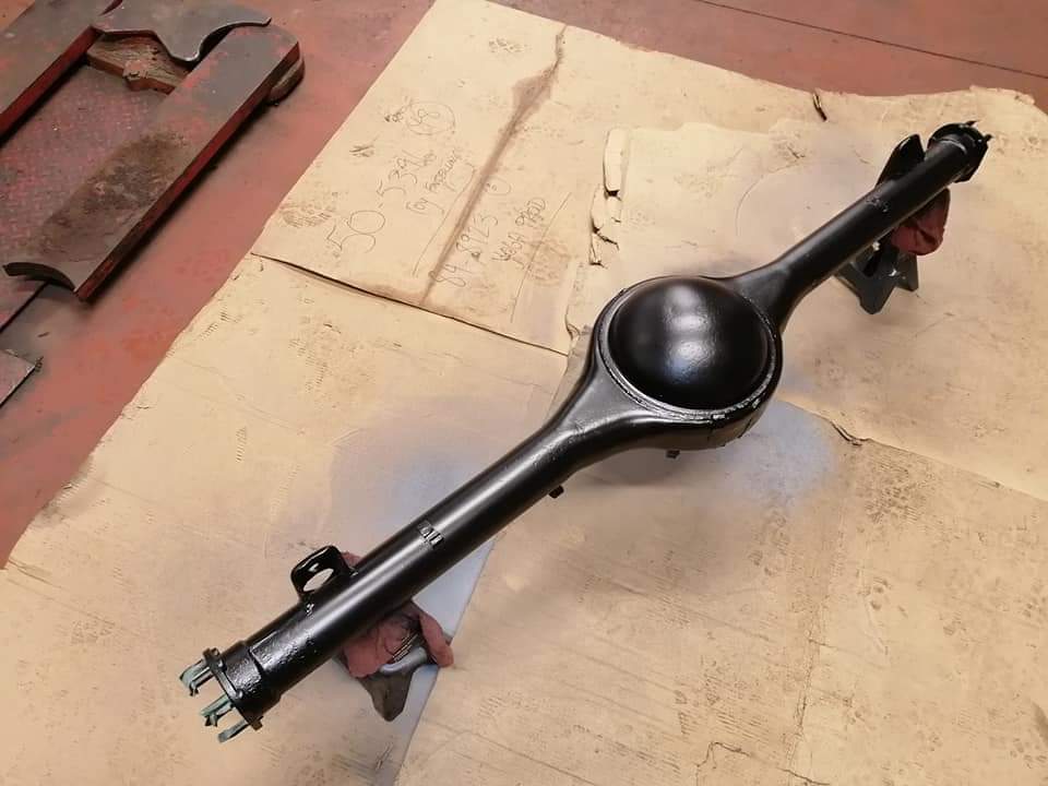

Over the last two days at work I've picked away at the housing. I started by checking the two and found they appear to be the exact same.
I then stripped it to bare metal, cut the brake line retaining clips off the other housing, welded them on this one, epoxied it, and finally gave it a couple coats of 60 degree gloss black....
It will do....
