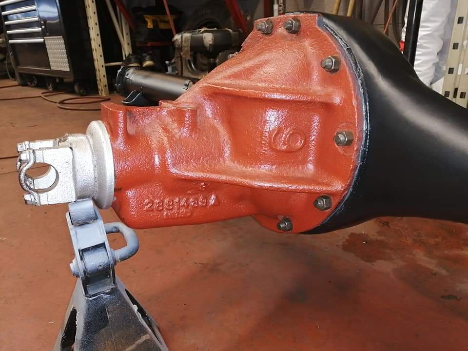

So this morning at work I picked away at what I could do, I rethreaded every stud and nut, and reinstalled the gearset, I'm likely going to refinish the pinion yoke as it just doesn't look good enough to me.

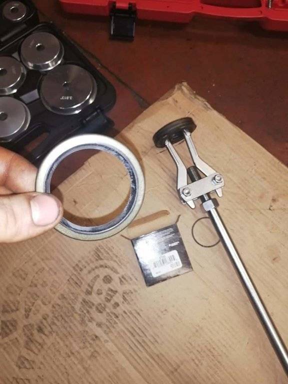

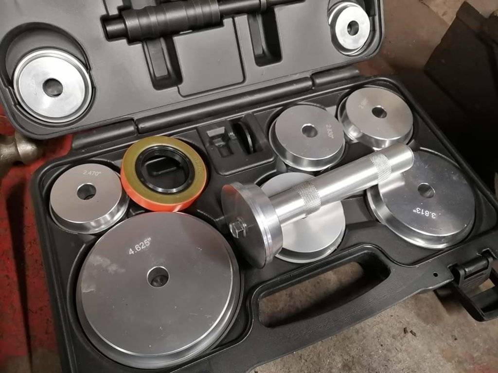

I'll pop the axle seals out the afternoon and pop the new ones in, probably will install the new wheel studs also.

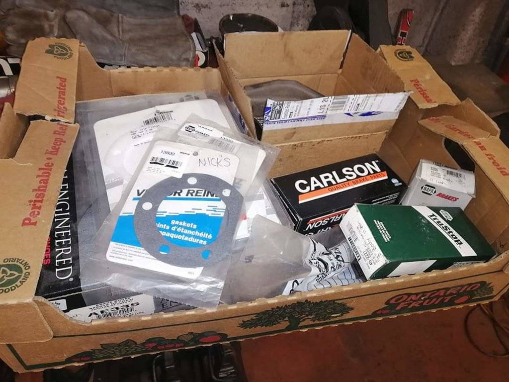

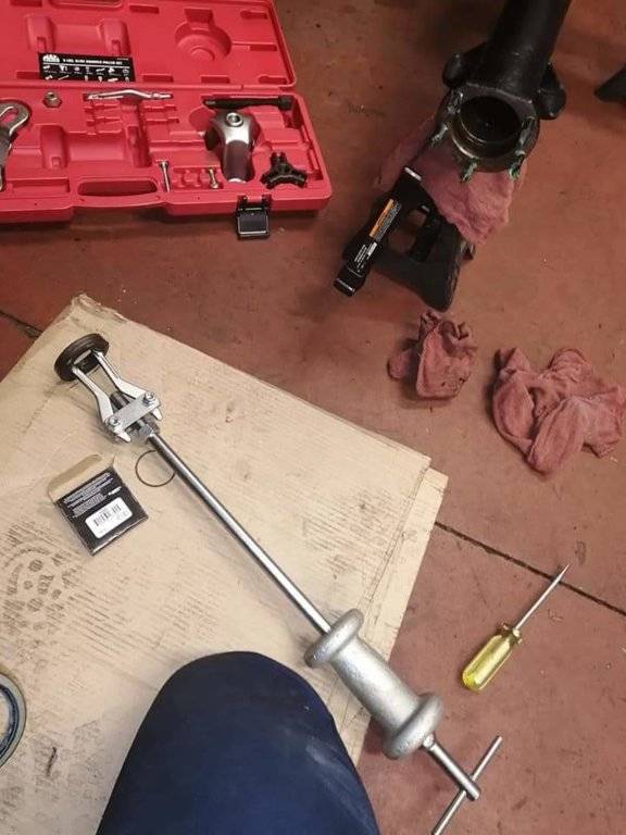

I popped the old axle seals out, only to find that the seals I bought two years ago are outers, not inners.... So I got my Mopar Uncle to track down a set for me.

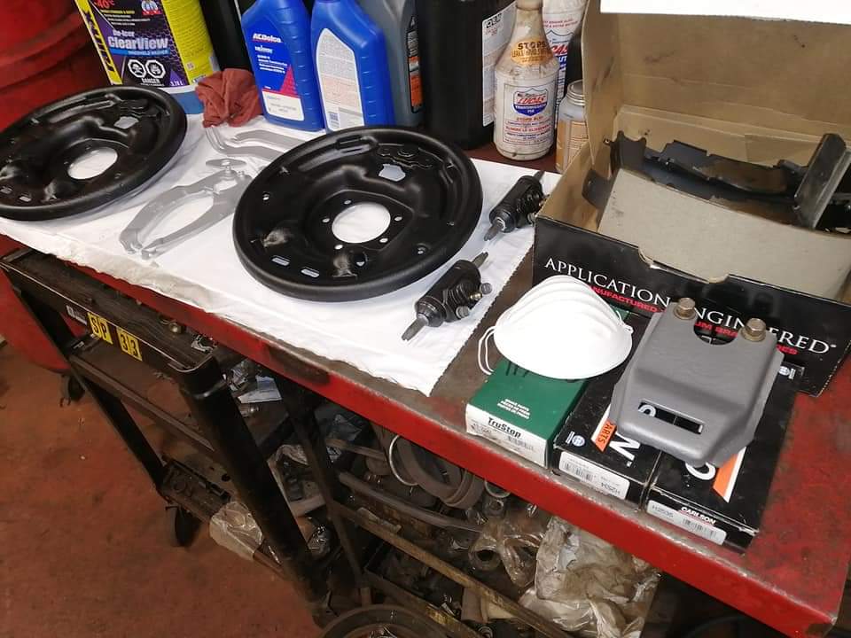

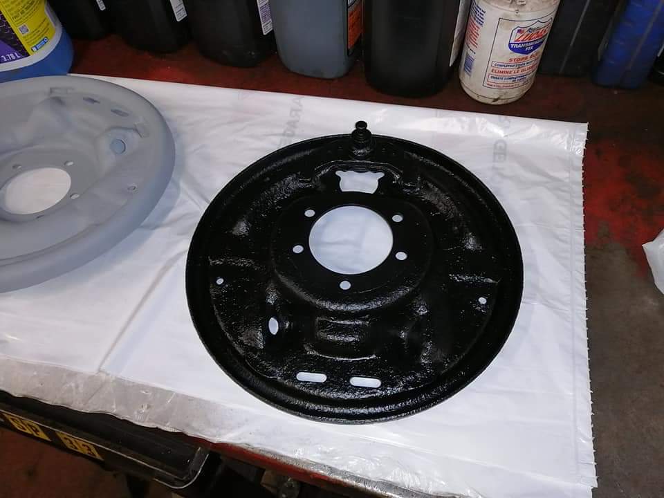

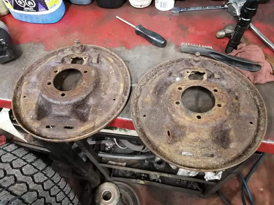

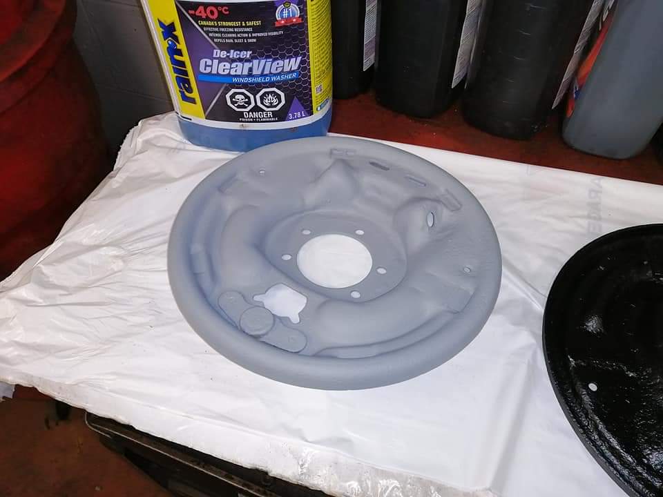

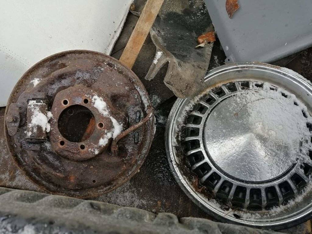

Sunday I took a ride out to my favorite yard and pulled backing plates off a 71 Suburban.

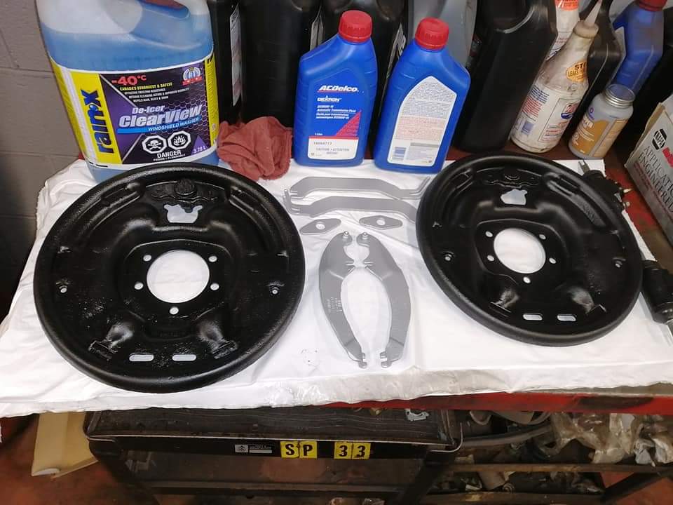

Between jobs, I stripped the backing plates, cleaned them bare and then primed them, painted them...

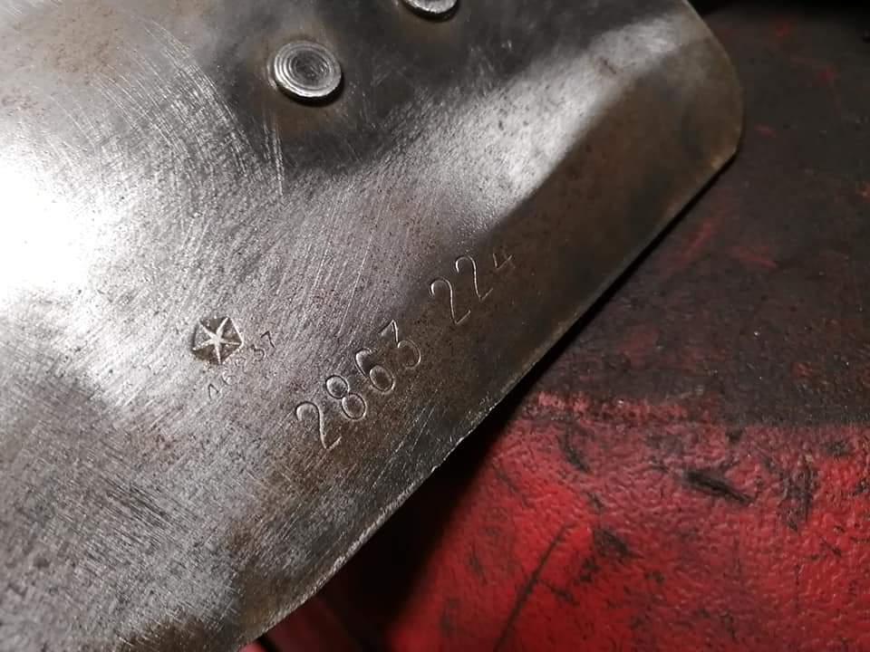

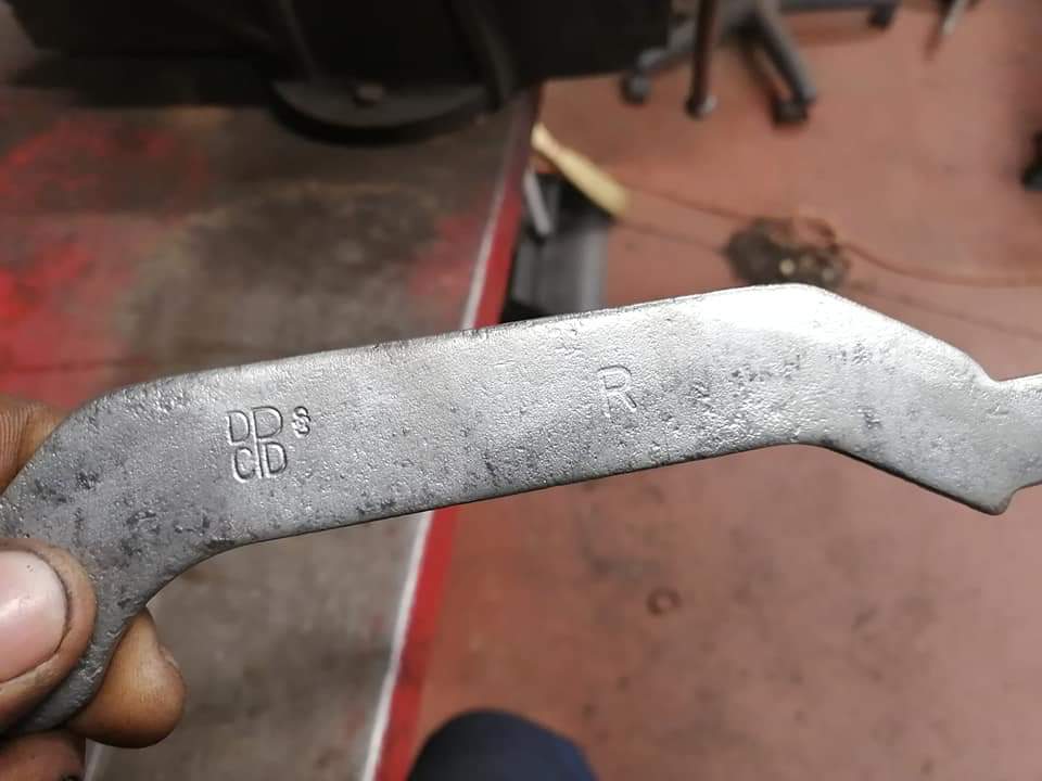

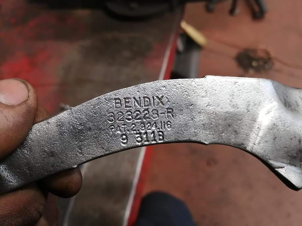

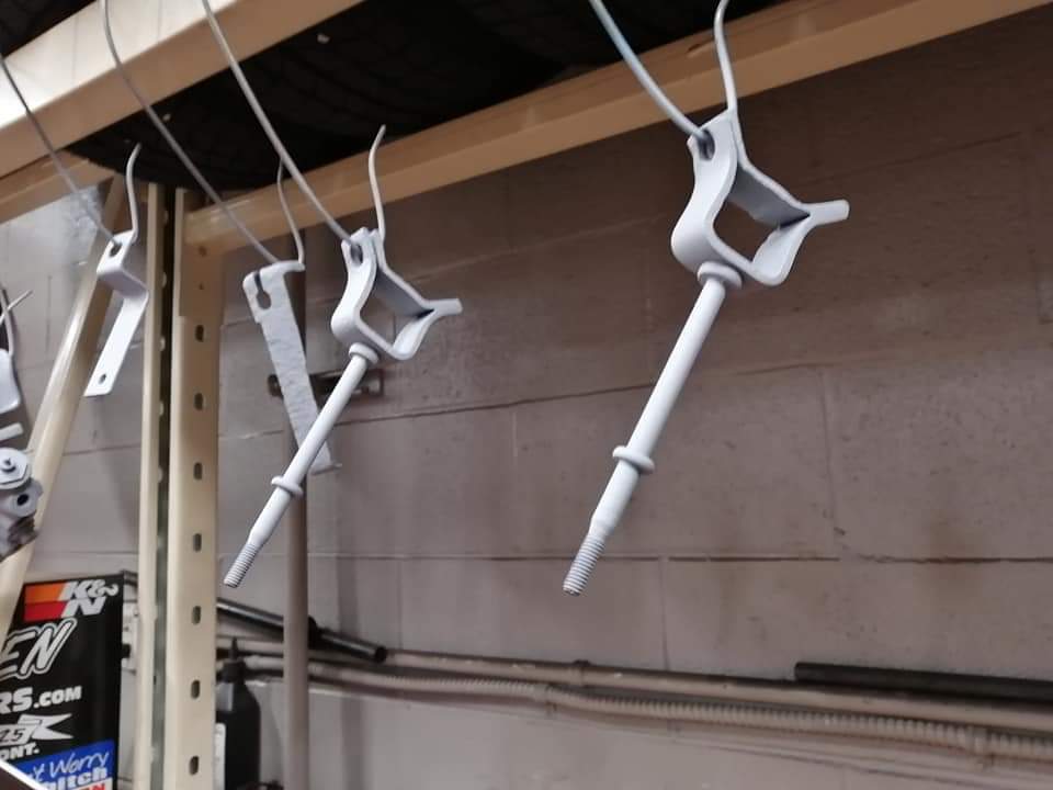

Some neat details..
How I started my day at 6:45 when I got into work.

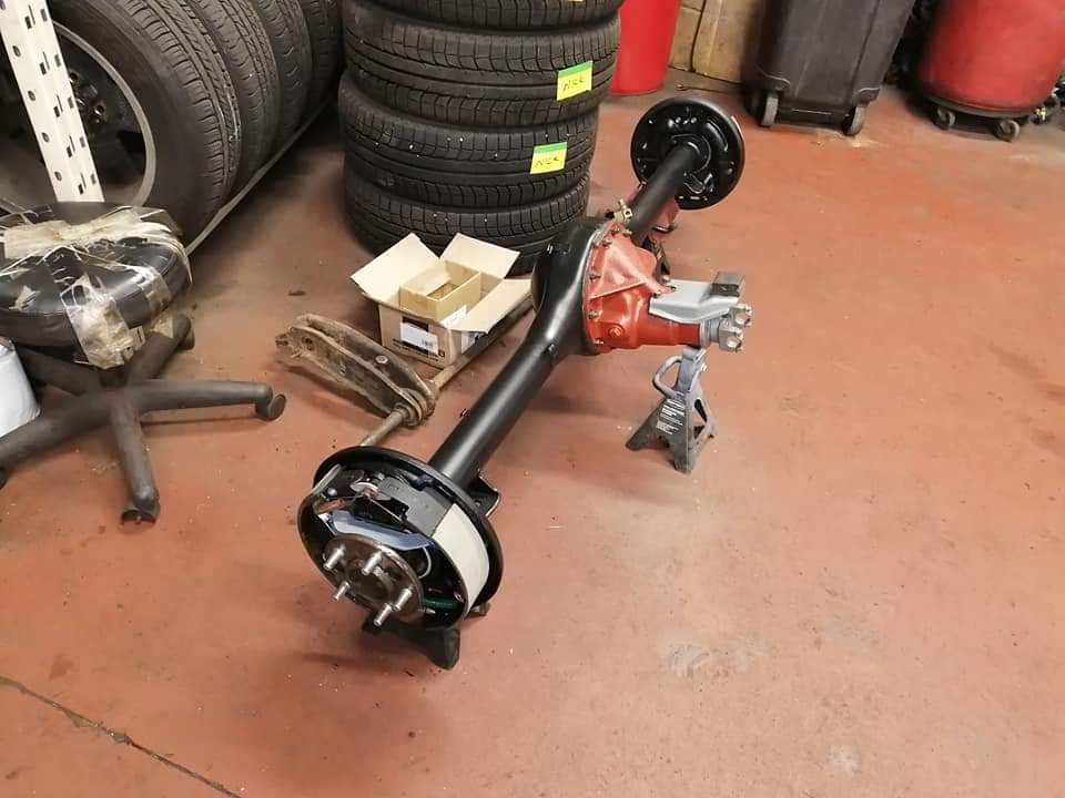

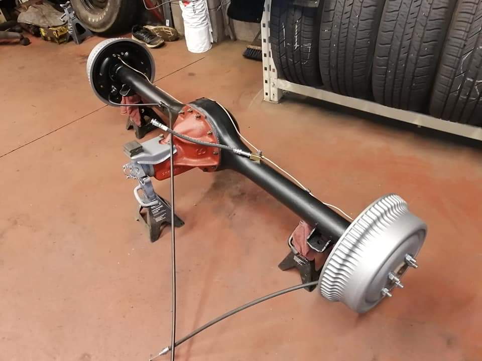

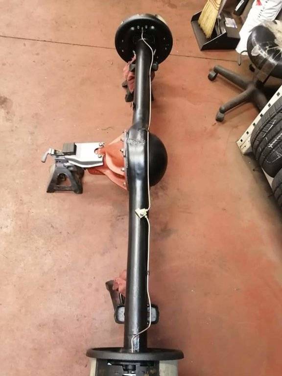

At lunch I managed to assemble both brake assemblies, which are not correct for a A38 or PK packaged car, but with the drums on I'm not worried.

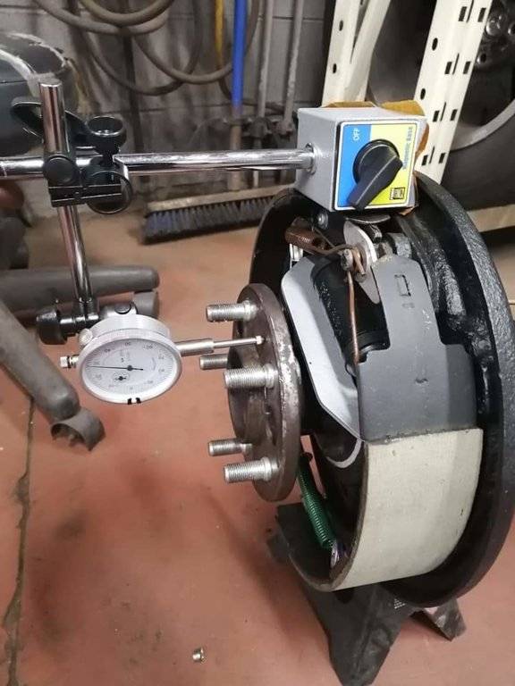

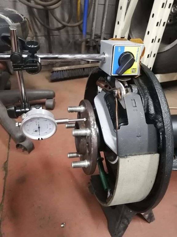

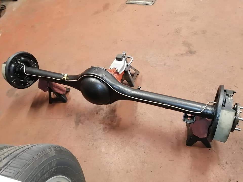

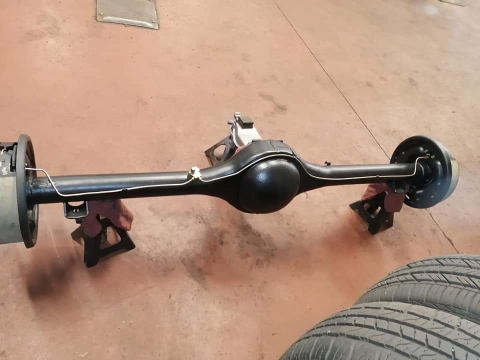

I hung out for a bit after my shift to finish things up, I just need to make up some lines and set the axle end play...
That is looking good. It's amazing what a little work, paint and new parts will do. I like the detail on it
Brake lines are done, left some wiggle room to put the U bolts on... Forgot to bring my dial indicator and stand so the end play adjustment will have to wait till tomorrow..

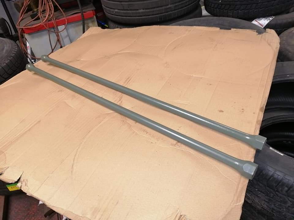

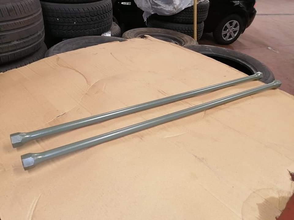

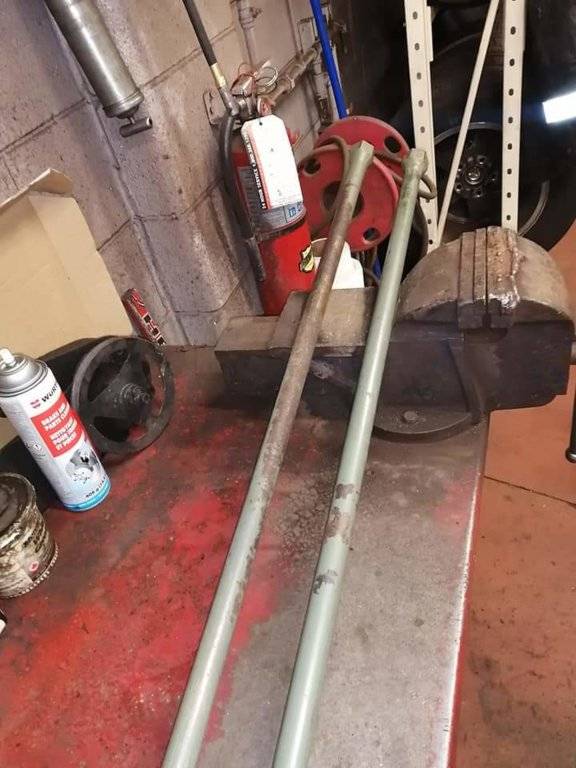

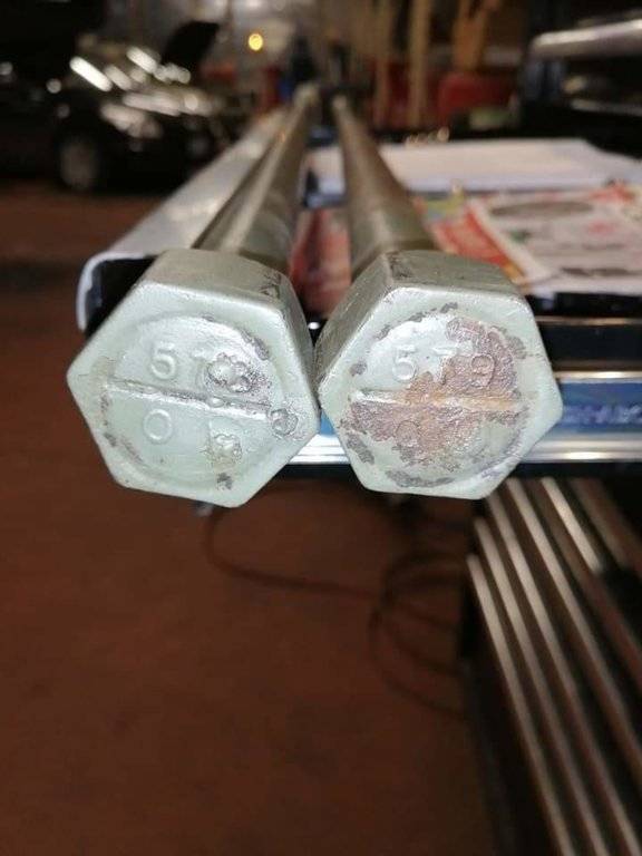

In the process of digging through the garage attic, I came across a set of 578/579 bars, I couldn't place them... So I mic'd the bars on the stub....
. 96
Crap..... Okay, so I put the wrong bars in.

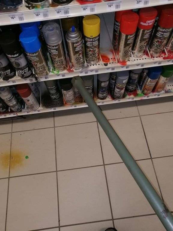

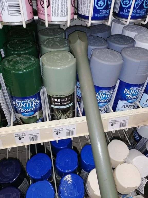

Paint on them is kind of ragged, so that won't do for my car.... Working here has its upsides, I just wander onto the retail floor with my torsion bar in hand... Decided the self etch primer is the closest match, I'll clear it to give the the semi gloss sheen...
So I did that today, they turned out pretty good, it's fairly close of a match..

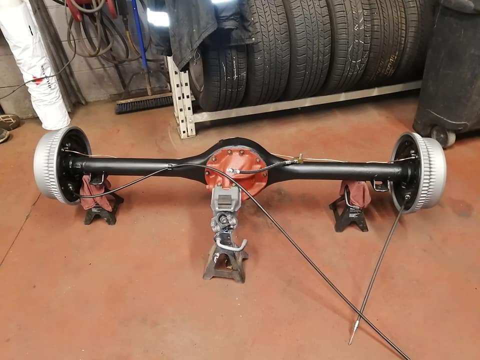

I also had time and Got the park brake cables on and put the drums on, all new studs and nuts of course.... I popped for the chrome open lugs just for my own satisfaction
Some neat details..
View attachment 345319 View attachment 345320

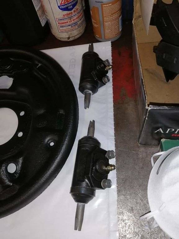

View attachment 345321 View attachment 345322 View attachment 345323

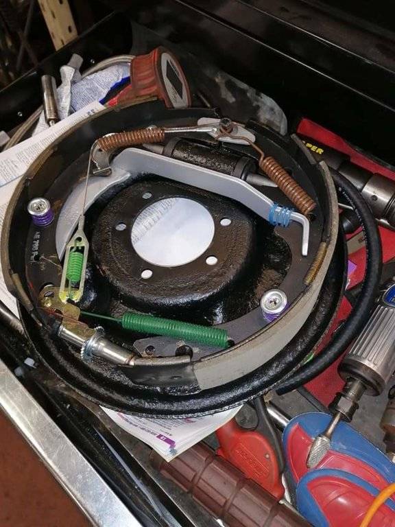

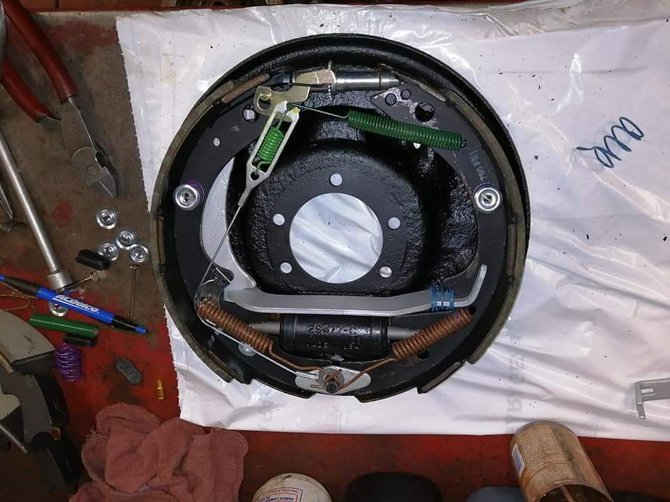

View attachment 345324 View attachment 345325

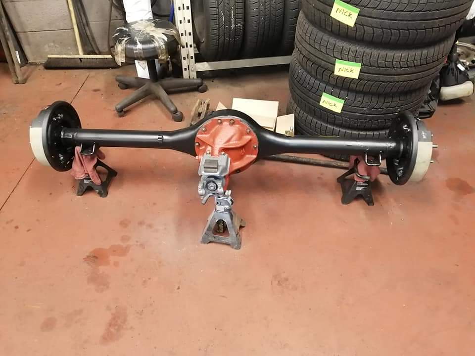

View attachment 345326 View attachment 345327

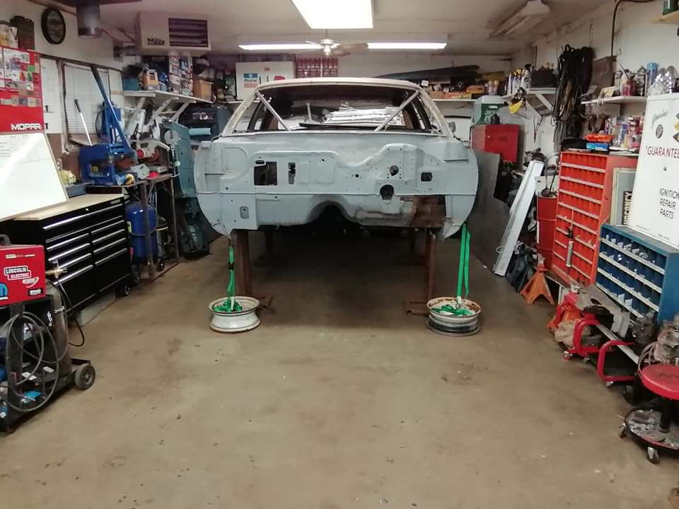

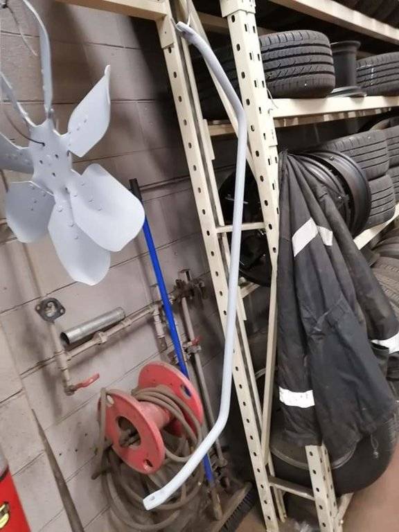

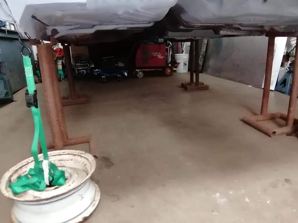

Between yesterday and today, I emptied the garage, emptied the car, matched up my T bars, they are pretty damn close I think.

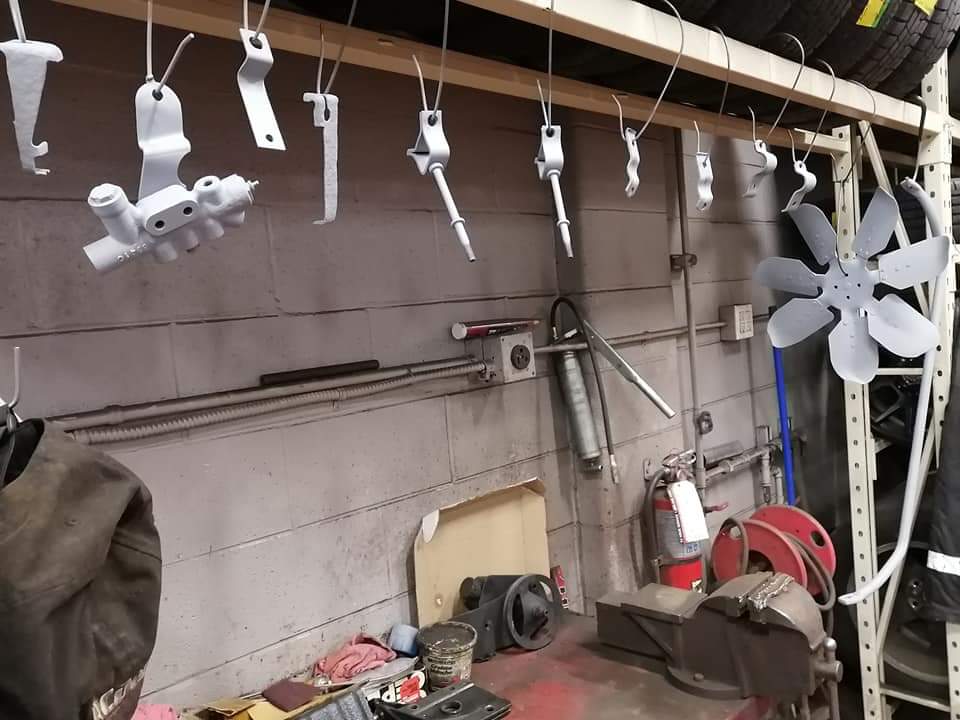

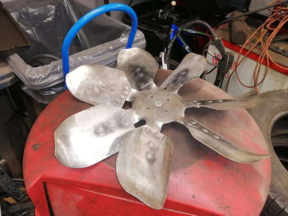

Then this morning it was dead at work, so I stripped the old paint and rust off a bunch of stuff
