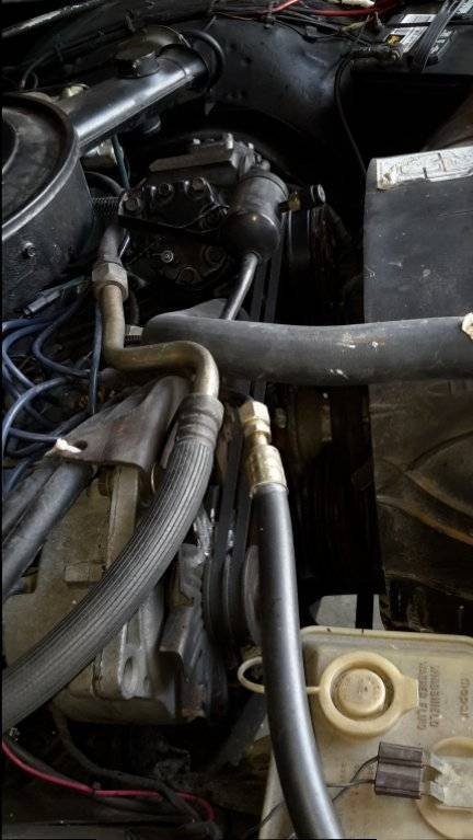

This is the 70 with stock mounts for the alternator and a Bouchillon bracket for the Sanden.

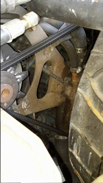

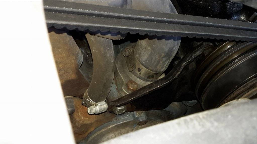

After thinking about it, I think that the big alternator bracket might use one of the mounting points that the new Sanden bracket uses. The one on the far left next to the heater hose connection. I'm going by memory though... and it's been many years since I owned a car with the big alternator.
Alright Stan where is the picture of big alt.?
Be right back...
ok. Here you go.
I think we're good...
I see no reason now why the Sanden conversion shouldn't work with the monster alternator.
Maybe different length belts but that's it?
I studied the pics and I can't see any reason it won't work.
