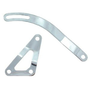

Cheap Evilbay small block bracket. The slotted part might be perfect.

I do believe you'll need to use the older-style lower bracket, although I believe it doesn't have quite enough curvature to it, at least not enough to put the alt where I want it, it interferes with some of the casting of the alt. Although proper location vs the pulley might solve this?

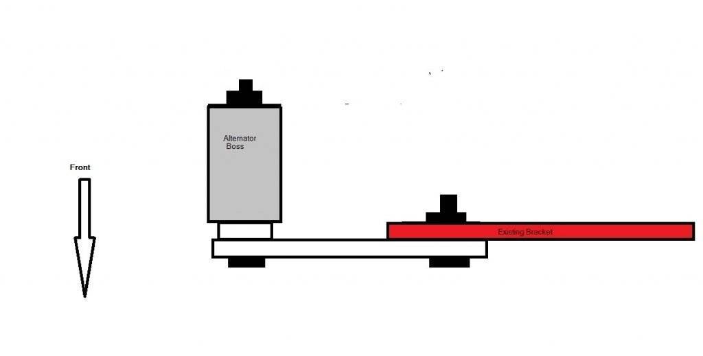

So..... I have a couple ideas. One is to make an extension to the alternator.
Top view would look something like this:

Agreed on the bracket you have being more rigid, although adding onto the alternator via a bolted joint might reduce that somewhat. Probably would work OK though if you do it right.
