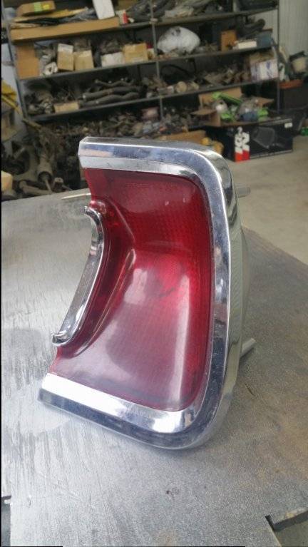

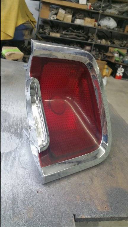

The part i am going to repair here is reproduced however these taillight housings go as repops for $399 a pair. Now for the guy thats bucks down the method i have works, and will cost you way more time than money. If you got the time, and not the money then this is a way to go. Also if your part is not reproduced and is either slightly dented or severely pitted but can be filled and shaped it can be fixed.

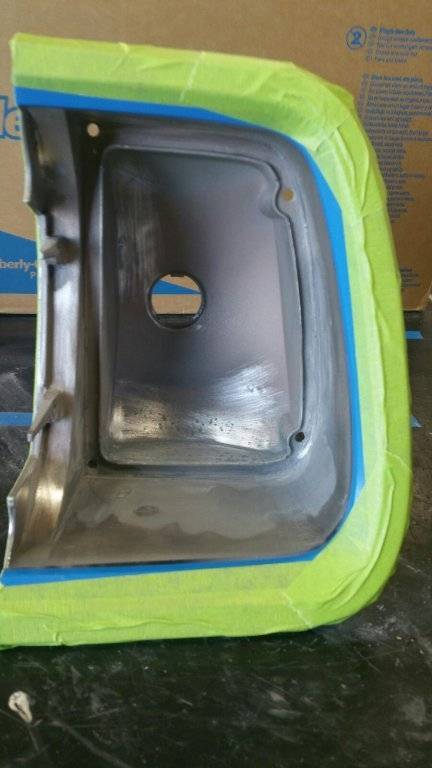

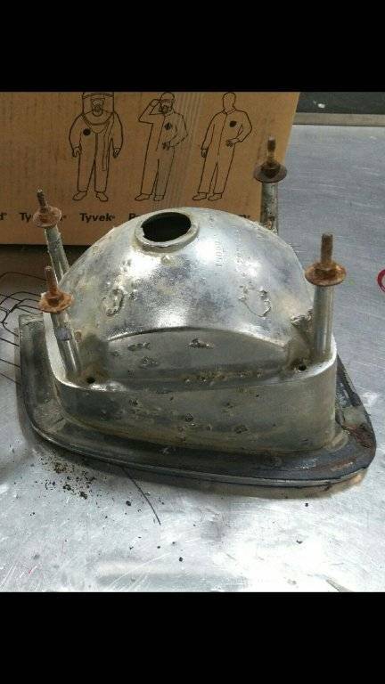

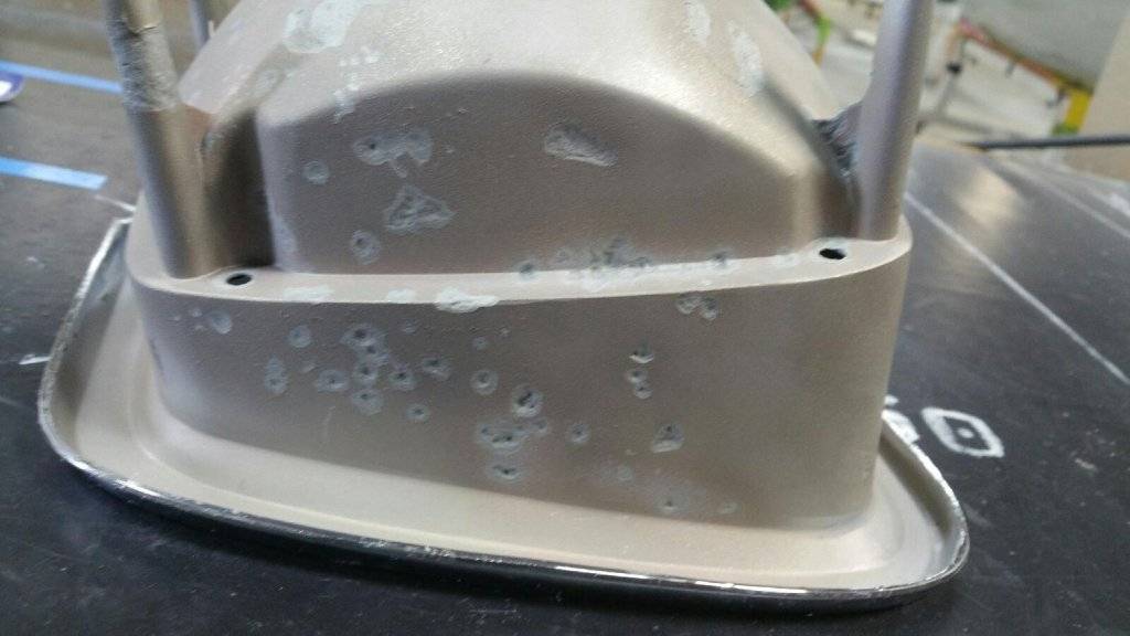

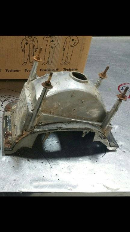

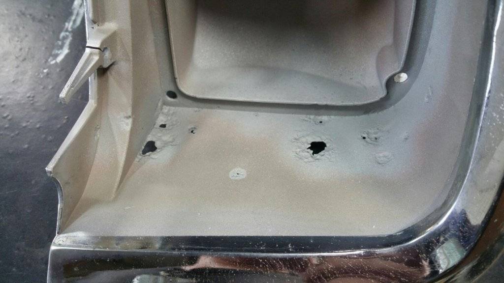

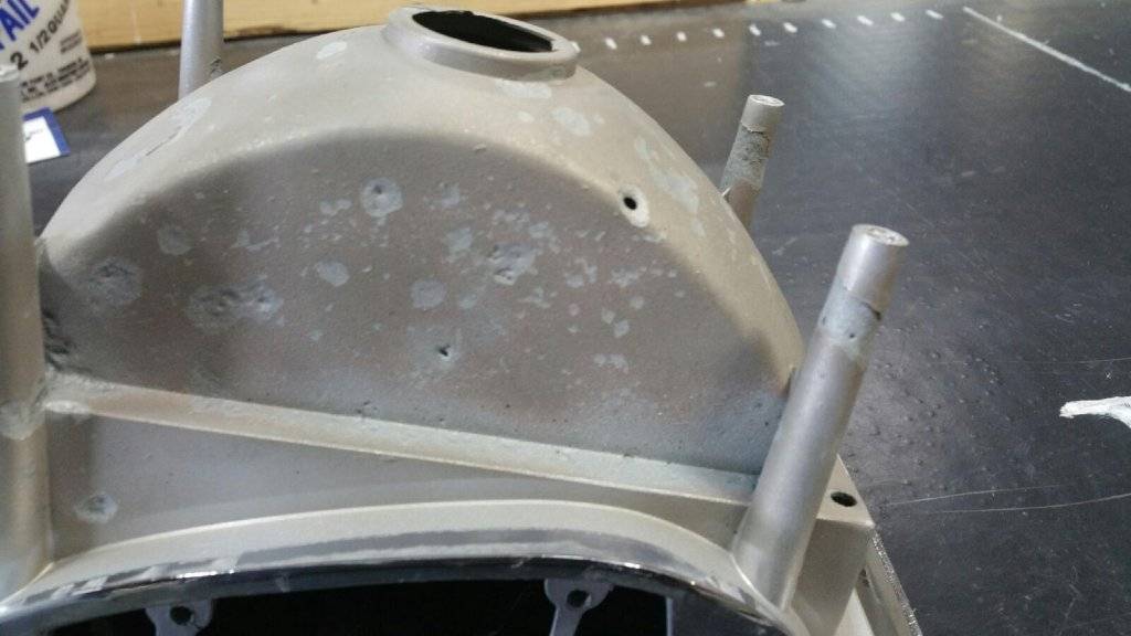

The taillight housing i am using has slight pitting, and typical wear and dull spots on the chrome. I taped off the chrome with aluminum tape prior to a dunk in the blast cabinet to remove all the corrosion from the pitting, as i didnt want to get it spectrachromed just yet, and just wanted to leave it alone and fix the severe pitting. As you can see i have holes where there shouldent be any. Anybody in their right mind would look for better or just buy new, but i am not in my right mind, and cannot seem to find decent used housings. They are either cracked, or bent, or corroded. The good thing is the corroded housings did come with a bonus, perfect crack free lenses.

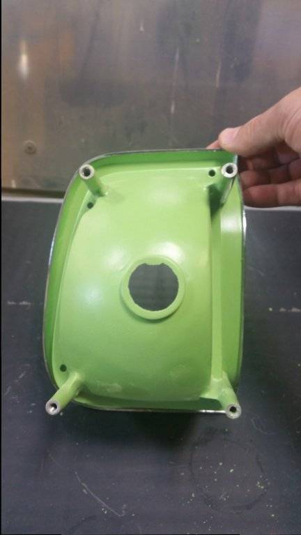

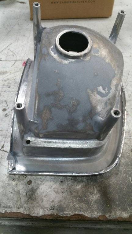

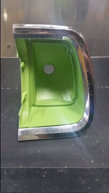

With the part stripped clean and the corrosion blasted off to clean metal, its time to mix up some JB weld, fill in the defects, sand smooth and apply some epoxy primer

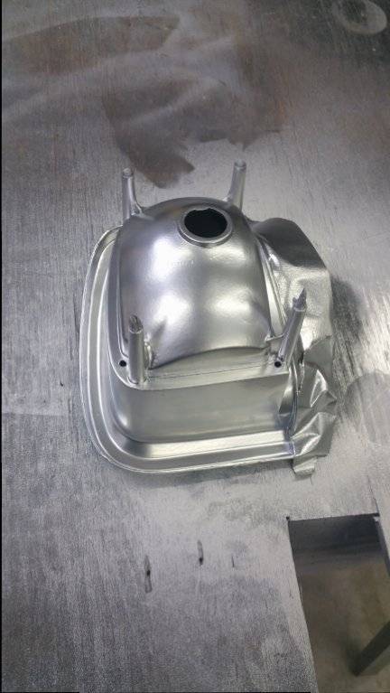

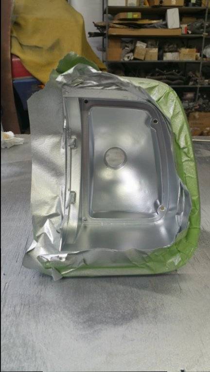

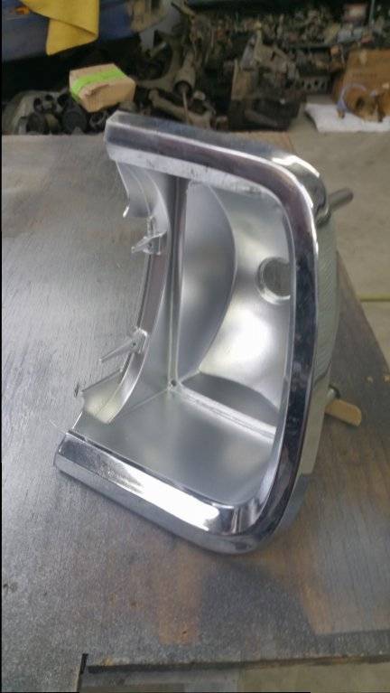

Last but not least i taped off the chrome and applied krylon bright aluminum over the primer, and when dry, i reassembled w new gaskets. Had i sent this part out for silver nitrate plating i would have reworked the chrome areas and epoxy primered these as well, then not bothered with the krylon silver. Now its useable until i either find better ones or decide to pony up the $$$s for new ones.
That really looks good.

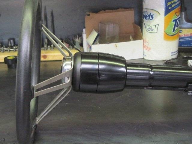

During my resto, I converted the manual 3 speed column shift to floor shift also using JB weld. I whacked off the shifter arm nub on the shift collar with a cutoff wheel, cleaned out the grease inside, and ground the diecast slightly concave. Then i took a rotary file and roughened up the hole, then temporarily put aluminum tape on the inside the collar to hold the JB weld in place after i packed it into the hole till it dried. Then i sanded it down and applied a skim coat of evercoat polyester pinhole filler, primer and paint. Results are below.
JB Weld is pretty good stuff.
