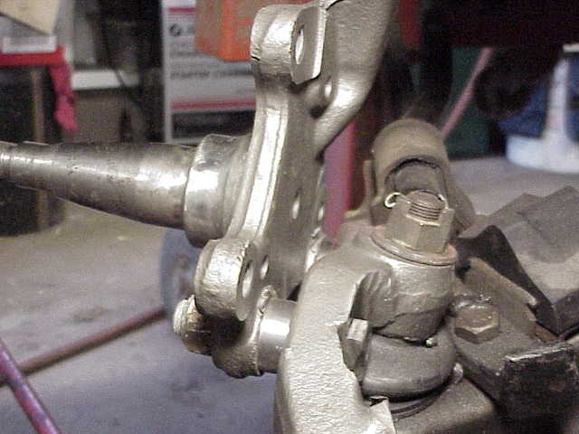

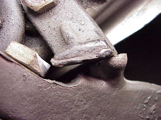

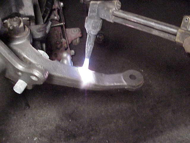

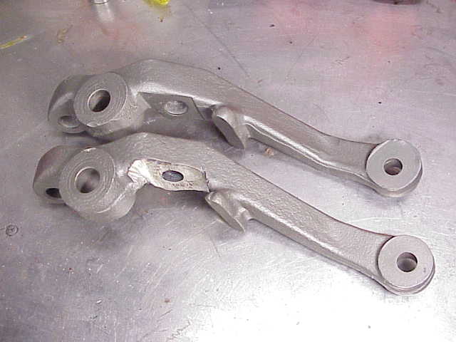

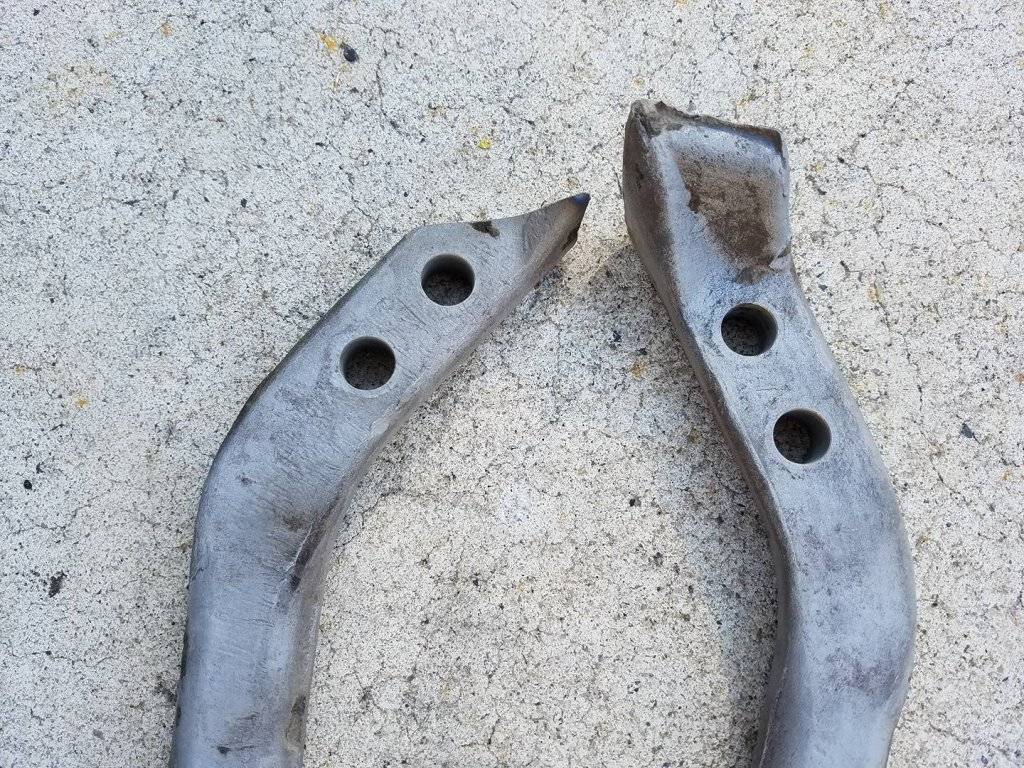

going to use 75 chrysler imp 4 wheel disc brakes and booster setup on my 64 300c , spindles out on the front and convert the rear axles for one piece axles and then install the rears from that imp 9 1/4 re . here is some mods to get the front setup on the suspension and steering .
it's just nice to have factory stuff instead of a frankinsten . but i build frankies all the time , just keep a list of what parts you used and what you modified .
