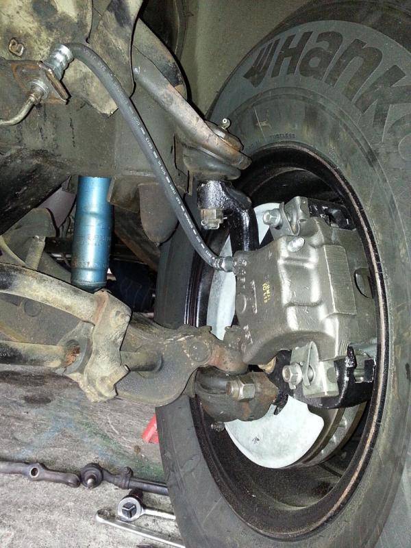

Current hose kinda tight (but it's pictured at full lock) -

On my instructions it says to use the Caddy Eldorado hose from 79 85 so I guess that means they already tested it and proved it works it says its 17 inches long The calipers I am using off of Dodge Ram use the bajo type fitting they gave me 2 banjo bolts.
View attachment 53654[/QUOTE]I don't know if you have the hose mounted correctly it seems like the rubber hose should be on the bottom and the steel line on top it looks like it is strained.
